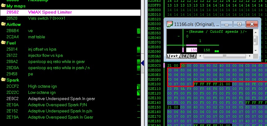

So I've been working on a defining a LNF cobalt med9.6 file. Funny enough gm saab and opal variants all use the med9.6 ecus. Unfortunately I can only find the damos for the 2.8t saab, and they are a bit different so finding maps is a bit challenging with what I have so far however I am making headway and I do plan on posting the map pack when Im done and have confirmed everything. Someone on the trinonctuning forum claims to have the 4 cylinder damos but is acting like a gatekeeper and wont openly share offered to pay too with no reply.
Ill be getting back to defining the p12 file I've been working on later tonight when I have some free time, posting my finding as usual.

Added speed limiter, overspeed and underspeed tables

Lowlyfe1 wrote:Added speed limiter, overspeed and underspeed tables
What sort of matrix style application are you developing in?! :lol:
Great work though!

Looks like WinOLS?

Gatecrasher wrote:Looks like WinOLS?
That it is.
Hopefully tomorrow night I have more time to jump back on the project.
