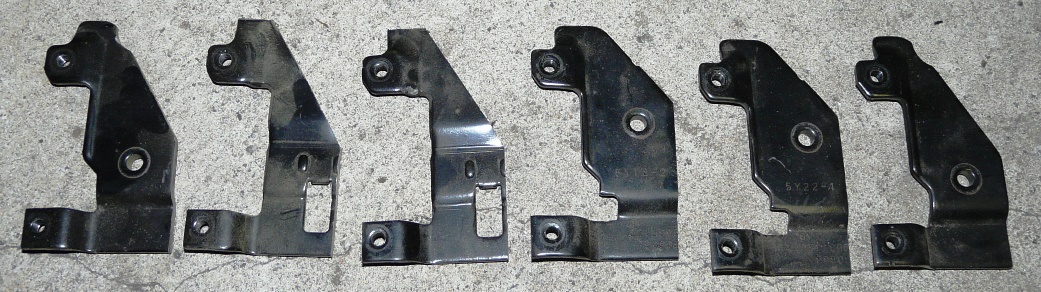

ok so I have finally made some progress on the 6 x LS2 coils, its not a massive update but that's because I have run out of things to do till I can get some steel!
firstly I cut up all the LS2 coil brackets to rid them of the excess bracketness, and I've had a bit of a look and I reckon the plan is to mount them all on some angle iron on a 45 degree angle (so I can easily get at the screws to remove them).
I also got my package of msd leads and the LSx crimp connectors, so once I have the coils mounted i'll be able to work out the lengths then I can terminate all the leads!!
so like I said, not a lot of progress, but progress none the less

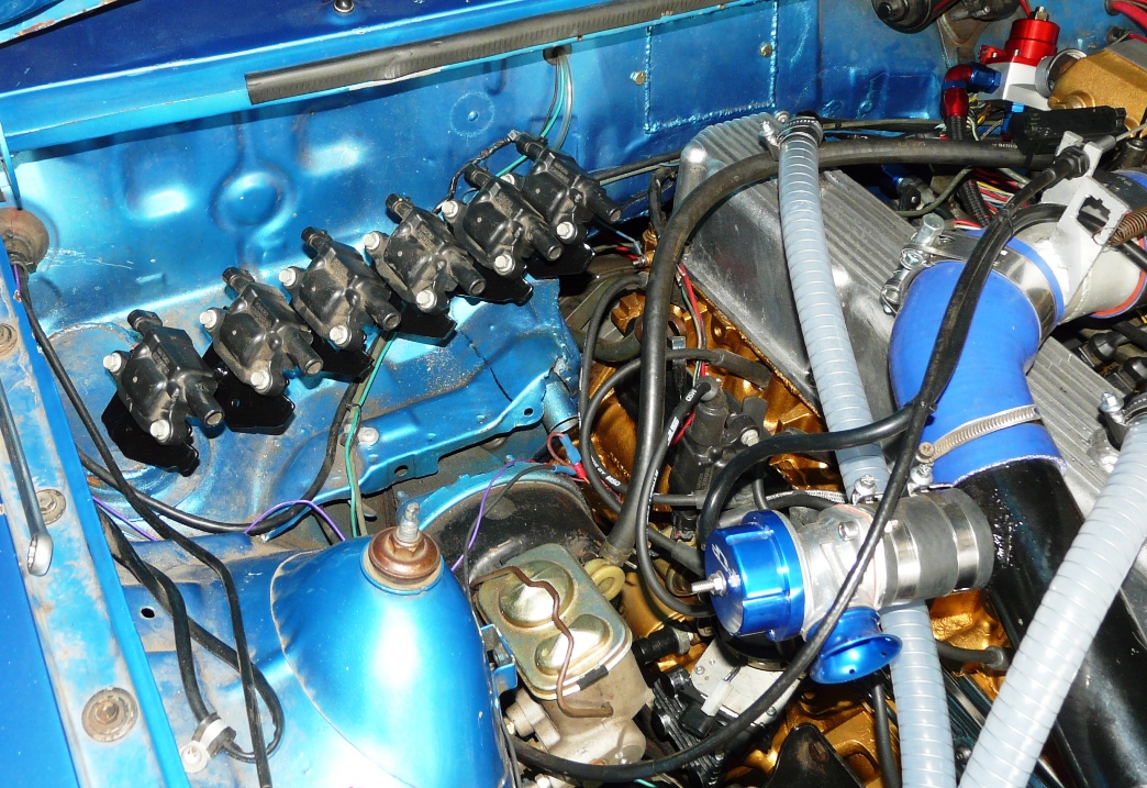

Should be good, where do you plan on mounting them, on top of rocker cover?
Re: My Delcoed Rides

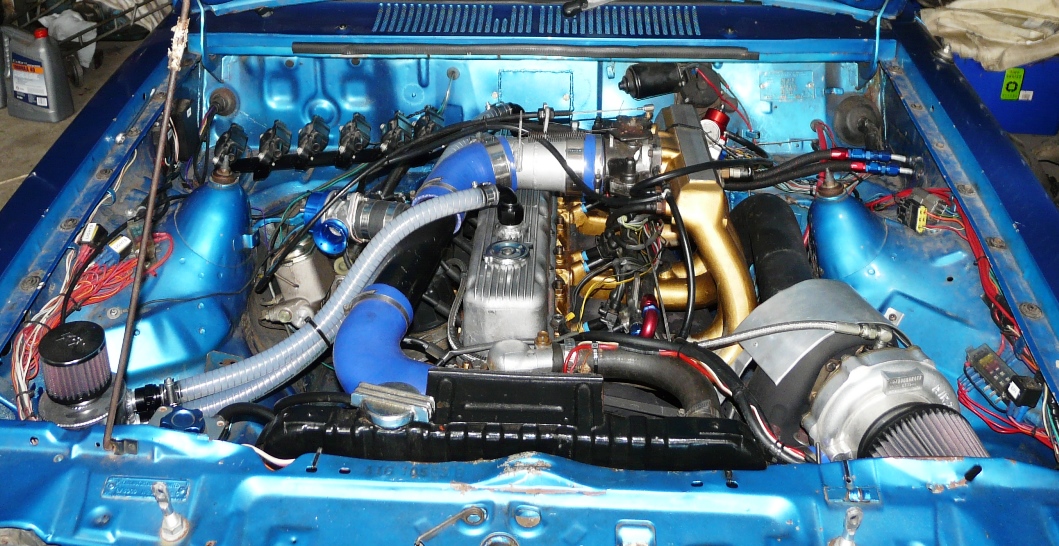

in this picture see the empty space in the top left hand corner of the engine bay, above the brake booster.

that said I did manage to whip this bracket up last night before dinner!
can get the coils off without having to remove any others and they just fit in the area provided!
the big question now is weather the speedway is cancelled in Parramatta due to rain, if it is i'll probably be able to get these working today, otherwise might be sunday!
