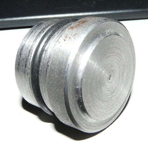

final piece of the puzzle was put in place this arvo. I had planned on a welsh plug but it turns out from the 20 different sizes at my mates workshop not one of them was going to fit, but he does have a lathe and so I got busy making an alternative :)

Very neat! I was wondering what to do there, I was thinking something could be machined up.

Nice work, very tidy

Neat as, good job :thumbup:

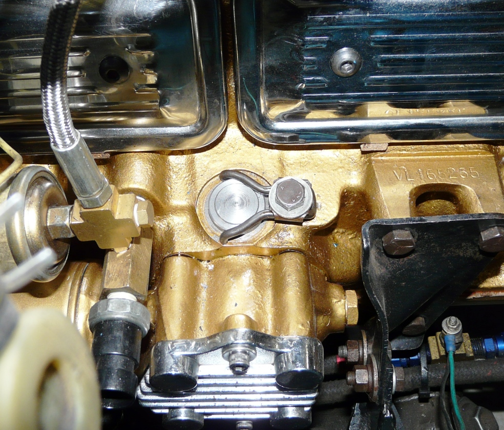

so fitting the rising rate regulator, had to cut the standard end off the fuel rail and weld on a AN fitting, then used a 180 degree bend to send the fuel return back to the rear of the motor to the rising rate reg on the firewall.
also you can see there is a pressure sensor in the reg to allow me to data log what its doing :)
all that's left now is to run 3 wires to the data logger for it and shes good to go!

well for those interested in logging fuel pressure or even oil pressure, this sensor is the go! i have it connected to one of the analog inputs on the datalogger and its working nicely :)
the data logger has 5v output so makes connecting it up all too easy!

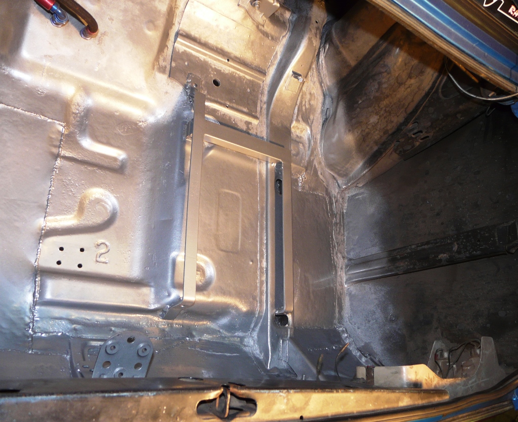

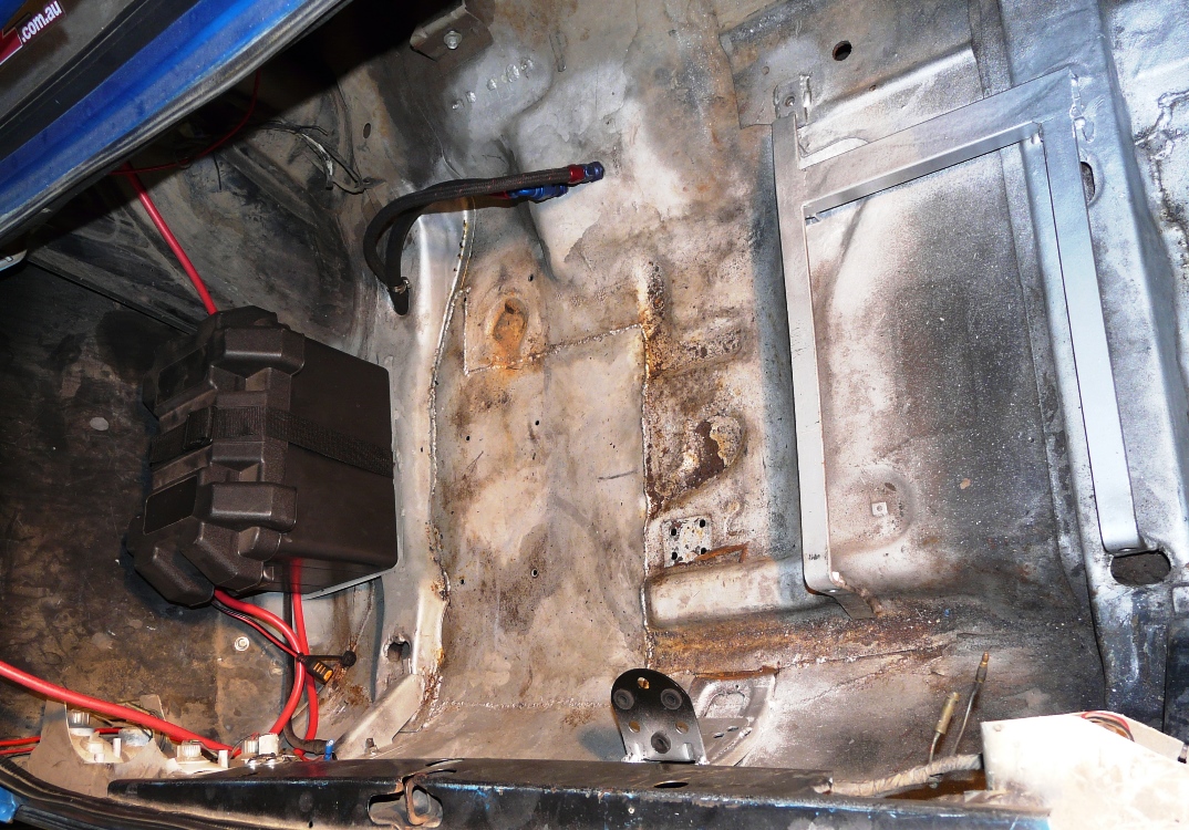

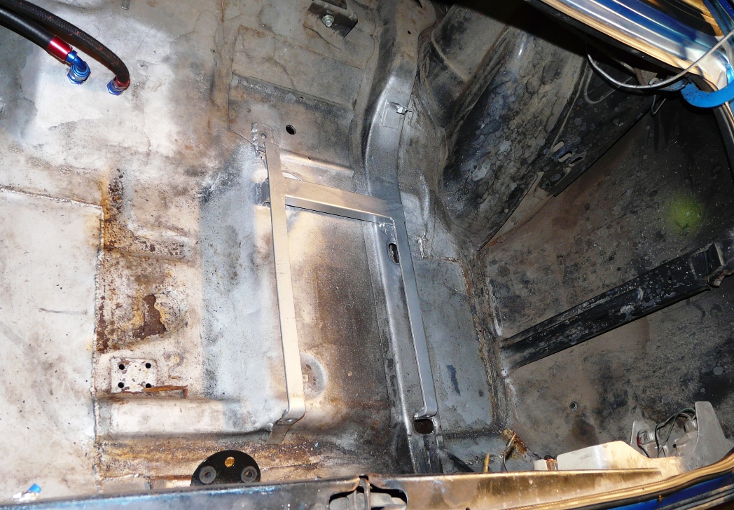

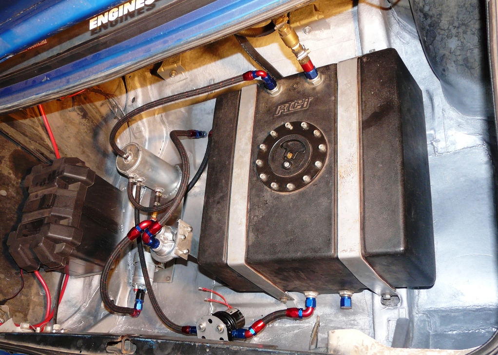

while I had the time I wanted to fix the fuel tank so it sat better to stop the pickup uncovering even when there was 5ltrs of fuel in the tank ... so while I was at it I decided to give the boot and good clean and re-paint all the bits that had some surface rust etc.
from this.
to this.
just waiting for a new fuel filter then she's all done!
