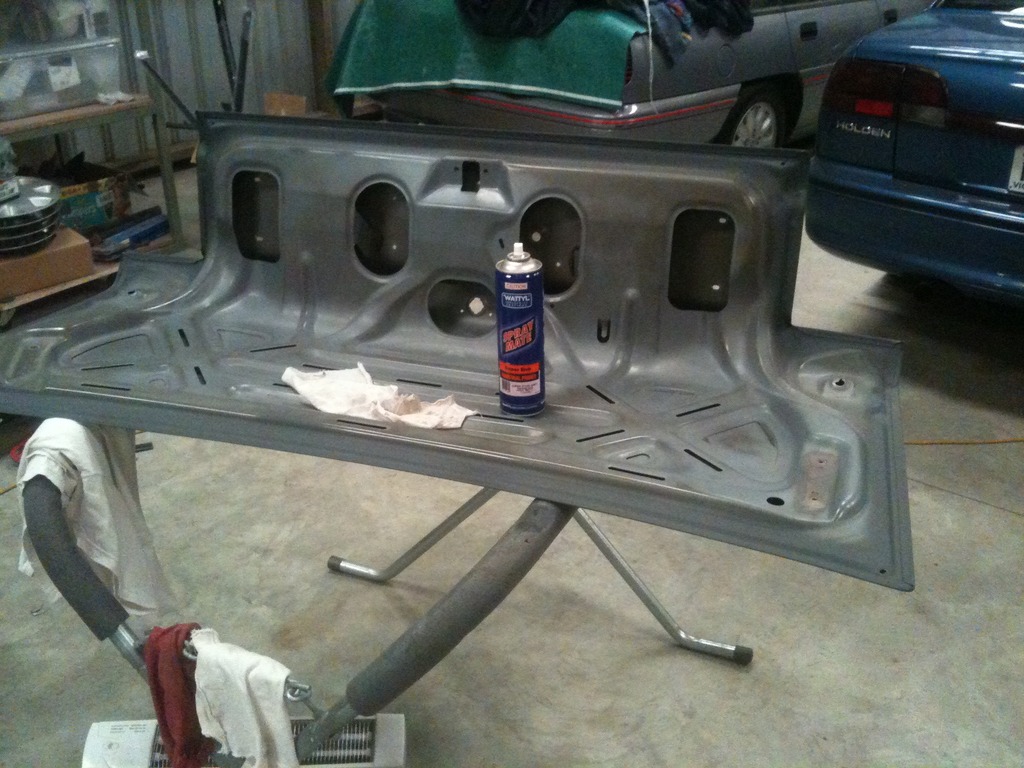

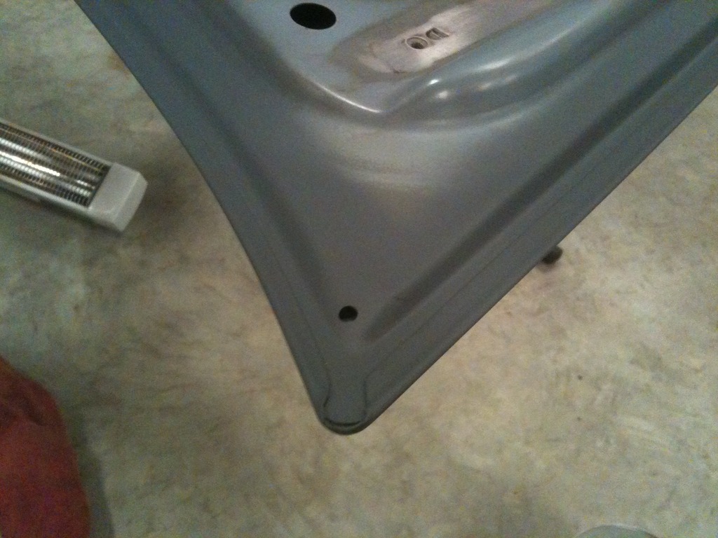

So im preping that old Berlina boot lid I had pretty much done for the long gone VP executive project.
Just gave the lip another sand and primed it ready for a bead of seam sealer, then to give it a fine sand with 600 or similar ready for my guy to paint.
I found the best way to get that factory look is to mask a channel all the way around and run a small bead, then add some to a brush and brush it in one dirrection, whilst peeling the masking tape away from areas done. So thats the next thing to do.

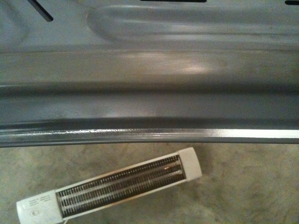

testing so see how smooth it came with primer on the sealer. pretty good, very close to factory look.
