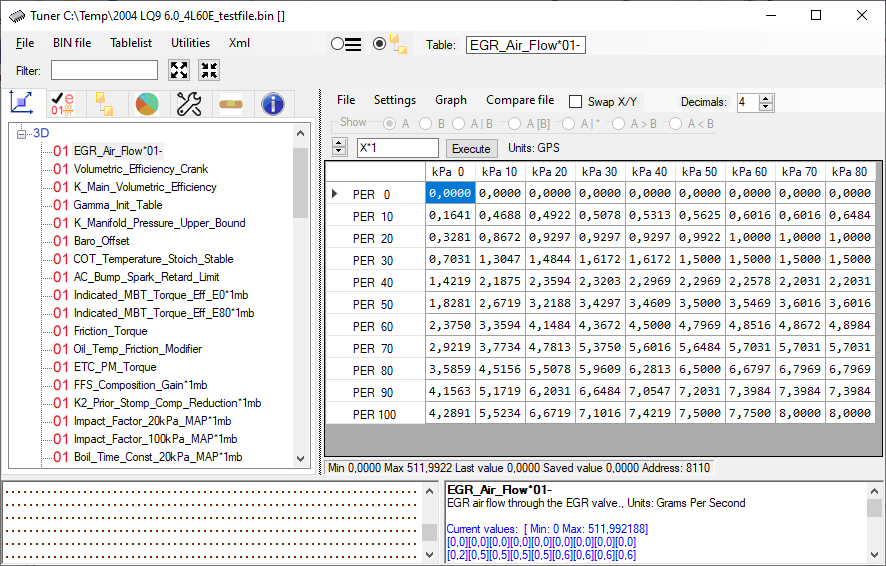

E67 code lookup should be fixed in version 0.17.79
There is lot of updates since my last post on this forum, can't even remember.
Mostly in Tuner, added explorer view and other features.

Great looking tool....Nice work...I have a few e38's that need DOD shut off.I have a couple of non-DOD bin files to swap segments from

Brian_Griffin wrote:Great looking tool....Nice work...I have a few e38's that need DOD shut off.I have a couple of non-DOD bin files to swap segments from
No need to swap segments. It will find the dod switch for you.
ironduke wrote:Can anyone verify that the code lookup for the E67 ecu is off a little bit.. I have now tried it with 4 E67 files since I found it to be off and I don't think it's my files?
Changing code offset to 2 and status offset to 1 seems to line everything up but would love someone to check my work.. This helped me see how universal patcher is finding things, very nice!!!
It was some bug in the +10000 code offset. No pattern so far for it and really hard to manage.
You can also check e78 DTC search. Do you have some bins that needs DTC search.
