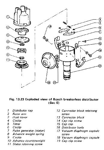

This is a reluctor distributor, right?
And a reluctor pickup produces a short AC pulse, which I'd need to convert to a TTL square wave signal to use as a distributor reference for the 808?
This TTL pulse is normally generated by the Camira ignition module isn't it?
What sort of pulse width does the 808 expect? Is 1ms in the right ballpark?
Re: another Alfa Romeo conversion
yeah it looks like it is.
Here are some scope caps from testing a camira module. The pulse width depends on the trigger wheel, but pretty much any 5v square wave is fine .... https://pcmhacking.net/forums/viewtopi ... =40#p12856
Do you want to avoid using a camira module, or just sussing out the best plan of attack? If you do use that module, then it'll convert the sine wave pulses to square wave for you and provide tolerance to over 20v at higher rpms when the volts rise.
