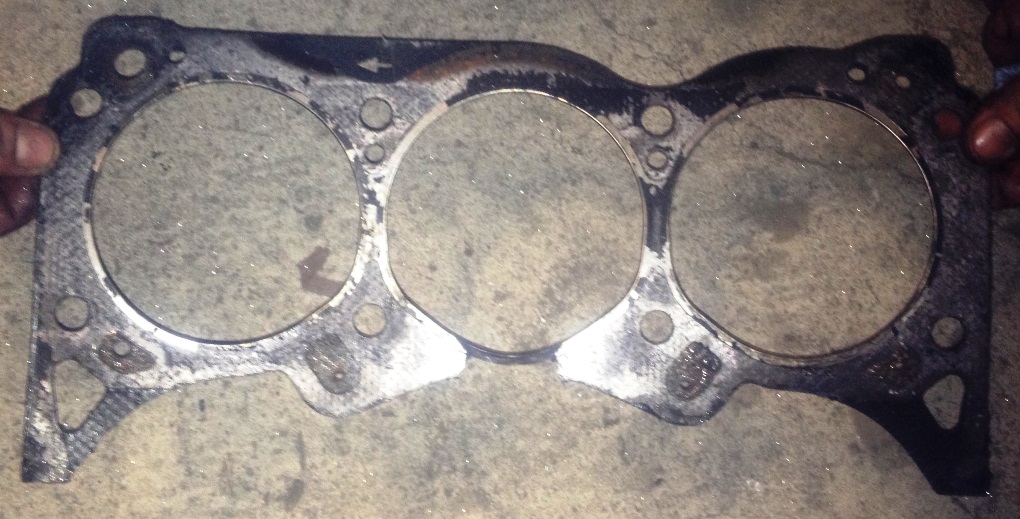

well half of the driver side middle cylinder head gasket is sitting in the valley!
found out whats caused the issue too ....
it looks like when my brother put the wastegate vaccum hose on he put it on the end of the gate, so basically the more boost it made the more it held the gate shut!
atleast it explains why it felt like it went so good hahaha
probably could have seen up to 30 psi in there

- Posts: 10330
Re: Mint VP V6 Sedan soon to be boosted!
Whoop there it is!
only thing left is the fire ring
- Posts: 7849
haha awesome gasket.
so how much can these engine take reliably? in terms or boost and power output.
