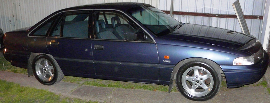

so this is the most mint stock $1500 commodore i've seen for a long time! 150,000kms on the dial, totally clean inside and out and virtually perfect paint and body. All my brother has done is replace the hub caps for some decent rims and is now planning to force so more air into it for a track car!

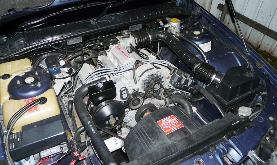

We can't find any oil leaks or any crud built up on the motor anywhere!! I can only imagine that this is roughly what they looked like from holden back in the early 90's!

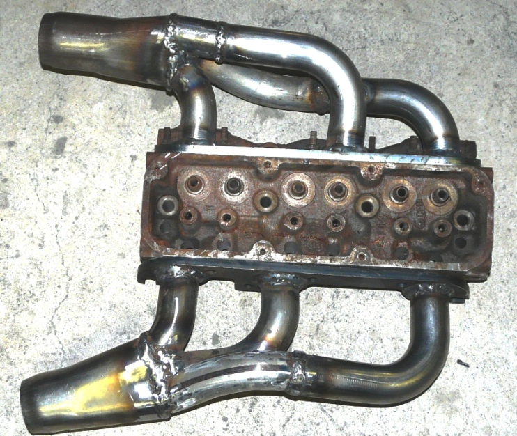

plan is to have forward facing 3 into 1 pipes then into 2inch x 2 into the turbo, he wants to keep it not too spastic cause hes not sure yet if he wants to maybe rego it one day!

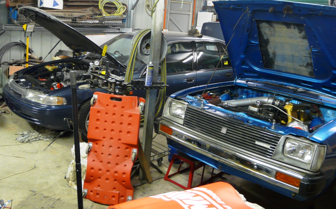

finally got the shed cleaned up enough to get my brothers VP in so the turbo upgrade can finally start!
2012-09-12 - Shed.JPG (307.58 KiB) Viewed 18677 times
got to do a few deliveries to drop off some of the stuff thats not mine thats cluttering the shed then we are good to go!
had the turbo semi log manifold on the gemini to move it in and out of the shed ...... its kinda ... errr .... loud hehehe :punk:

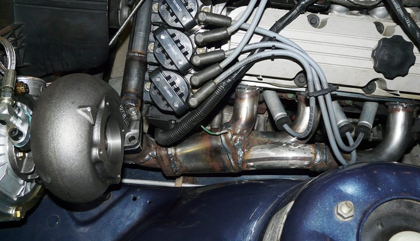

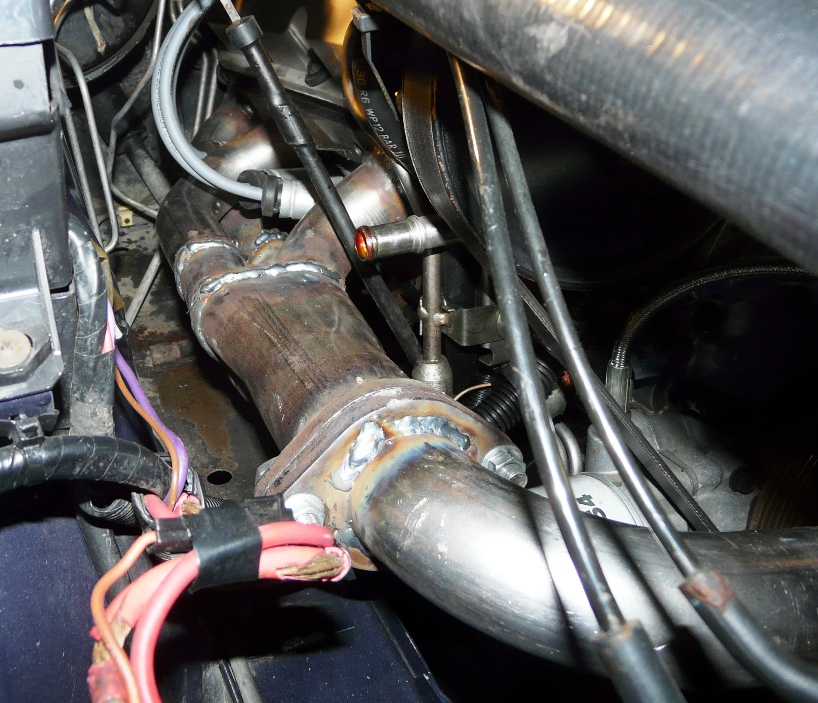

got the header pipes made up and ready for the next section - into the turbo!

also had to get a group turbo photo :)
2012-09-17 - shed.JPG (528.34 KiB) Viewed 18621 times

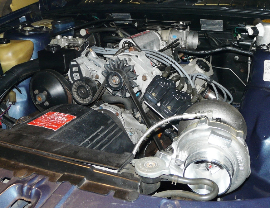

THATS A BLOODY BIG TURBO!
what size is the wheel & will it take a bit to get spinning?
Re: Mint VP V6 Sedan soon to be boosted!
its a GT35 .70 compressor and .82 turbine, as far as how its sized, no idea till they run!

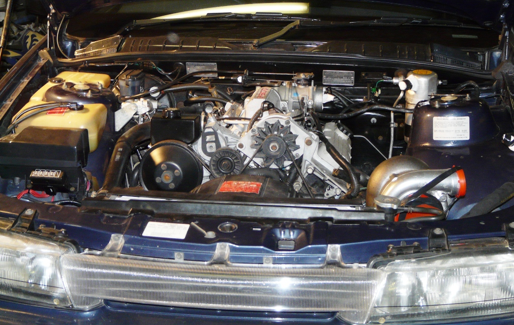

we have the VP to the stage of the exhaust completed up to the turbo flange :)
gave her a quick start last night to make sure everything worked as expected! i tell ya what a v6 is alot quieter than the gemini :P
