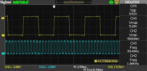

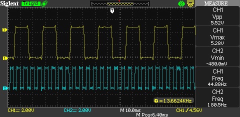

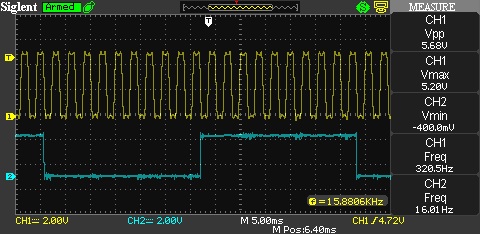

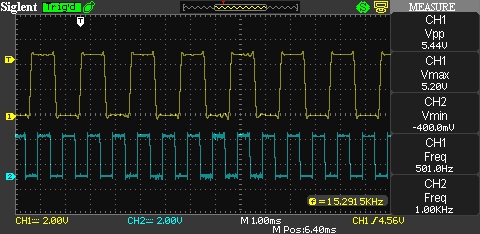

I've been playing with scaling the VSS signal up and down, results are looking promising:
(blue = VSS in, yellow = scaled signal out)
PPK reduction (division): PPK increase (multiply): I'm hitting a few issues with both measuring and generating really low speed pulses, but I think I should be able to sort that out...

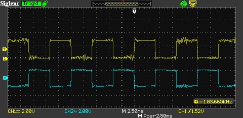

This might not look too significant, but...
The blue trace is a square wave, like a hall effect sensor would produce, and the yellow trace is the square wave output from my reluctor amp board.
This signal is being converted from a hall effect to a reluctor type, then back to a hall effect, eg. a universal converter
The "reluctor" waveform in between the conversion stages doesn't look much like a sine wave, but it's triggering the zero crossing detector pretty well as shown by the input and output signals staying 180* out of phase.
