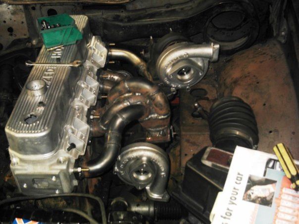

It's because there's a turbo in the way on the other side.
If you look at the first photo I put up you can see.

I actually thought it would clear the alternator!! All good, nothing much else on that side of a 202 anyways!

The turbo itself clears the in take pipe and out pipe won't which is why I just moved it too the other side so I have more room for the pipes.
