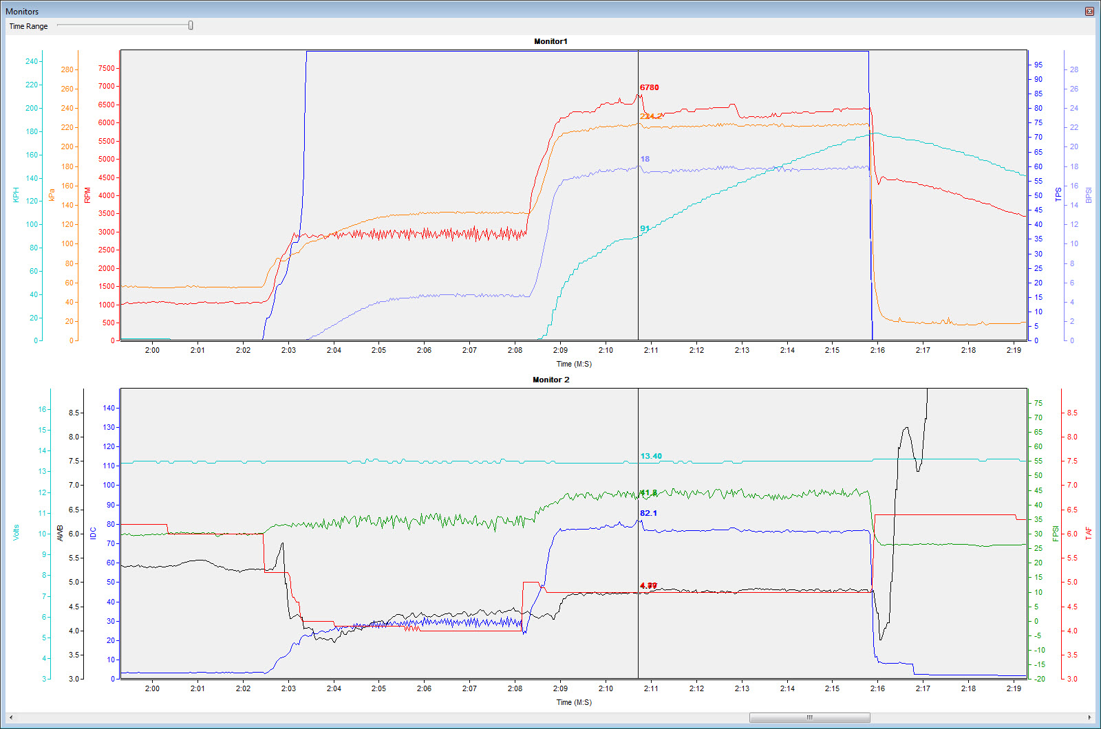

so I went racing on the weekend, (see my ride thread for that info) and I am pleased to say that I saw 13.4-6v's all weekend long from the alternator so very happy with that result, possibly could improve with the sense wire in the boot, but im happy that its just saying up in the 13's :)
alternator log.jpg (356.77 KiB) Viewed 5008 times
Re: Alternative Alternators ?
Much better!!
yeah sure is, put 20% more fuel into my boost ve table after the first run to get it back to where it should have been, so theres obviously some injector offset changes needed
I am stunned by the 20% difference in the ve table :wtf:
I am well aware of the effects of having the wrong voltage in a circuit but have never considered the after effects like in regards to tune...
Well done, i hope others learn from this, i sure did. :thumbup:
Post by HQ355 »
Is the percentage so high because it's on methanol ? Would it only be 10%ish if it was petrol, still a big diff though
yeah im not 100% sure to be honest ... all I know was the AFR's were about 5.5 and after richening 20% it went to 4.8 which was the 16psi target afr .... its also taken my injectors to 82% duty cycle, time to turn the rail pressure up shortly I think!
