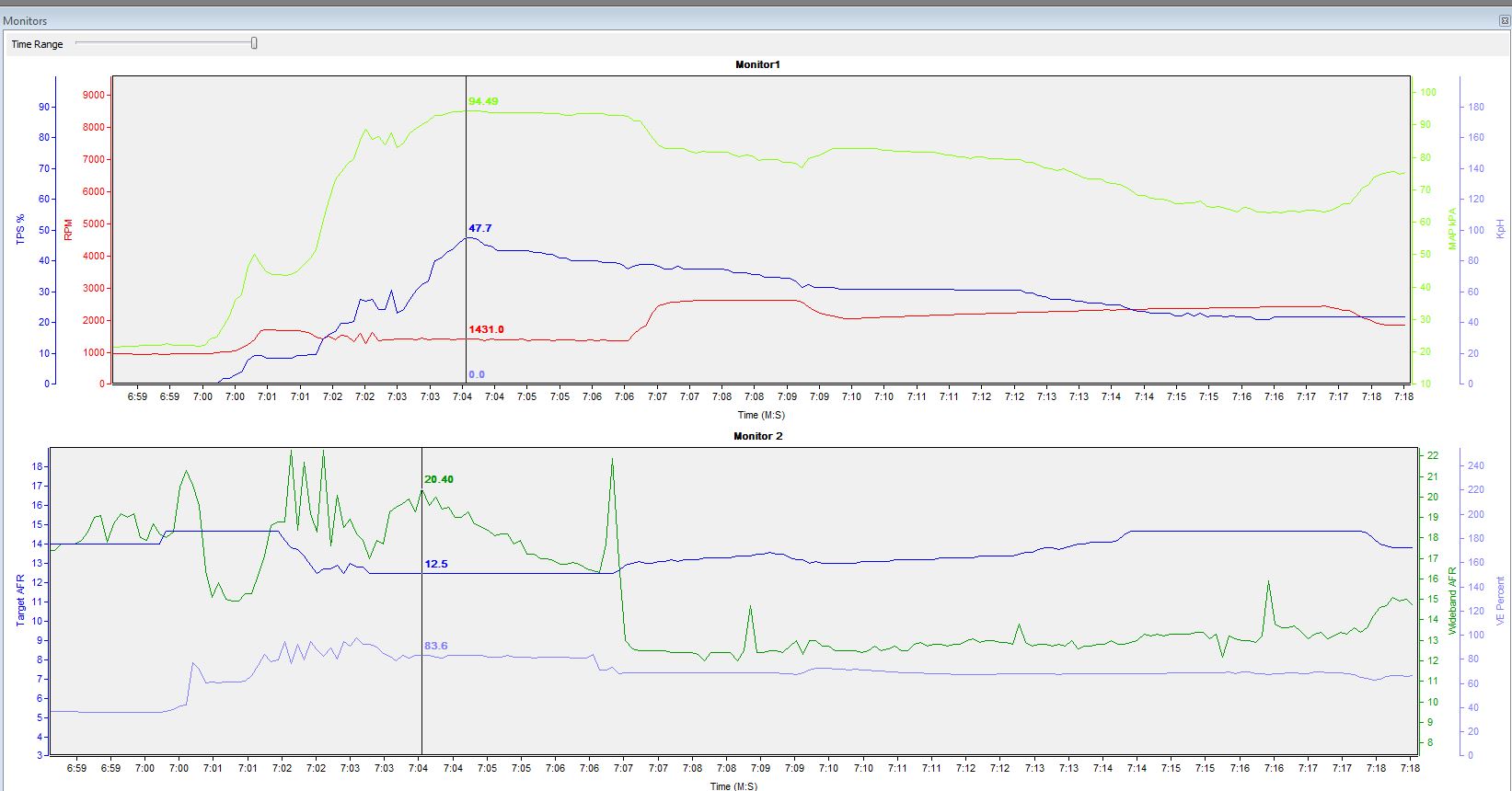

ok see here, from jeep61.2.xdl
look where you push the throttle open at 7:03 and it goes lean. then while maintaining a steady RPM and MAP, the wideband slowly comes richer. that tells me you need lots more AE (like the throttle pump in a carby) there are loads of lean spots and some of them are VE a little lean but a lot of them are right after you open the throttle and are caused by not enough AE!
as for the timing ... its only 8.8:1 compression, ive seen engines with similar compression with 36 deg+ timing at WOT on petrol. all depends on cylinder/head shape etc. I wouldnt be surprised if thats the timing it needs.
