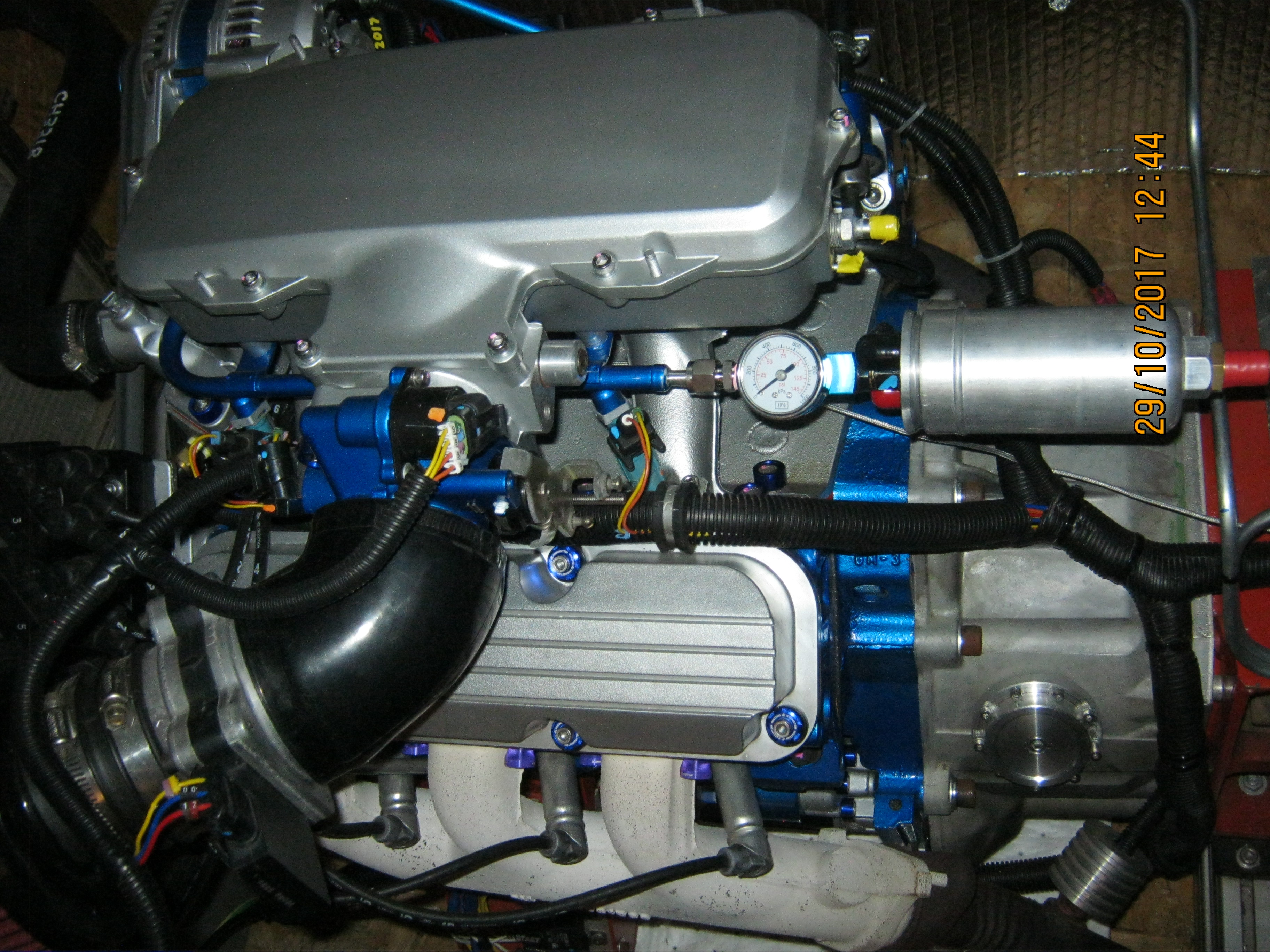

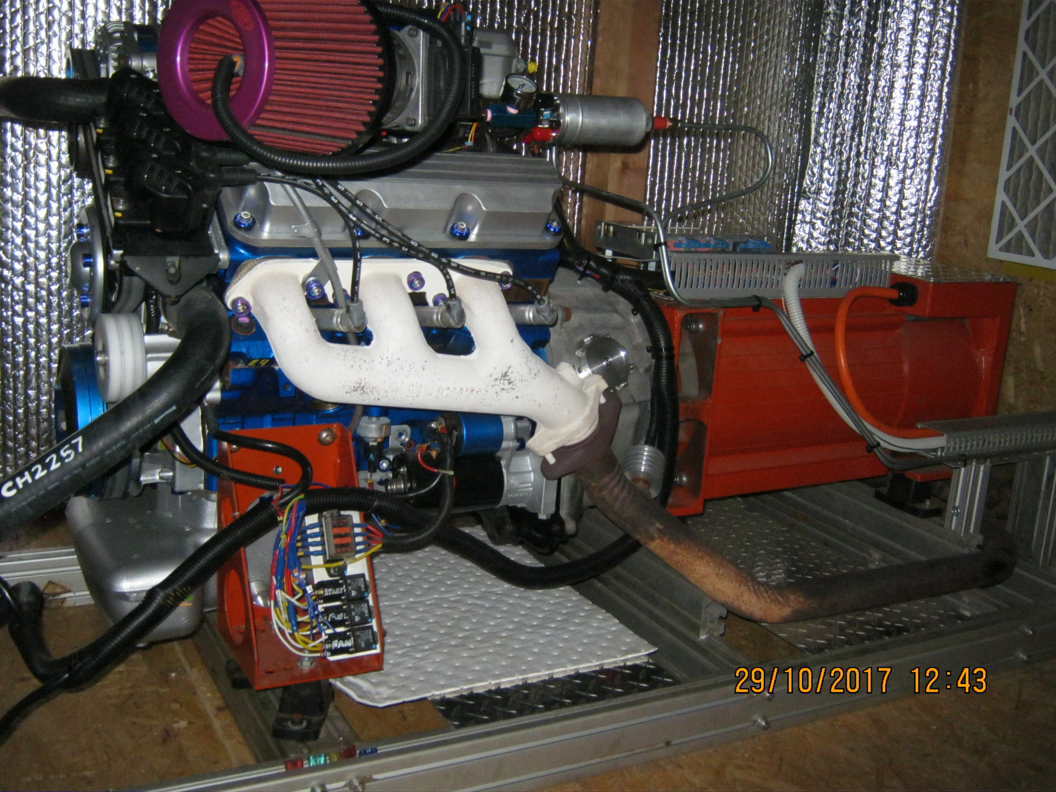

just an update for those interested ... i have tried several ways to go about throttle control , i have come back to using the ECU and the factory ISC
... it has the fastest response time (better than the cummings governor) it holds speed +/- 50-100 rpm or so when dumping 14KW on and off ...
that's only about 3Hz ... i have it basically installed and running the whole property through an auto C/O transfer switch .... im fairly happy with it so far ...
any thoughts pls let me know....

Nice job, glad it worked out.

That's some generator jesus
Re: Generator Idle
love the paint job, gotta pimp the genie
how long do you get out of a tank of fuel ?

runs sweet....i scored a 100 ltr ally tank... i think it sucks around 2ltr / hour.... but not 100% sure yet ....
engine is fully rebuilt ... 20 thou oversize.. rings,full bearings.. recon everything .. and for sale in adelaide ,make me an offer..
can hear running...going to replace with SC V6...

I see you did a vlad spec there with marking the bolts and screws.
- Posts: 10013
Re: Generator Idle
Thats awesome. Thanks for the pics! Also glad it worked out.
- Posts: 5709
Re: Generator Idle
What are those rocker cover bolt seals over the factory one splitting
