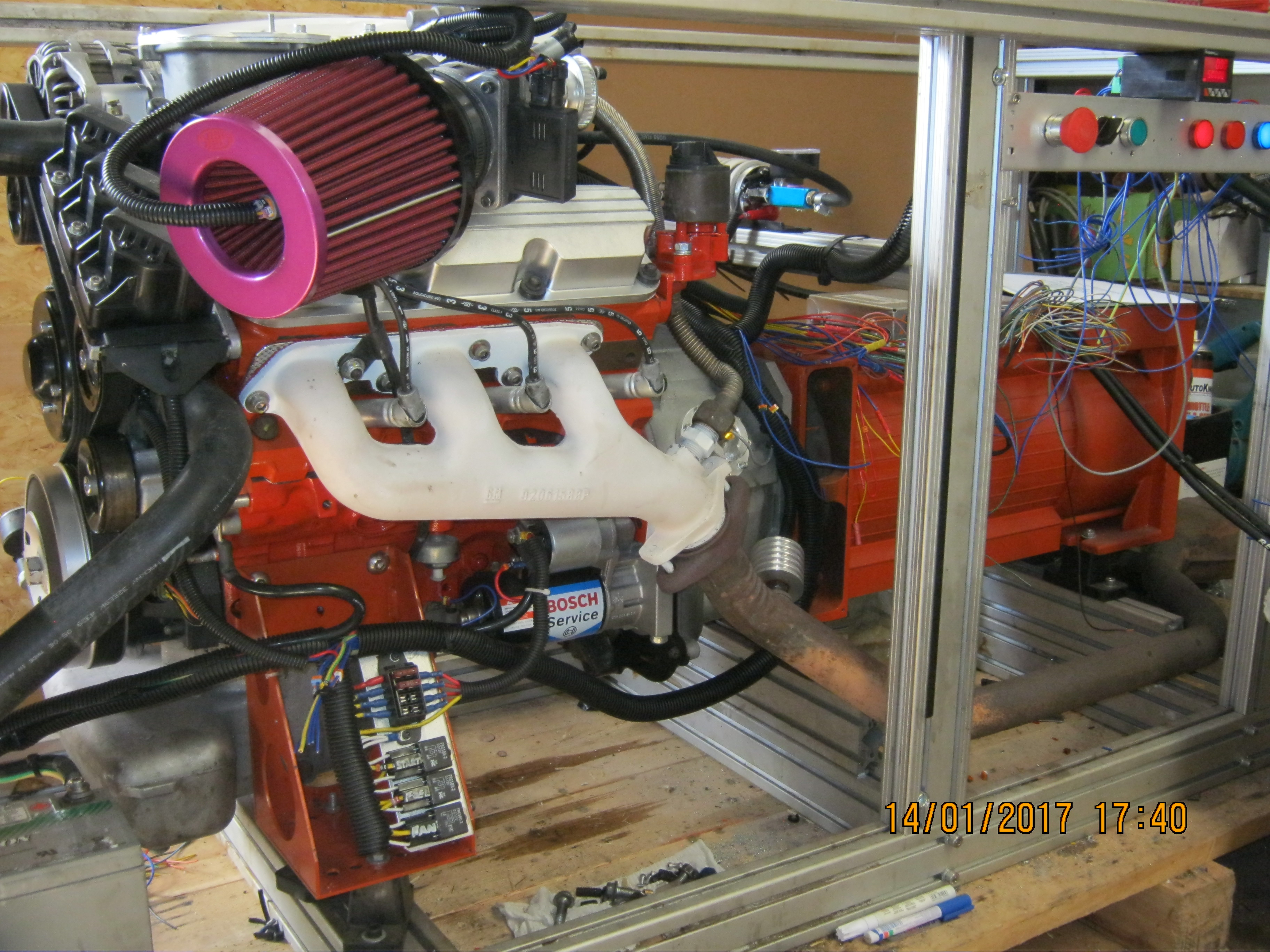

Re: Generator Idle
XDF , BIN and a PIC ...........
- Posts: 3820
- cars: VS,VT,VX,VE
Re: Generator Idle
Damn, that's a tidy setup.
I don't suppose you have a pic from the other side?
The reason I ask is that the engine coolant system incorporates a bypass in the coolant system that runs through the heater tap. This bypass helps the engine warm up and somewhat regulate engine temps. If the bypass is blocked off it will effect how the engine heats up etc.
edit: I'm no expert on generators but wouldn't the PCM be exposed to a fair bit of electromagnetic interference sitting on top of the gennie?
