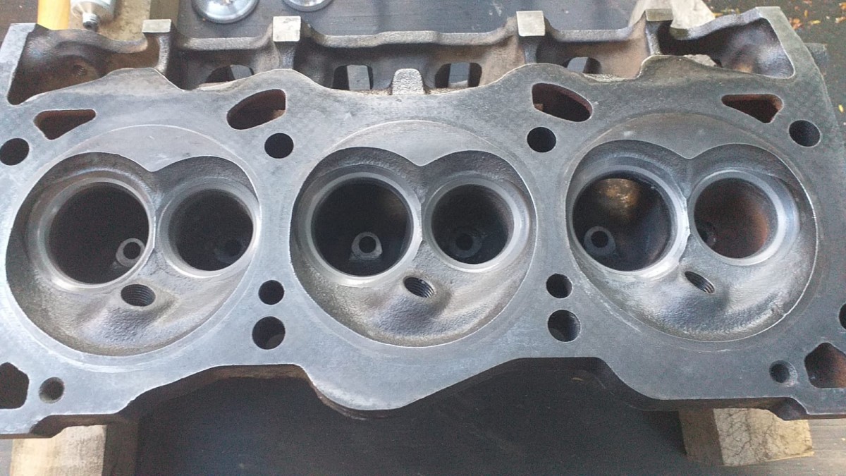

Have a GOOD like in the head chambers between valves too as these are prone to cracking between ESPECIALLY when on LPG!
- Posts: 3823
- cars: VS,VT,VX,VE
Re: Project Rescue
Yeah I've had a real good look and we see nothing. Just the stuffed exhaust valves.VX L67 Getrag wrote:Have a GOOD like in the head chambers between valves too as these are prone to cracking between ESPECIALLY when on LPG!
- Posts: 8600
Re: Project Rescue
I have only seen one ecotec that wasn't cracked there. I am surprised these aren't.

I have pulled hundreds of these engines apart and very few crack, even on LPG...
- Posts: 3823
- cars: VS,VT,VX,VE
Re: Project Rescue
That's good to hear because I've been looking for cracks and can't find em. Even tried different light sources, scrubbed the shit out of em etc.

I have found one only once. Steam was blowing out of this customer's VS V6 the exhaust. I thought 'head gasket'.
When I pulled the heads, the gaskets checked out OK.
In most cases you should, by eye, be able to pick up a crack. I could. If you are really in doubt get them crack tested.
My example was fairly easy to spot.
These heads are definitely more prone to cracking, because of their 'lightweight' design. But that doesn't mean they will...

Definitely nothing like that on my heads.

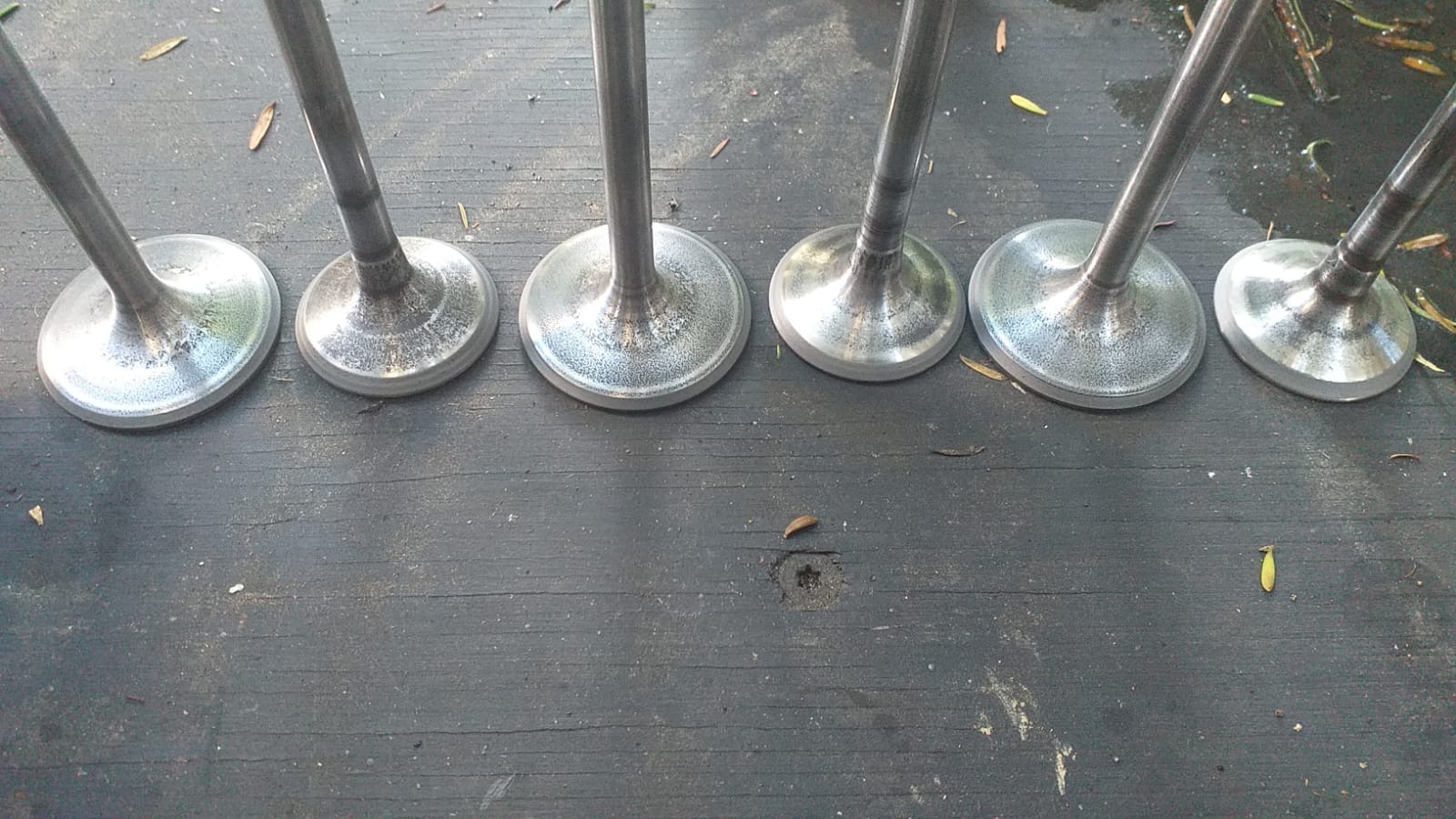

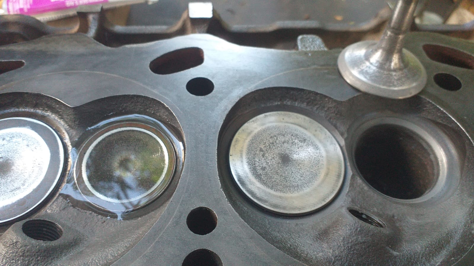

My new valve grinding paste finally arrived (a day late as is the norm here).
It's not ideal, far from it but this how the worst head has come up. The worst one I tested with water for over an hour an no leaks. So it's not a by the book kinda freshen up, hell, I'll probably blow it up at some stage at the end of the year so I'm not hugely fussed over it.
