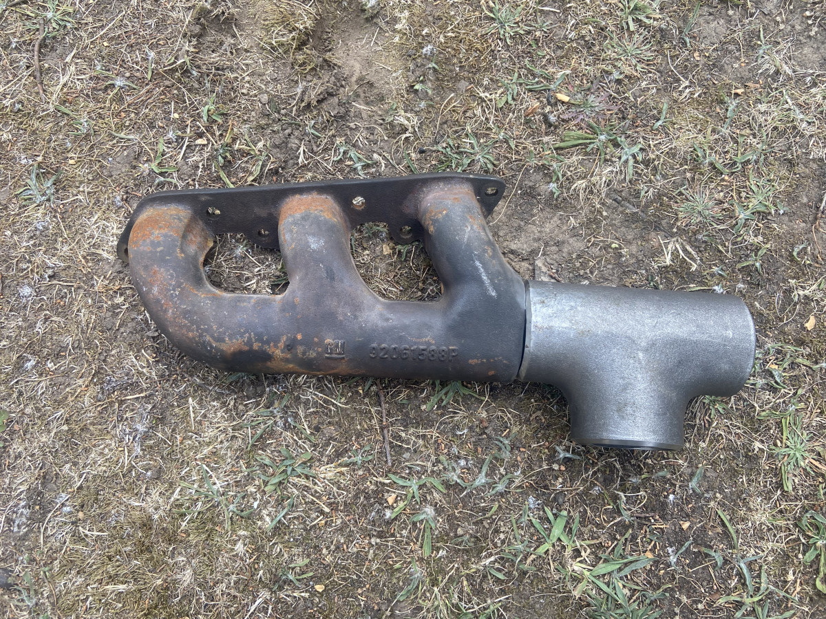

NOS exhaust manifold, that's got to be rare?
Wade
- Posts: 1229
Re: Vy commodore

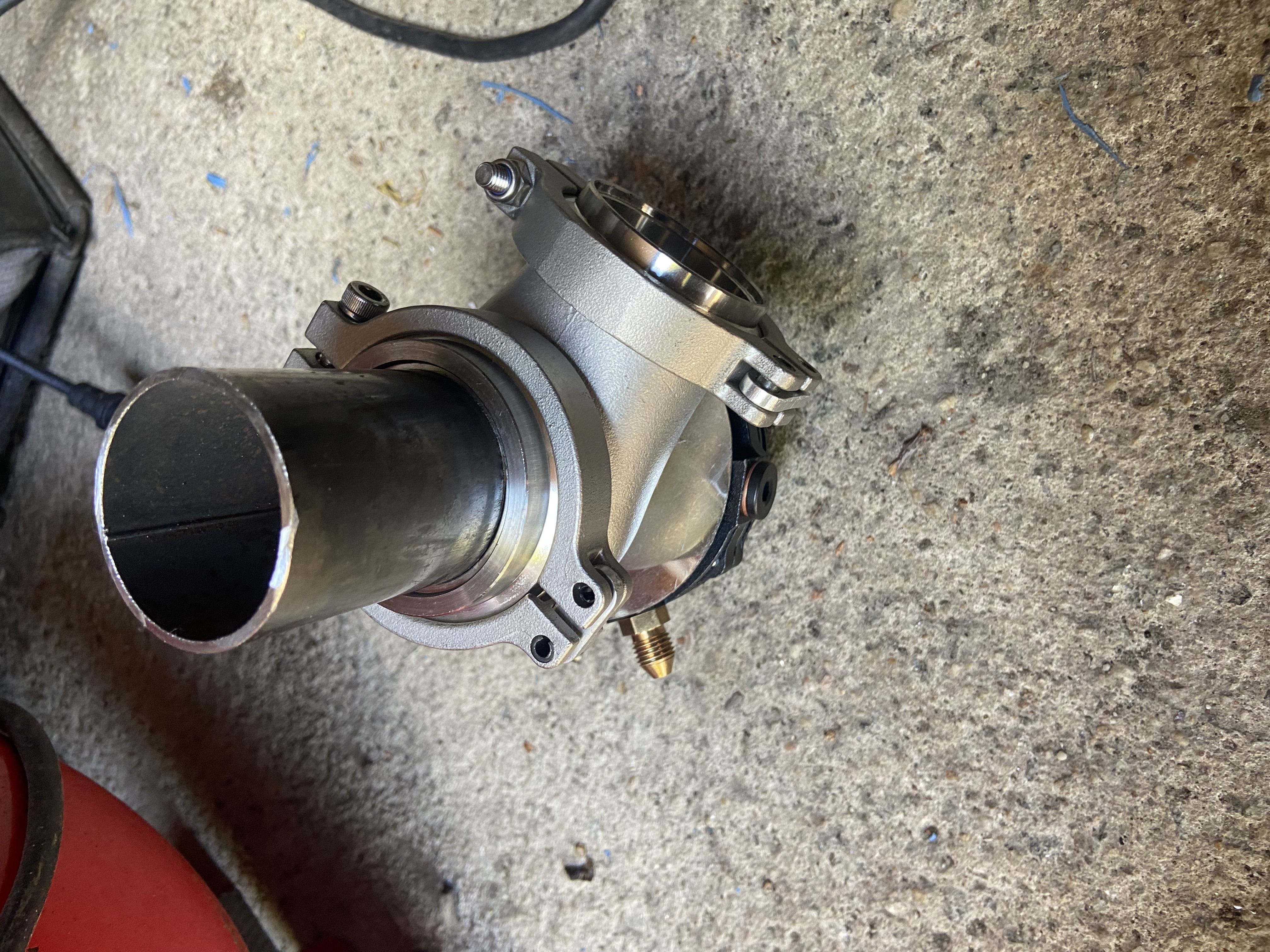

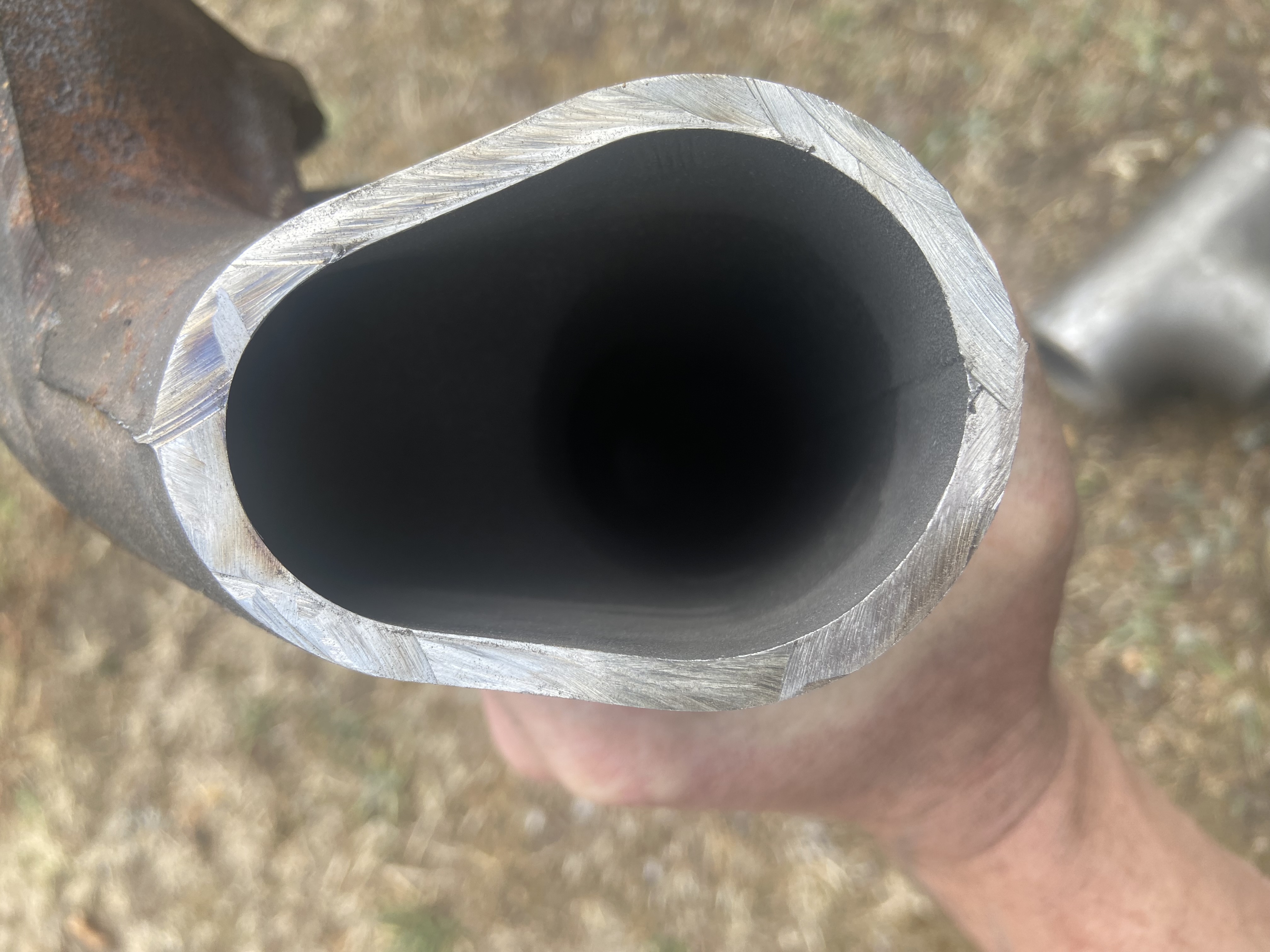

Nah from the wreckers mate. Plan is to try a low mount the turbo. And I’ll try weld cast iron to sch40 pipe. If that doesn’t work I’ll still be able to make a jig from that. That’s if I can get it all to fit down there. I’m not too keen on a top mount turbo setup this time.
Wade
- Posts: 1229
Re: Vy commodore

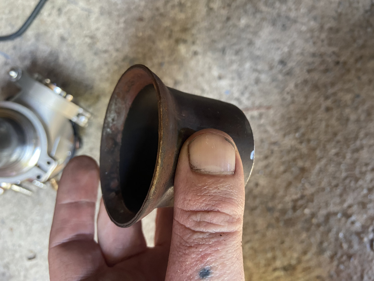

I’ll use the cut off flange from the pipe attached to the manifold from the wreckers, so that’s the drivers side sorted. Just use the flange as the start of the crossover pipe. And I’ll use the maxspeedingrods 44mm gate for mock-up. Now just need to order a t3 flange, and need a day or two to try see if I can mock it all up in the car.

How do you intend to get the oil back to the sump?
Wade
- Posts: 1229
Re: Vy commodore
I’ll have to look at fitment once I’m mocking up. I have looked at the sump and looks like there’s enough room for a return there
