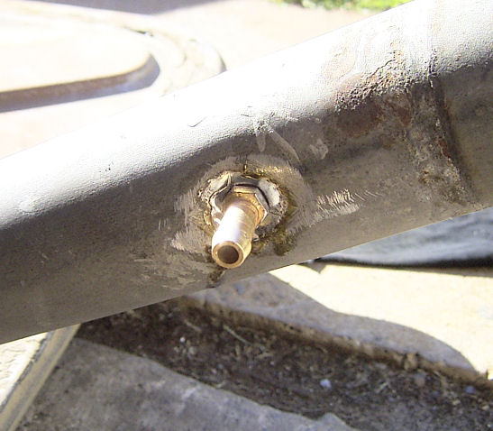

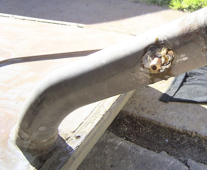

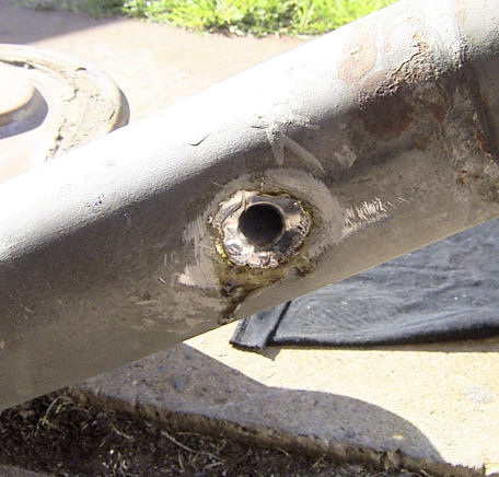

Just found this post from wAy back. You beauty, what a great option for a fuel return i never would have thought of. I am so glad I reviewed these old posts. So many memories and opportunities to relearn stuff. ThanksHolden202T wrote:the strange sounds could have bee the IAC ticking
another option for your fuel return if you wanted to, I've done it before to old holdens, get a centre punch and sharpen it up to a good point, then punch a hole in the tank filler neck, keep hammering it in till the hole it large enough to fit a brass barbed fitting in, then solder it in place. saves too much damage and soldering is safer on a fuel tank!
Re: 265 Hemi to efi
found the pics of it for ya
Re: 265 Hemi to efi
Thanks for the pics
