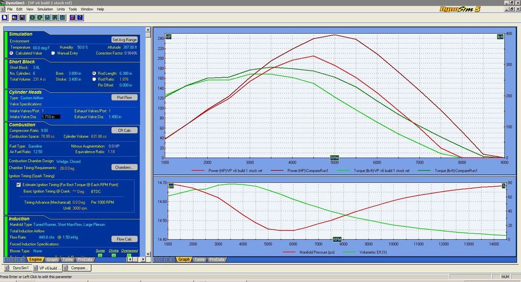

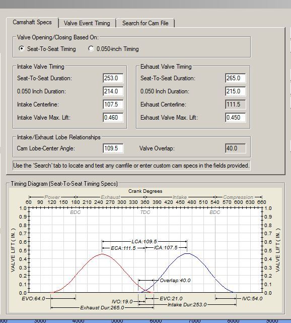

How does your ramp rate compare to off the shelf performance cams like the Comp Cams type cams? If it's a faster ramp rate than you would want more seat pressure.
its a far bit more than any crow cam, their stage 3 is smaller than comps stage 1, about comparable to many higher speced comp cams but really they are all small whats available off the shelf
stock is 2.27, mine is 2.89? on the intake and around 2.5 on the exhaust.
Posts: 8550
just checked the calculations 3.06 on intake 2.66 on exhaust. up there with some of the more aggressive cams out there for Australian v6 market.
overall the cam is small, not much duration or lift but ramp rate and timing events makes this one fully optimized for v6 mild engine.

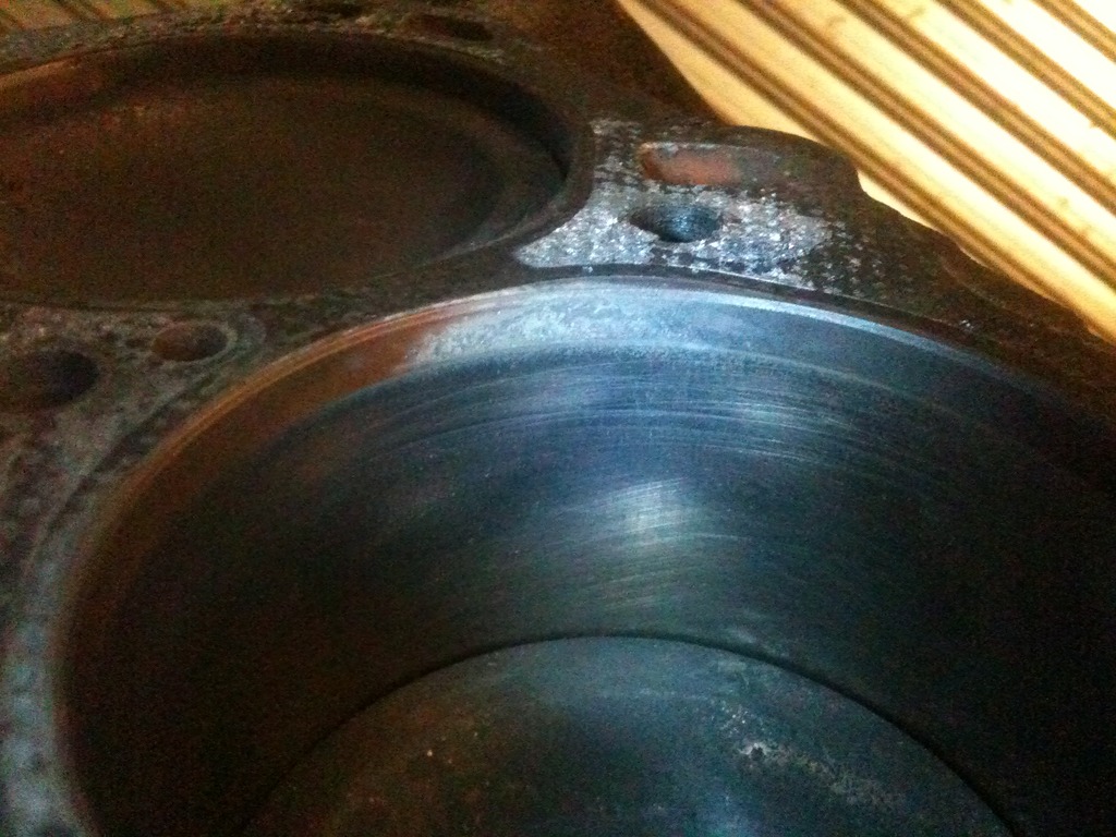

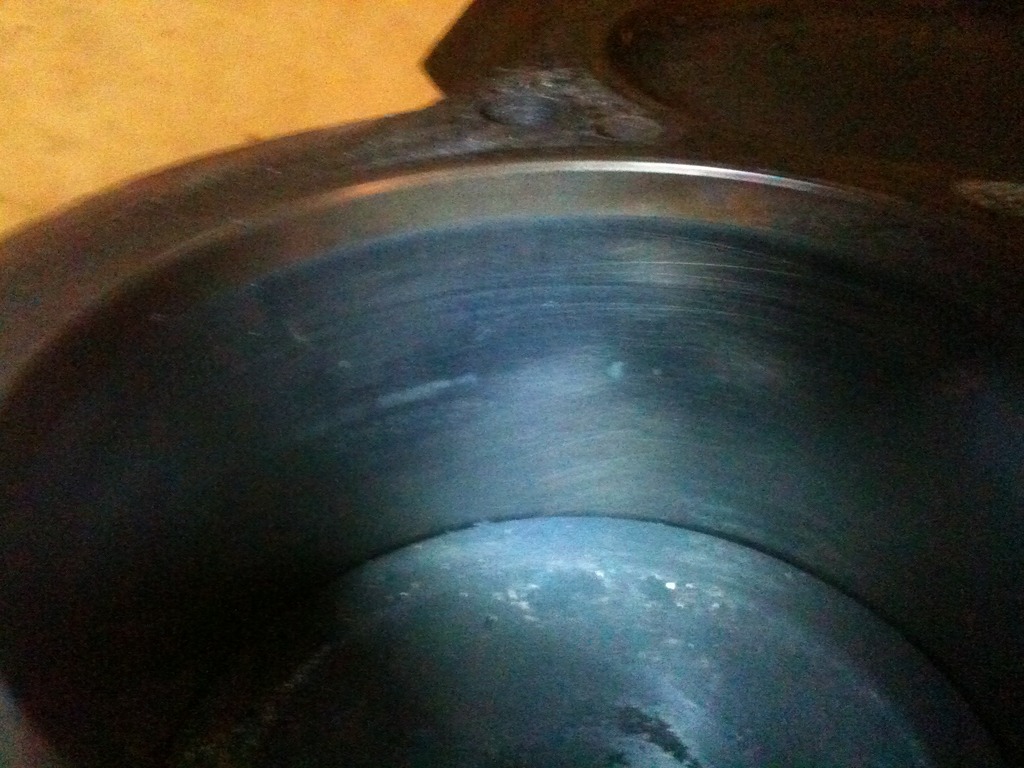

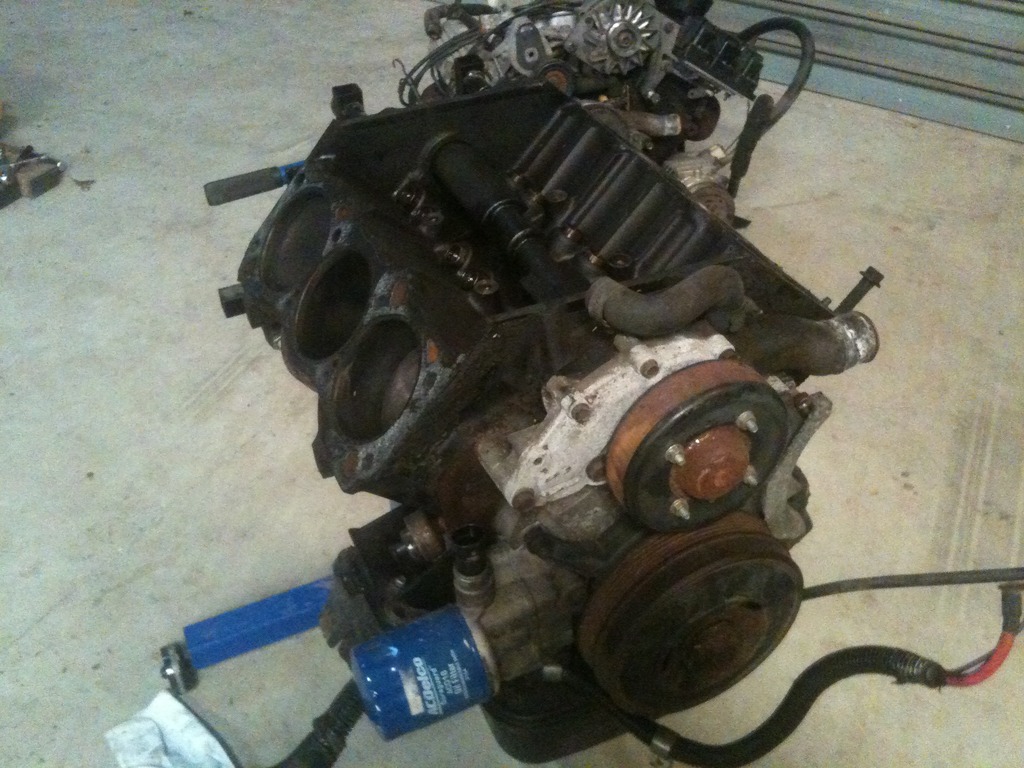

An update on the VP build. started pulling down a spare 400k engine that came out of another vacationer out of all things.
I kept it as it ran very quite, no rattles at all and pulled very well and was 99% untouched.
So here are the first look ins of the insides.

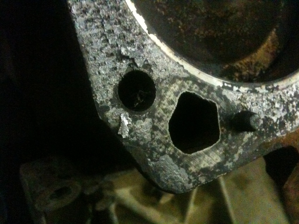

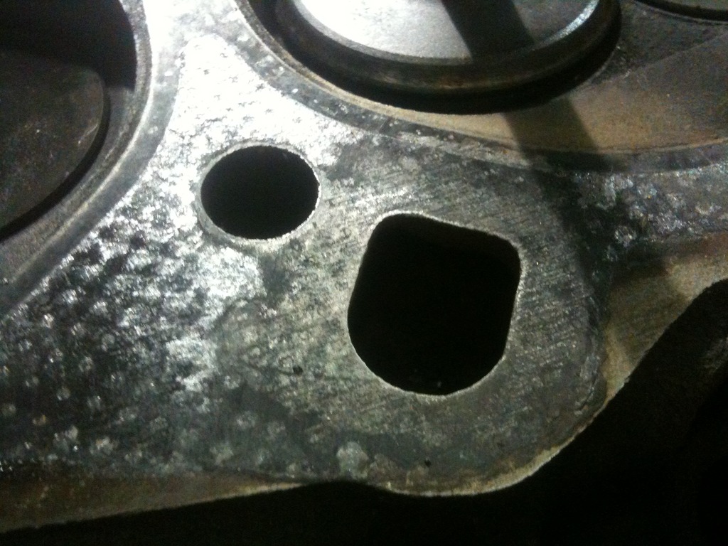

the lip is non existent on 5 out of 6 bores, the only one I can just barely feel it with my nail. Some water staining though from leaking intake gaskets :think:
interestingly you can see the factory dont torque plate hone. Can actually see the high spots caused by cylinder distortion from the head bolts.
Definitely getting it torque plate honed then :thumbup:
the water jackets are unbelievably good, no pitting whatsoever.
Going to Duggan's balancing tomorrow to drop off my heads, will talk to them about options available.
Oh yeah, forgot to add this. slack much? gota love the factory timing chain :thumbup:
