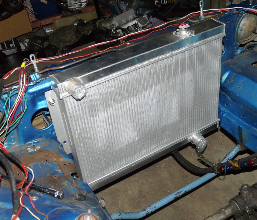

in an attempt to keep my motor cool i have upgraded the radiator :)
