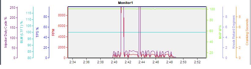

I tried to start the engine, but no luck yet :oops:
The plugs are getting wet, and getting very lazy rich flames out of the headers.
The logs show that occasionally my spark sensor is still passing a bad rpm signal now and then, and I'm guessing that the injectors are going to 100% at that point and it's instantly flooding. Sometimes the spark signal is very clean, but often seeing one or two very high rpm pulses while cranking.
How is the fueling calculated once it thinks it's past 9600rpm? Is there a factor applied, or does it use the 9600rpm table cells?
I imagine it's going to add a whole lot of fuel at 60,000rpm :shock:
An example of the spike:
Sample #,Time -Seconds,Engine Revolution Flag,Engine RPM,Fueling Mode,Injector Duty Cycle %,
1515,163.139,Clear,635.0,Open Loop,32.5,
1516,163.223,Set,635.0,Open Loop,31.1,
1517,163.358,Set,633.0,Open Loop,32.4,
1518,163.442,Clear,187.0,Open Loop,9.2,
1519,163.576,Clear,187.0,Open Loop,9.2,
1520,163.660,Clear,61440.0,Open Loop,3226.4,   <---
1521,163.795,Clear,694.0,Open Loop,36.4,
1522,163.914,Set,189.0,Open Loop,9.7,
1523,164.045,Set,649.0,Open Loop,33.4,
Re: another Alfa Romeo conversion
once it gets to the top of the table it uses the last value from then on.
something doesn't seem right with your injector DC % .... its like 20-30% at 1000rpm or less .... i wouldn't think it would be higher than the RPM ....
i'd also be changing the scale of the injector DC % so it only shows up to maybe 110 .... in theory you really don't need anything over 100% though.

Yes, I was suspicious about the DC% - if it's 25% during cranking, it'd max out just off idle ;)
I tried it again this morning with a different bin and saw 11% DC while cranking at 600rpm.
How do you adjust the scales in TP?
That's as far as I got because it then backfired and blew the plenum off the engine, I'd advanced the distributor a bit too much I think ;)
I'll have DIS set up done in a day or two so will try again at that point.

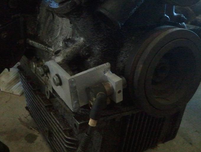

My brother kindly donated a Saab 9000 ABS sensor, this afternoon I started on a mount for it. It still needs a bit of shaping/tidying up, but should do the trick.
It also doubles as a block off plate for the mechanical fuel pump, 2 birds with one stone ;)
Posts: 9006
That looks the goods, nice and solid. Double function is a nice bonus :) hehe.
