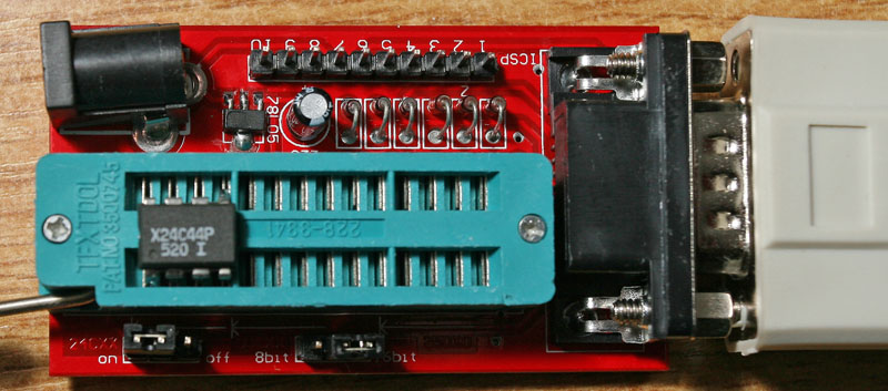

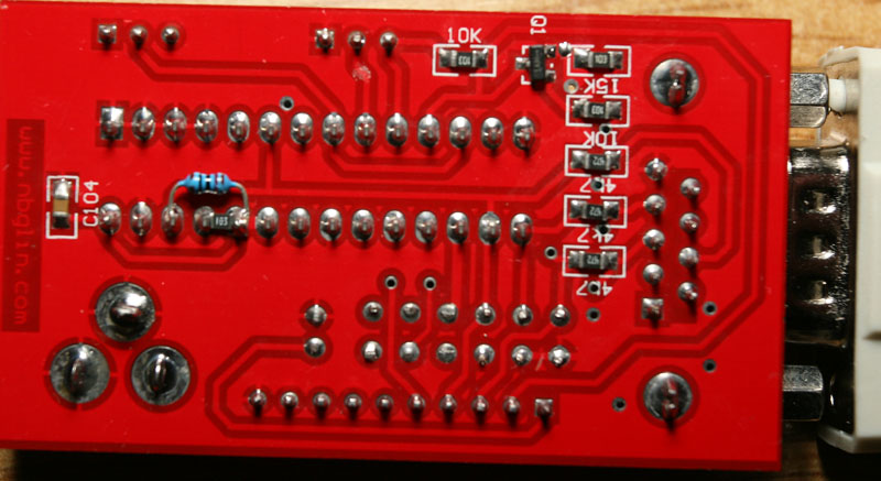

ok got the programmer today, didn't come with anything, so not sure what software to use with it, i did a quick google and found ponyprog and tried reading it with x2444 but not having any luck, ill post some pics of the board later, it does have a input jack for a power supply but wouldn't need it for this chip? Not for reading anyway. The board has http://www.nbglin.com written on it. I havn't used this ponyprog before but it seems to connect ok just can't get a read. Any Idea's?

here's the programmer. i have it all correct?
Might need to make an adapter, looking at the PCB pins 1-4 are all grounded which is fine for a normal 24cxx EEPROM. The 24c44 pinout is not the same so the I2C interface is on the wrong pins.

Are you sure the ic isnt in the zif ass about or up the wrong end ?
Normally the pin 1 indentation doesnt face the bottom of the zif on other ics.

it's a 3 chip setup, furtherest right socket space is for 25 chips middle is for 93 chips and left is for 24c chips. I hadn't really looked at the circuit or pinouts yet, big day and big week for me, so thanks VL400 guess ill have to figure out a adaptor, off to bed ill come back tomorrow lol :geek:

Fairly sure the ebay ad said x24c44 via ICSP only, so you can't use the ZIF socket.

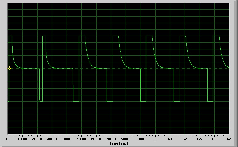

Using my sound card as a crude 'scope, it was pretty obvious my clk pulses weren't up to scratch so a slight change to the code and I'm getting data out of it now.
It really is a square wave, but the damn AGC on the microphone line makes it look rather strange as it tries to average it out :(
