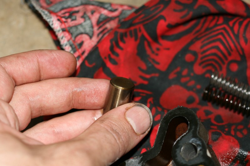

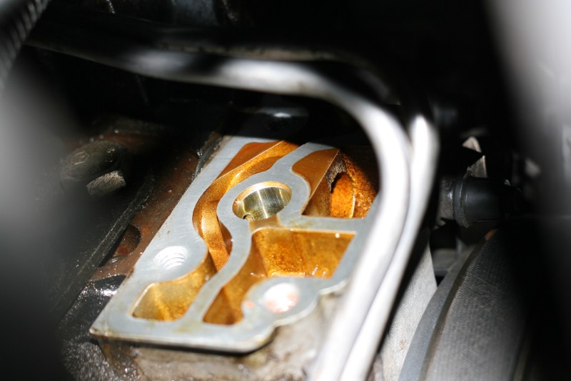

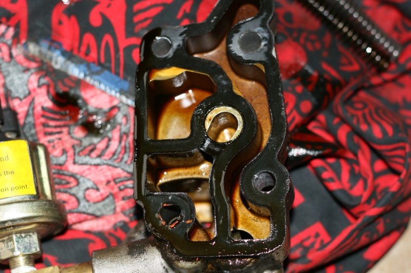

well it's service time again, offically clocked 300,000km now, going to put a new oil spring in. Internals look clean and piston moves freely in the bore so can't see any problems, old spring seems ok. Will post back up once ive gone for a run.

well no change with the pressure, idle about 65, anything off idle is around 73, WOT is 80. Thinking it's just the oil im using?

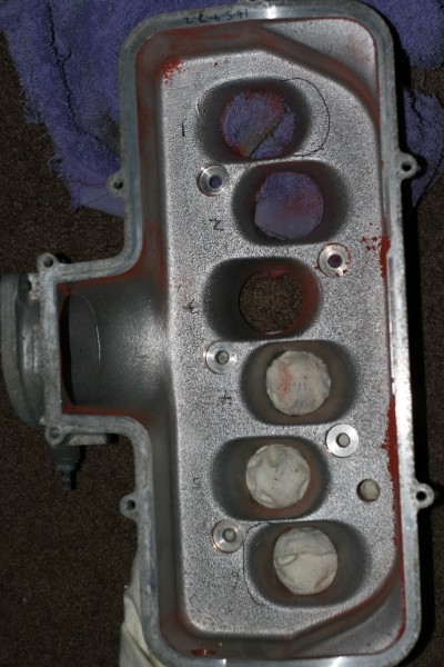

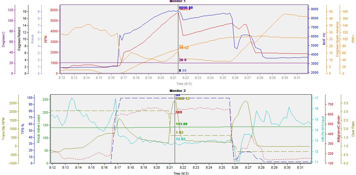

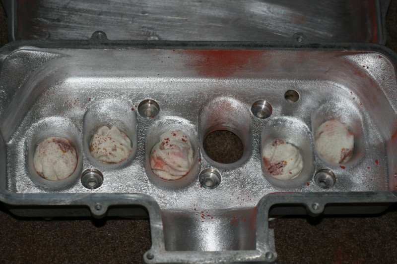

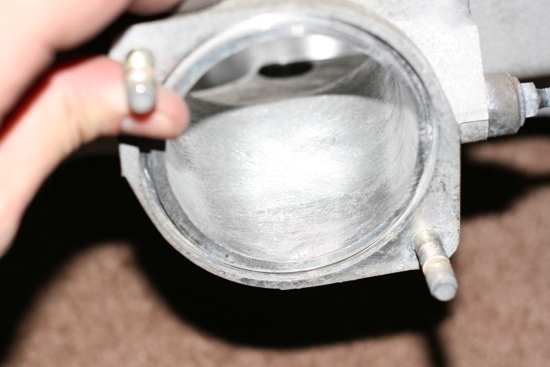

Also of note i picked up a free plenum to play with, did small porting and polished it up. Found in the logs about 100hz pickup @ 5800rpm and peak cylair went from 660 to 679, so there is some flow gains by polishing even with N/A
Did a simple test by using linemarking chalk dust and vaccum cleaner to pull it through a port with rest blocked off, you can see the accumulated dust vs polished. cleaned up all the castings I left the original thick wall between 3-2 5-4 as these intake after each other.
I only used $10 bits from bunnings, the grinding wheels were good for getting it started, but overall surprisingly the wire brush wheels worked even better at smoothing than 60grit flap wheels do. Here's my WOT atm.

Bugger about oil pressure not changing, but nothing too bad to worry about anyway!
Thats pretty cool & interesting about the polishing, nice work for a N/a... can't wait to see the results on the dyno!
