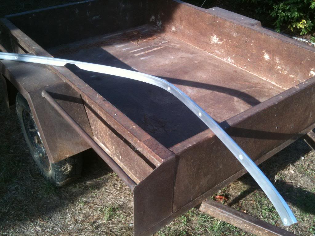

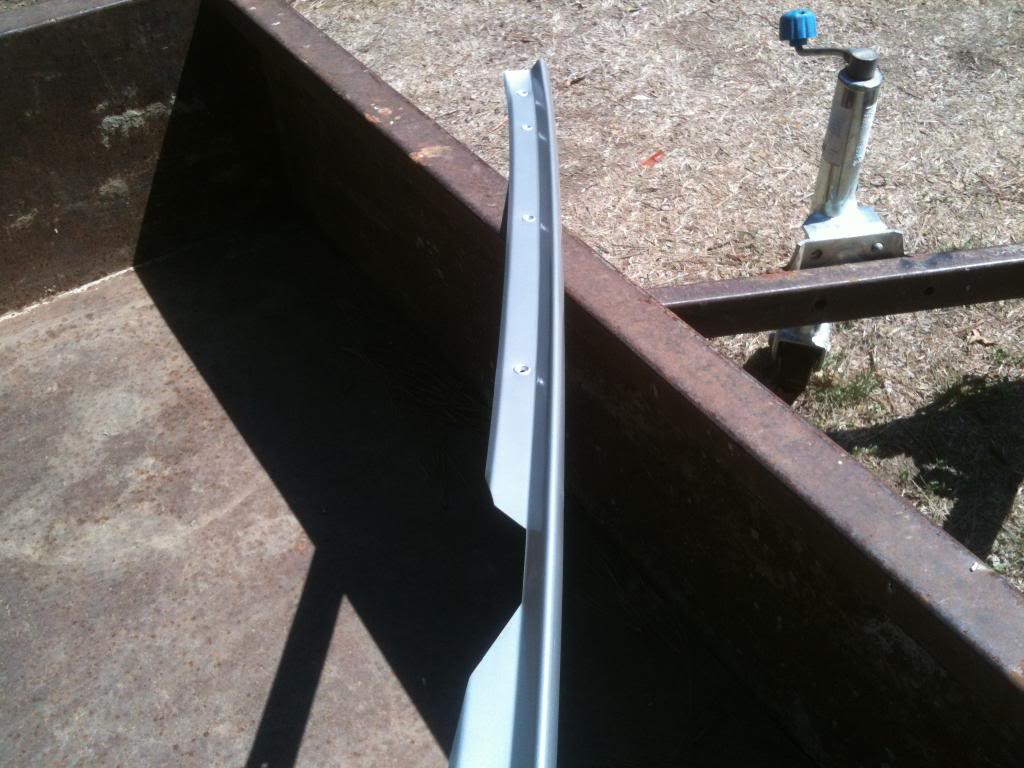

paint stripper and and pressure cleaner. :thumbup:

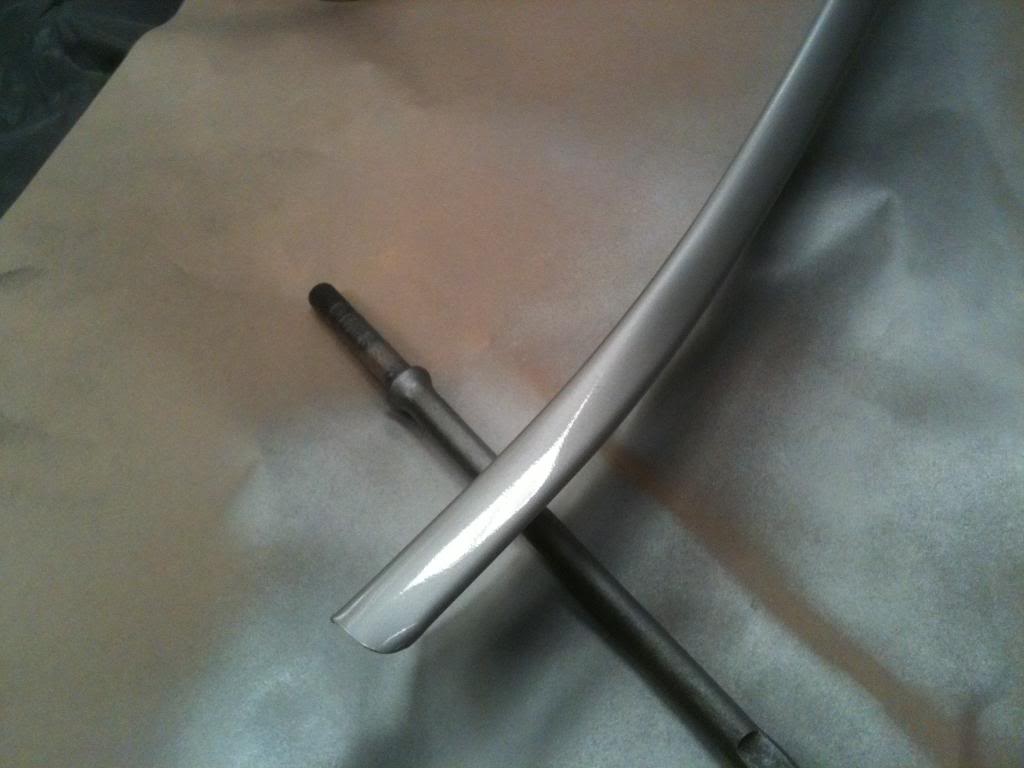

scuffed it, sandblasted any corrosion, and washed it with aqua clean pre paint water based wax & grease remover which also happens to etch alloy as its alkaline. Then finally regular prepsol.
I used black caliper paint but for some reason it has poor adhesion, so I went back tot he silver caliper paint which I know binds to alloy like its anodized on. its weird considering both are VHT. The only dif is the black is gloss while the silver requires the clear coat. maybe thats why? :think: Anyway i know the silver is good and it looks factory.
baking in the 35+ sun.

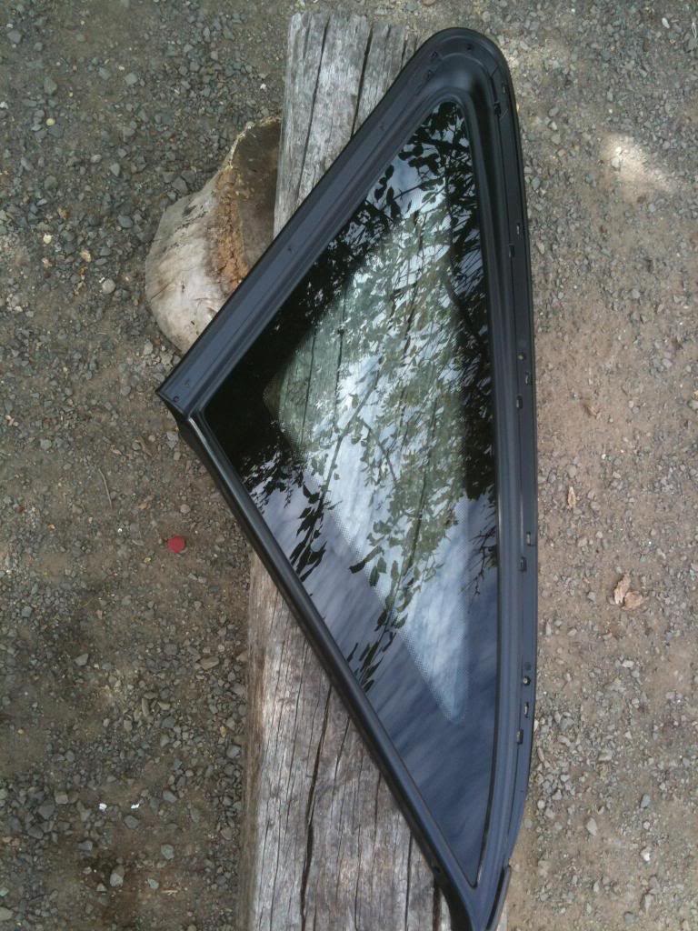

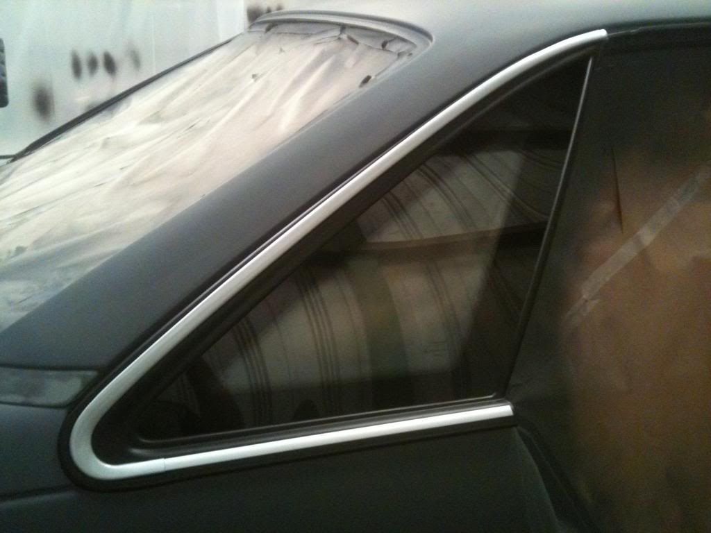

vigously sanded this quarter window for hours and hours. its rubber so it aint easy.
then washed it with that same aqua clean (its KBS btw), masked it the next day and prepsol'd it and painted away with VHT plastic/rubber trim paint. It works very well and doesn't look like gravel unlike the K & H brand, all their products are garbage. Never will buy their shit again.
wow, just wow :wtf: :D
looks awesome. really stoked about how it turned out.

mate the quarter window came up fantastic, going to do mine now as they look like crap :lol:
what grades of paper did you use to sand the rubber?
awesome job so far on the car
Posts: 8600
Re: Vlad's VP executive (full restro)
I used 320 I think, some 240 as well but mine were pretty smooth as far as these windows go.
on my vacationer it would be impossible to smooth them out. better off going to a wrecker and getting them best ones you can before you attempt this otherwise you will be disappointed. And the fact they might have already good ones there. One I got from the wreckers is almost perfect, very minor fading. so I will sand and paint them anyway to match the other side.
all trim paints are matte finish, but with the VHT trim paint, you can buff it to a semi gloss with a dry cloth, kinda like shoe polish.

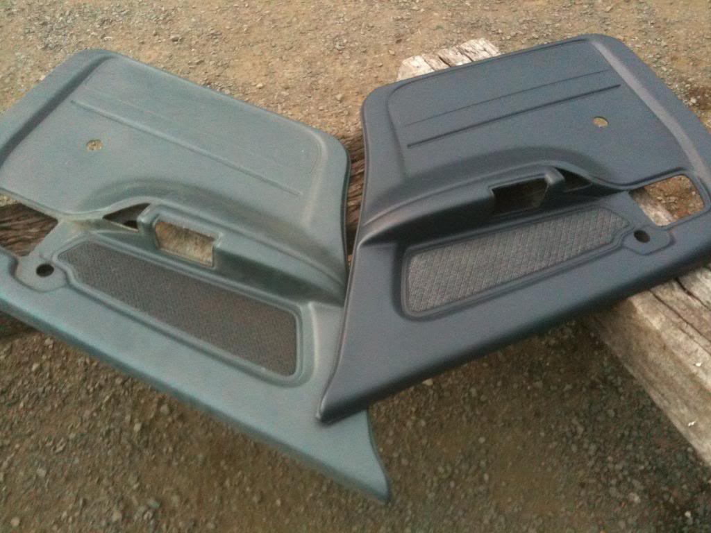

one door trim restored.

The door trim turned out great, did you just use vinyl paint or something else?
Posts: 8600
yes vht vinyl dye. its proving to outlast the vacationer so far.
it actually is a dye not a paint. there are solvents that dissolve plastics and vinyls and the dye mixes into them and when the plastics and vinyls set again the pigment is embedded in them. It doesn't sit on top like paint, it becomes parts of the top layer of the material.
its evident because it does not build, even 7 coats does not build much are all. its also comes up different shades depending on the plastic type, vinyls come up darker and shinier. and its supper watery and drys in seconds and smells like port as its mostly solvent, probably MEK and probably ethyl acetate as well cos it smells like it
because its a dye, it only works on plastics of soluble type in solvents like acetates, ketones. ABS is like the best plastic to use it on, which 90% of these holdens interiors are made from.
oh and also its completely flexible as its part of the material once dry.
