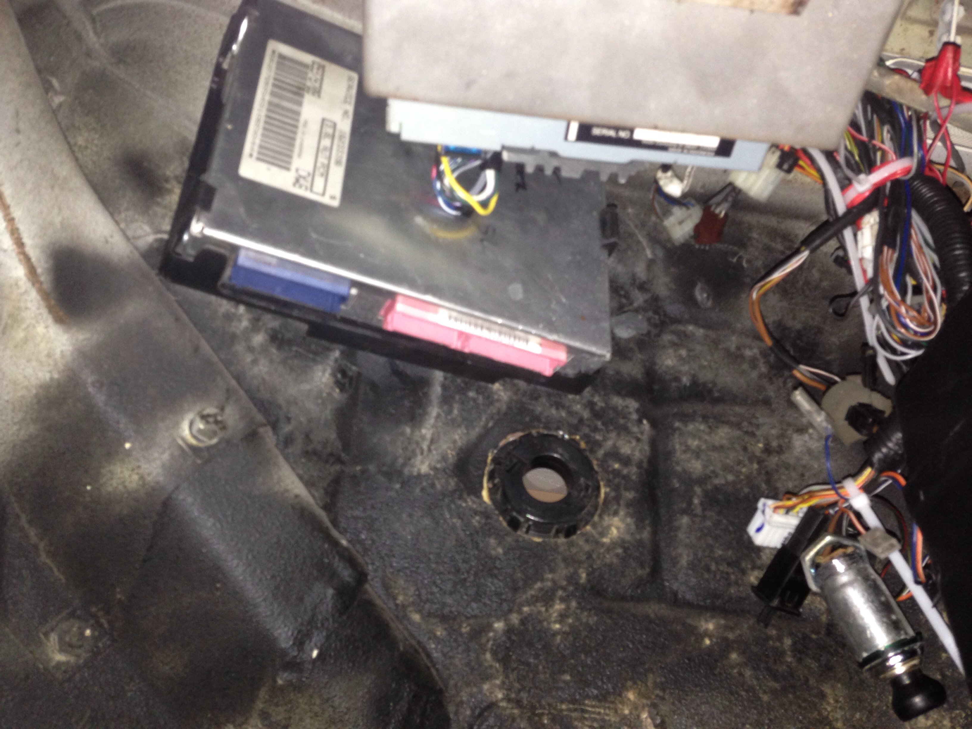

see the frame 40,58,86,AE,06,2E .... that frame is from the BCM and it means you do have a valid key in the ignition. without a valid key that message will have FF FF FF in it. how certain are you that this is the exact PCM that matches the BCM and key?
have you tried flicking the key from the off position right around to start as quick as you can turn it? if you turn it fast enough it will crank regardless of anti theft.

With the above photo I can't actually tell if I have connected properly

Jayme wrote:see the frame 40,58,86,AE,06,2E .... that frame is from the BCM and it means you do have a valid key in the ignition. without a valid key that message will have FF FF FF in it. how certain are you that this is the exact PCM that matches the BCM and key?
Haven't been home yet so haven't spun the key quickly. Must admit I do always wait to hear the fuel pump spool.
The PCM and BCM are from different cars -the PCM is for a 5L V8 auto and the BCM is from a 5L manual (as is all the wiring). I thought only the key and the BCM had to match?
Or does the PCM have to be from the same cylinder trans combo?
