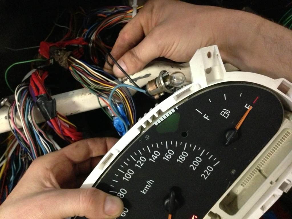

Its an Auto, Complete harness removal from the VT into the FC from headlight bulb to taillight bulb is what I have done.
ECU and BCM with matching Key all installed. Press unlock and the security turns off, insert key to accessories and dash lights up and fuel pump engages. One more click and the starter relay kicks but there is nothing from the starter motor. Three earth points on the engine checked and earth to body on drivers side engine bay.
ABS and SRS have been removed and fuse removed to disable. Bridged 5&6 pins to reveal repeating "12" codes only except on one occasion I got a 31 but it cleared after I disconnected the battery. Ran the ALDL cable in it and laptop recognises the cable and receives chatter in the efilive program but OSE tool wont see the ECM. TunerPro recognised it too but did not send any information from any sensors.
Checked it was in Neutral and even earthed the black green wire that runs to the traction control switch near the gearshifter to see if it would help.
I changed the ECM then changed the memcal and back to original ECM with other memcal. I have two sets of BCM and matching keys and tried those combinations too....

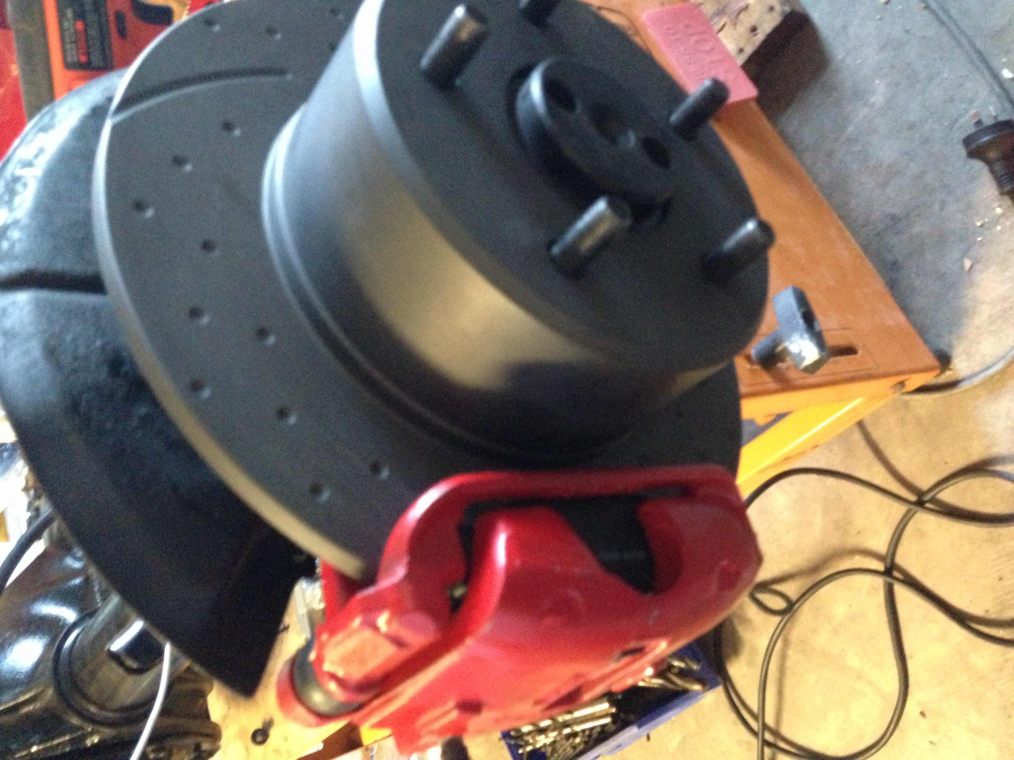

I'm going for the sleeper look and retaining the Column shift and Bench seats but to fit discs all round I have had to ditch the 13" rims and go 15" on commodore stud pattern - Running a VS LSD shortened and VS calipers all round on VN V8 drilled slotted rotors with VT Booster and master for extra push.
ONLY way it'll look non standard is the 8"wide B45 Simmons with white walls and the noise 8-)
It has to run custom extractors and has the 195i chip on a lazy 4L60E pushing 1100kg should equate to something like a 210kw Astra.
CORNERS WILL BE TAKEN SLOWLY!
