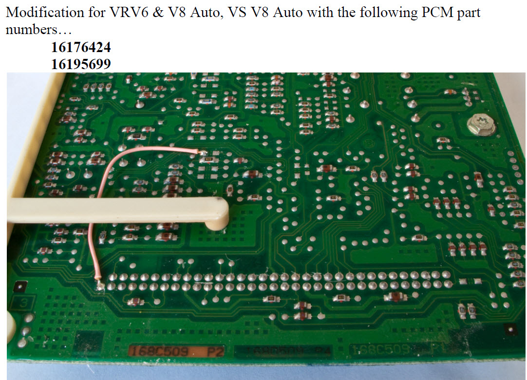

Could someone post up a pic on where to solder the wire for the NVRAM write line on a 424? When I brought my NVRAM 11P was not around.
I have 2 424's here, might solder one up and sell it off and keep one for "one day". I did look in the 11P zip but didn't find anything.
Any help appreciated.
Re: OSE 11P V104
it should be in the nvram setup doco ?

I didn't get any instructions I brought the board assembled.
Re: OSE 11P V104
424 jumper.jpg (221.33 KiB) Viewed 10254 times

Thanks mate
