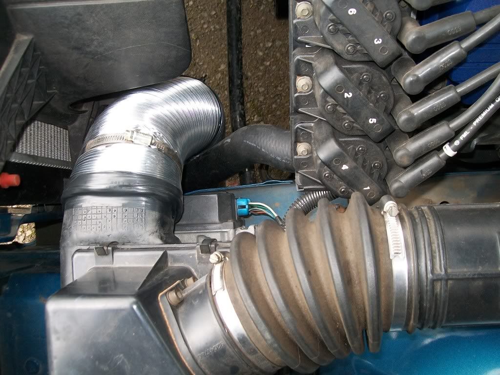

here is my first one, rather a remake of the power loosing otr. Cut the adapter and plastic welded it upside down.

On Big G's VH I tested this, engine does not care if you use that bellow or not. In fact I bent it almost 90o during a run and another run I pushed it tight together and straight to make it smooth inside and noticed nothing conclusive.TdracerTd wrote:And get rid of that concertina elbow. They are horrible for flow.

Yep, that would work much better than OTR. One thing that always worried me was water, it gets very wet here sometimes but I haven't every hydrauliced the engine although once I checked and the filter was wet.

I won't argue if you have dyno results to prove. But to me all you have to do is look at that thing and it makes me feel sickly.vlad01 wrote:On Big G's VH I tested this, engine does not care if you use that bellow or not. In fact I bent it almost 90o during a run and another run I pushed it tight together and straight to make it smooth inside and noticed nothing conclusive.TdracerTd wrote:And get rid of that concertina elbow. They are horrible for flow.

yeah I was surprised too, not that I was testing the specifically, was interesting since I was watching the dyno screen and bending the elbow over and it just kept on going like nothing was going on.
It will probably gain power slightly when stretched out lol, as that was the trend the dyno was showing, longer pipe, more power for this engine combo.

Yeh, on the subarus I work on, second thing we do is get rid of a piece just like that, they call it sfb (short fat bit lol) along with changing the turbo inlet pipe. I don't think that a smooth constant diameter elbow would flow any worse, and looks alone would be reason enough for me to want to change it.

Im going to change mine at the airbox for the sake of it but the one at the TB I will leave as it is straight and won't effect smoothness of the flow.
That one needs to move anyway as the engine twists in place.

I would think total airflow would have an influence on it.TdracerTd wrote:Yeh, on the subarus I work on, second thing we do is get rid of a piece just like that, they call it sfb (short fat bit lol) along with changing the turbo inlet pipe. I don't think that a smooth constant diameter elbow would flow any worse, and looks alone would be reason enough for me to want to change it.
