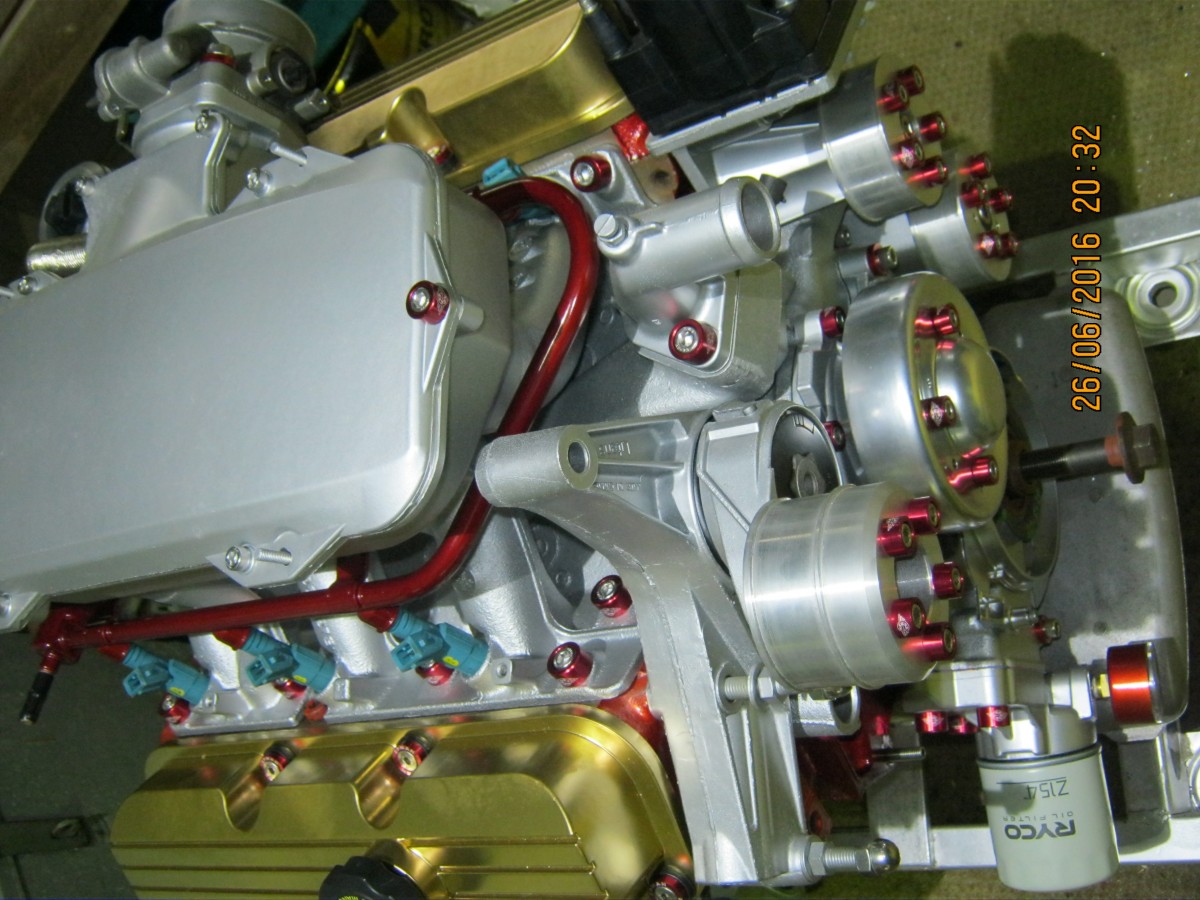

S/S SHD BOLTS WITH ANODISED CUP WASHERS THROUGHOUT....
I had a good look and Can't see any split seals..

Does anyone see CAM Bearing problems in these engines..?
i have rebuilt several with obvious oiling problems in the middle cam bearings...
lack of oil and spun bearings..... this seems to be a common problem ..
the coloured cup washers do it for me.... nothing wrong with bling...
dosn't everyone have a toy SC V6 Gennie in their cave ..?

Vr model buicks were bad for the centre cam bearings coming loose and taking out the middle bigends too.ive had a couple of vrs that you couldn't get the cam out of cause the bearing had come out and sat on the shaft and wouldn't let it out of the next tunnel bore lol.
- Posts: 8600
Re: Generator Idle
I have seen it once on a vn of my boss from when I did a work placement program through school. It spun and spit out of of the middle cam bearings.
Common trick I see as more of a precaution by the good v6 builders in the know, is to drill through the top of the block in each cam location and tap for a pinning grub screw. You know those Allen key grub screws with a dowel pin like end? And that pins the bearing in place to prevent them slipping and spinning in case of a dry start or momentary loss of pressure.

i have one v6 that spun the cam bearings and chew'd out the block... found the bearing bit's in the sump and oil pump etc...
im thinking of running 1/8 steel line from a manifold off the pump and drilling extra oiling lines to the cam...
however ... i like the idea of pinning the bearings......
