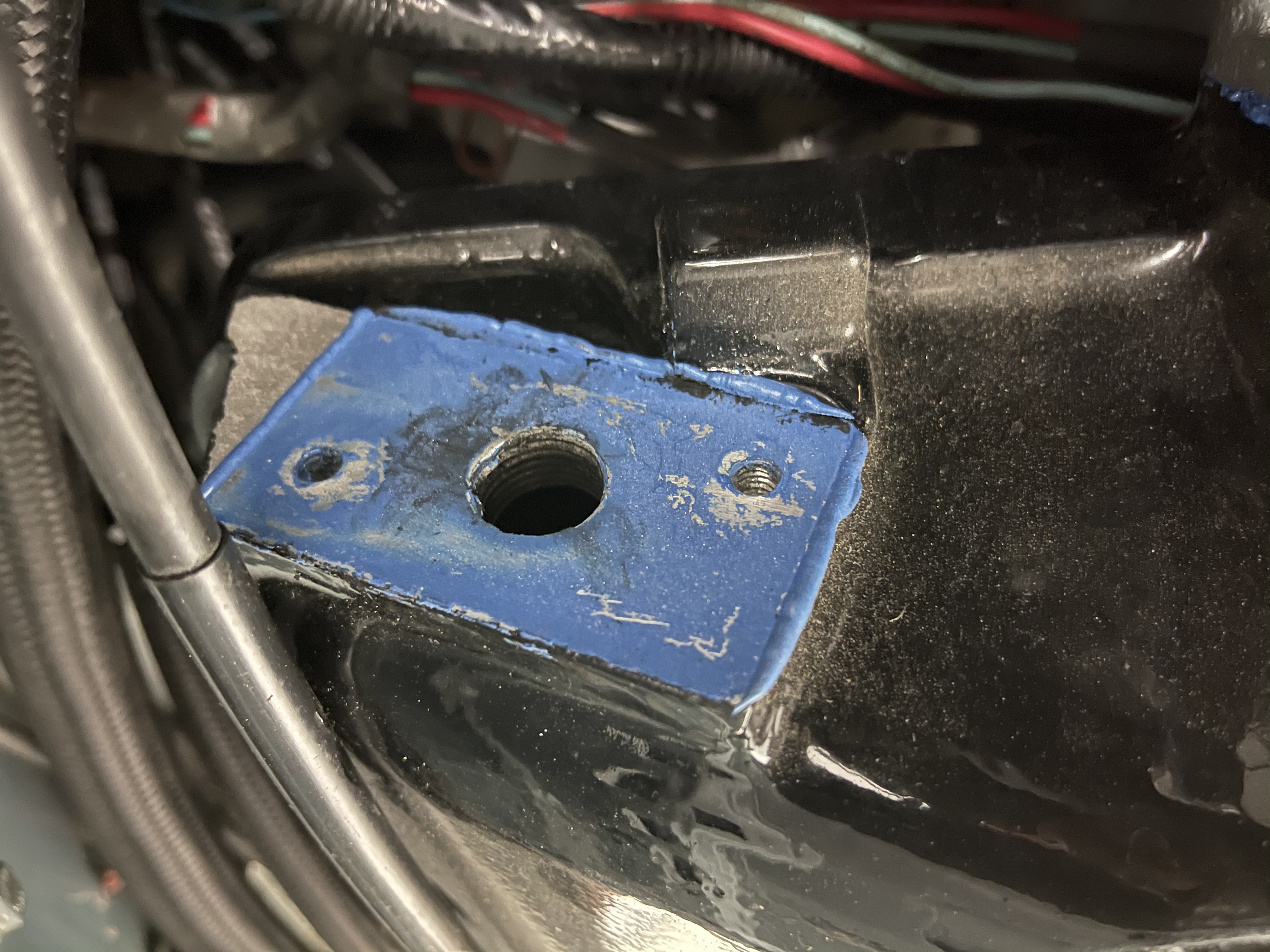

After pulling off the IAC block. I just realised that the previous owner was running the MAT sensor in it and had drilled and tapped it. Now I’m trying to find out what it’s true size is. If it’s smaller than the block hole this would explain a lot.

Are you sure it's smaller. If it was a provision for the IAC it would be the correct size? Just tapped.
Be prepared for some trial and error. It will likely be a matter of balancing some throttle cracking plus the correct sized hole for your needs.

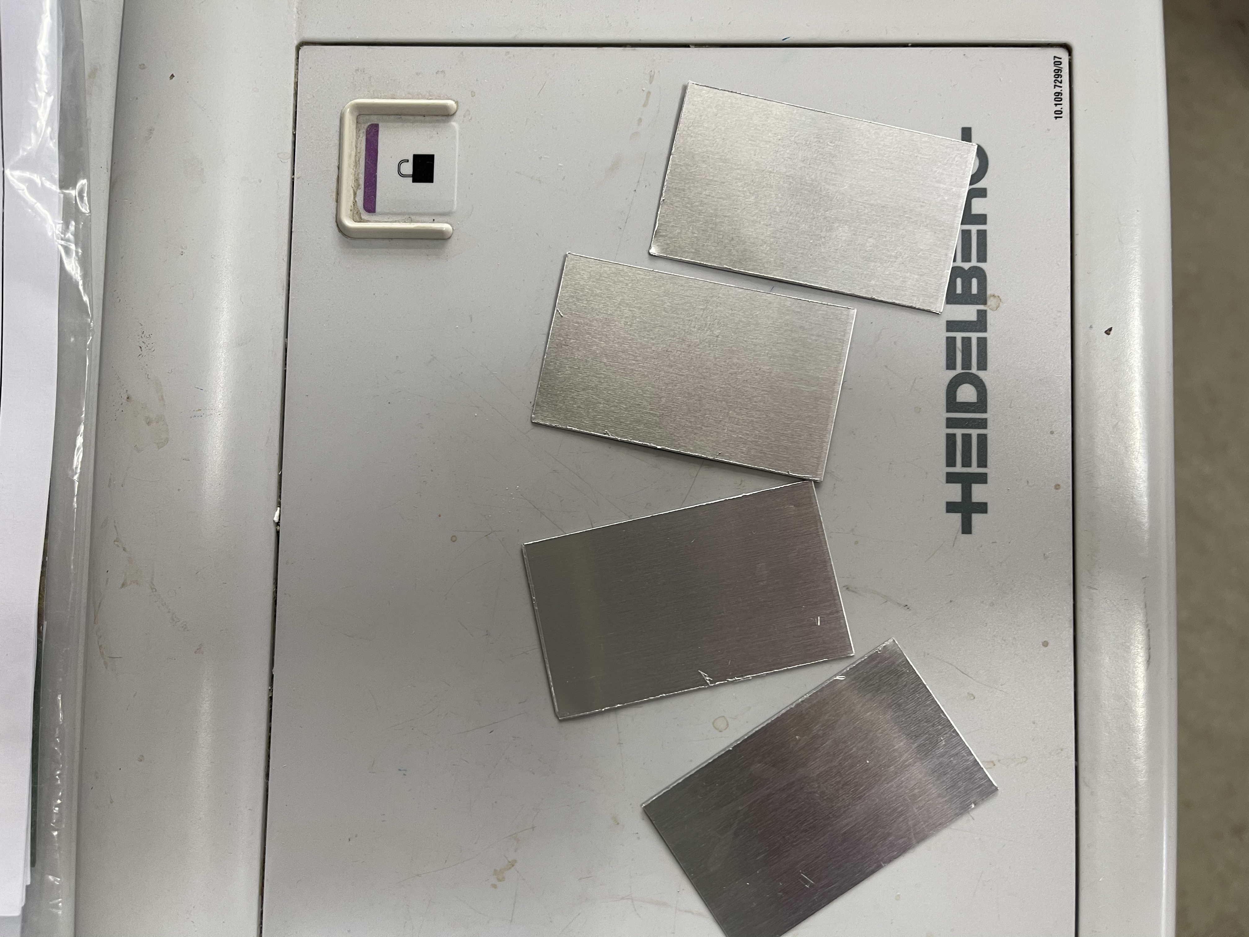

I’m a production manager/commercial printer. We have lots of used aluminium printing plates. So I’ve cut some templates out and will punch different size holes and give them all a go.

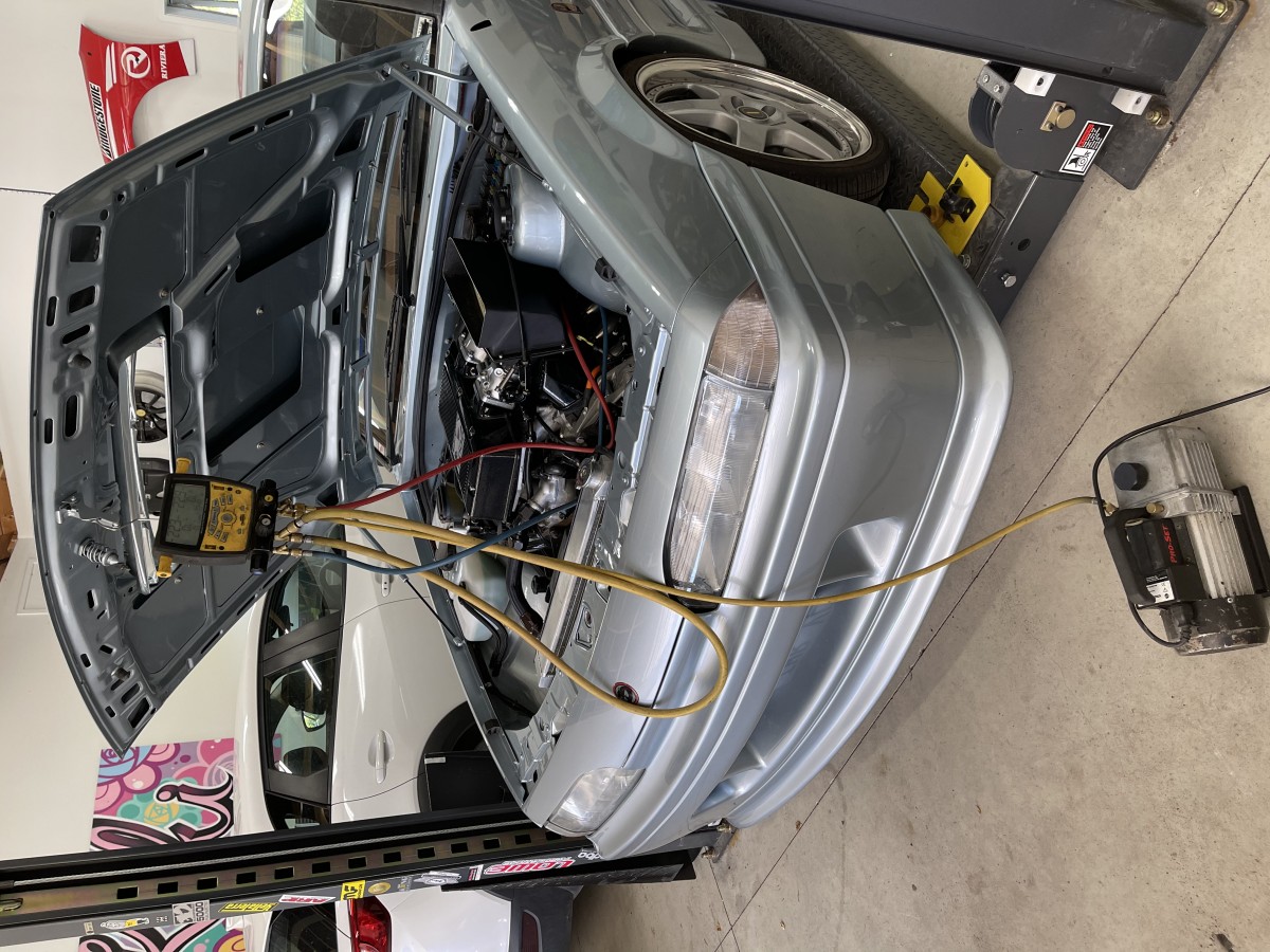

One thing I noticed today was it will punch up a bit in revs when the air con is first switch on and the clutch engages. Then the IAC will slowly bleed down. Which then cause the revs to drop quite low. I’m going to contact the A/c guy and make sure the gas pressure isn’t too high.
