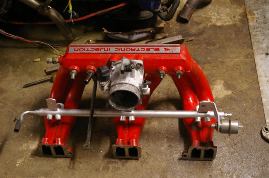

yeah been having a nosey round im j-piping the headers that are on it for testing

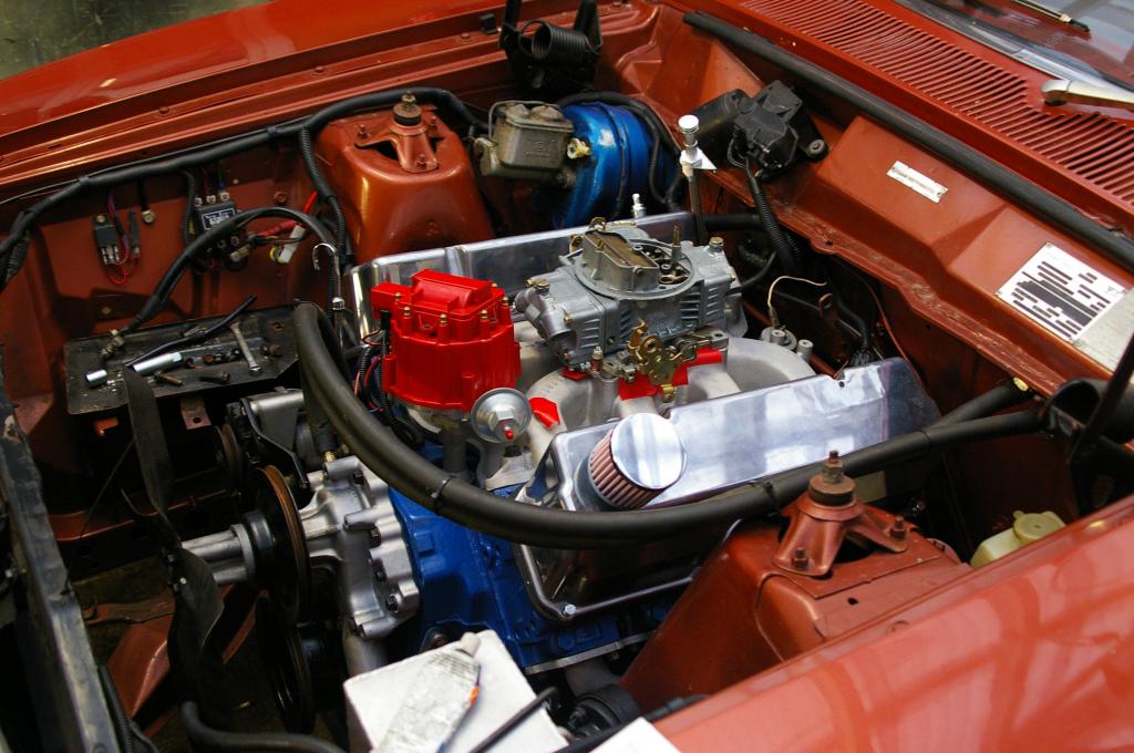

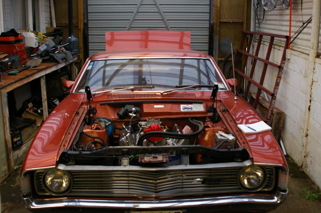

not every day you get an XA fairmont coupe in for work LOL.in for engine dressup and final assembly and cam run in its a total fresh new 351 clevo and C6.i get to spend someone elses money buying all the cool bits to get it finished.also have to build driveshaft and exhaust and fit the boot full of parts.

are you planning to run the TB like that ? I've found if you cut the bar off on the centre of the fuel rail (the one that the wiring clips into) then you can run the TB up the other way which should make accelerator linkage easier!

i dont have the vehicle here so im mocking up as i go then will have to go check bonnet clearance before confirming which way up the TB will go.its manual M20 4 speed

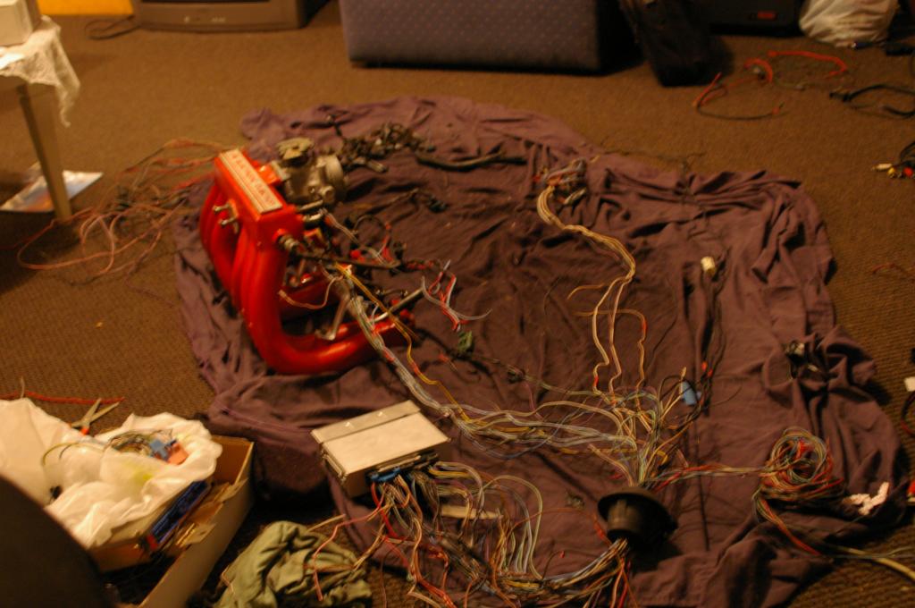

todays antics convert vr auto v6 loom to 202 808 loom LOL nearly ready to tape up
