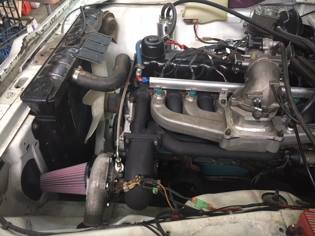

Here's a pic of the turbo install coming together. Still need to plumb up the intercooler, oil return, and lithium battery among other things. Oh and new 3" exhaust required.
Re: 265 Hemi to efi
You might want a bigger filter than that. Its going to chock the shit out of it.
Apart from that, everything else is looking great.
heff0018
Posts: 1045
Re: 265 Hemi to efi
Post by heff0018 »
vlad01 wrote:You might want a bigger filter than that. Its going to chock the shit out of it.
Yeah thanks, need to cut a big hole in that front panel and get a decent filter and cold air setup going.
Re: 265 Hemi to efi
oh and you might as well go to a thermal fan and have the 808 control it at some point.
heff0018
Posts: 1045
Re: 265 Hemi to efi
Post by heff0018 »
vlad01 wrote:oh and you might as well go to a thermal fan and have the 808 control it at some point.
I have EL falcon twin thermos at home that are on the install list.

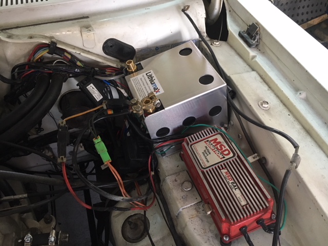

Looking good. Tell me about the Lithium battery.
heff0018
Posts: 1045
Re: 265 Hemi to efi
Post by heff0018 »
Charlescrown wrote:Looking good. Tell me about the Lithium battery.
It is small enough to fit where the old washer bottle was located (which is just left of the MSD box in the pic), they are quite light and you can mount them in any direction. Not cheap though.
heff0018
Posts: 1045
Re: 265 Hemi to efi
Post by heff0018 »
The lithium battery is installed and weighs in at a mighty 1.6kg
