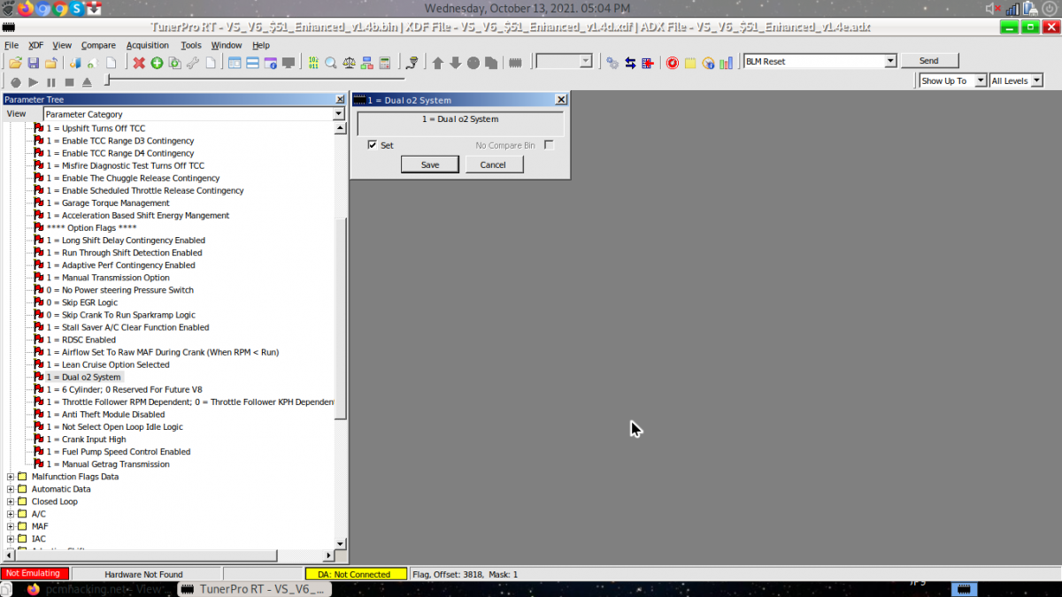

Hi all, I'm about to tune my VS V6 with EnhancedMod and have got 2 Innovate Wide Band O2 sensors so I can monitor AFR/Lambda as I drive. The only question I have at the moment is. Can I use both pin A5 and B10 to tune with both widebands or does EnhancedMod require that I keep 1 narrowband operational.

you can use both A5 and B10 for widebands, just change the adx parameters to suit. If you check the flag single o2 sensor then just use the 1 narrowband on the drivers side.

The1 wrote:you can use both A5 and B10 for widebands, just change the adx parameters to suit. If you check the flag single o2 sensor then just use the 1 narrowband on the drivers side.
Is this the one you are referring to?
Posts: 4853
Re: The1's Enhanced Factory Bins
yes
