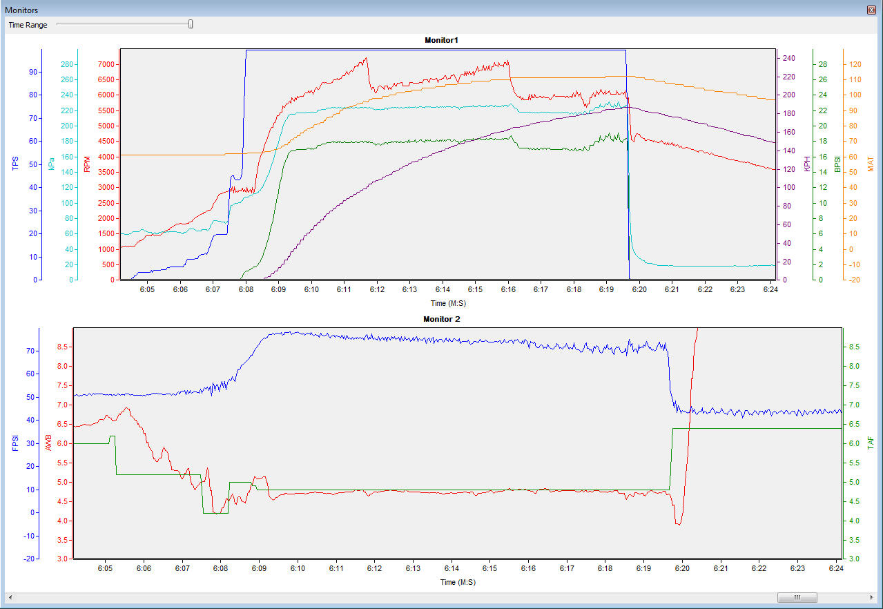

oh and heres you log Delcowizzid
im pretty happy with the fuelling

gee thats a nice odd rpm spike in the middle of third gear... and the boost had noticably dropped off until that point then spiked back up
fuel pressure bit wobbly in third too ! spot on on the wideband tho
- Posts: 8550
Re: My Delcoed Rides
The rpm looks spiky all over. I thought rpm would be a smooth curve except in traction issues like going over bumps and shiny spots on the road.
that is smooth compared to the reluctor dizzy trace it used to have
That is a strange RPM drop, but the boost is really odd with it never recovering after the 2-3 shift until after the RPM drop.
