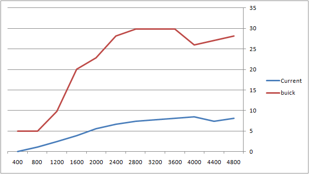

id say thats because the ecotec spark tables of Holden202s are way too low to be using on a buick. that will be making it read a bit so rich coz its so retarted at wot.
look at the table below, both of these are petrol tables, one for ecotec (the current spark at wot) the other is a petrol buick table. you want to go even higher again than the stock petro buick table by minimum 5 degrees.
I rekcon when holden202 puts in some buick tables and checks over the bin it should run much much better

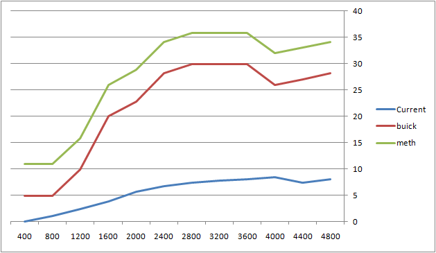

Re: Using Holden202's $12P Methanol Tune In A V6
so this is the new methanol wot map inthe bin that holden202 just posted up. as you can see, the blue line is what spark you were running, the red line is the spark ATFY has and the green line is the new methanol spark map.
