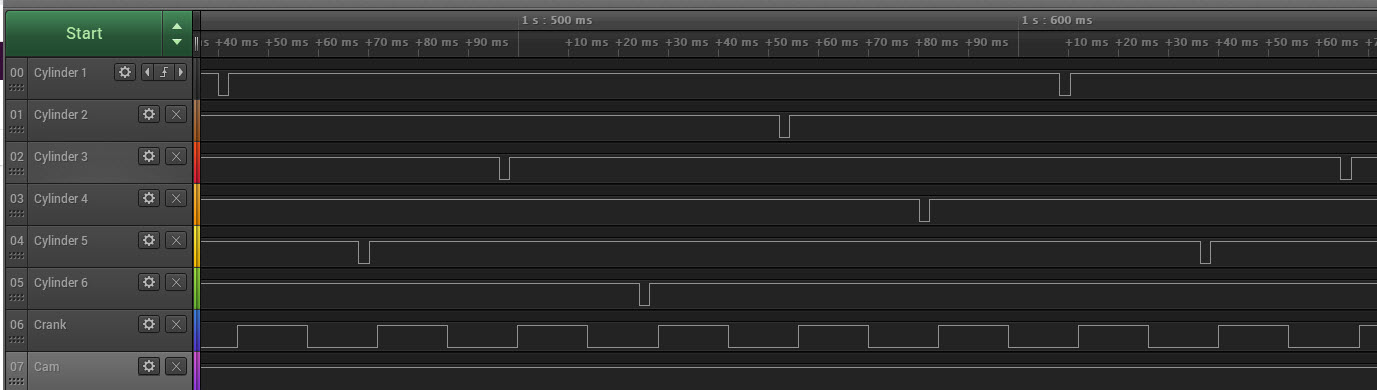

so i knew the DFI module was ok as i scoped its input and outputs, so i decided a good way to test was to get an ECU on the bench, wire in what i needed to see all the injectors and crank/cam etc signals, i then programmed up an arduino to make a 60 degree on/off signal, and after every 360 degrees change the cam from high/low etc ...
as you can see below, the crank signal is a perfect on/off every 60 degrees, and that was showing around 750rpm in HPT - just for reference.

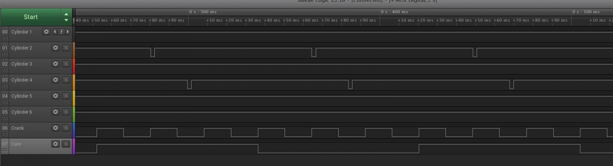

I actually did the below log first as i wanted to confirm i was getting a crank signal before i worried about the cam .... i found it quite interesting that above with the cam connected i was only getting 2 injectors firing and they were halfway between each cam transition.

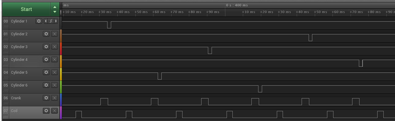

So as you can see below, without the cam signal i get all 6 injectors firing, and they are in the correct firing order for my 202 (when i wired it up i used the v6 firing order compared to the 202 and put the injectors in the right order to suit) - so seems i got that part right, and the two injectors not used are not ones i should have used so happy days.

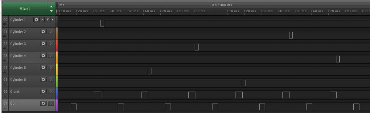

So this next one is basically the same as above but i used a 4mS trigger signal and then 24mS gaps between, again around 750rpm on HPT and cam signal not connected, when it was i had the same as the first picture.
