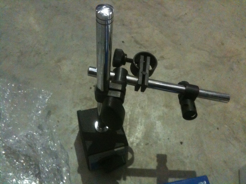

very nice dial gauge. its twice as heavy as the ones I use at work and got it for around 68? bucks.
0.001mm gradients. Made in Netherlands I think?

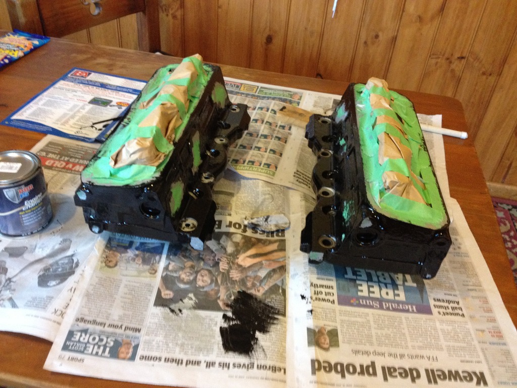

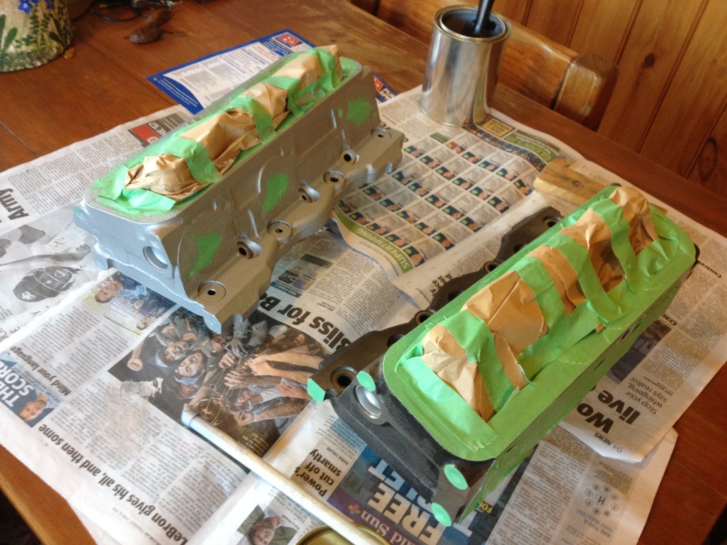

Got my heads prep'd for painting today.
Heating them up as the outside temp was only low 5s despite a perfect still sunny day.
First head primed in rust bullet. Seals it from rust and provides a surface for the POR15 engine enamel to stick too. The rust bullet can take more than twice the temp as the engine enamel :lol:
First coat of the enamel.
2nd coat and curing on the stove. The paint being so thick is an understatement. literally thick as treacle. its 70-80% solids. Difficult to brush on but does level out pretty good.
Note that I avoided painting in the bolt hole recesses and spark plug hole. Its bad news if you do given that the paint is so thick. Will touch them up once the engine is assembled
