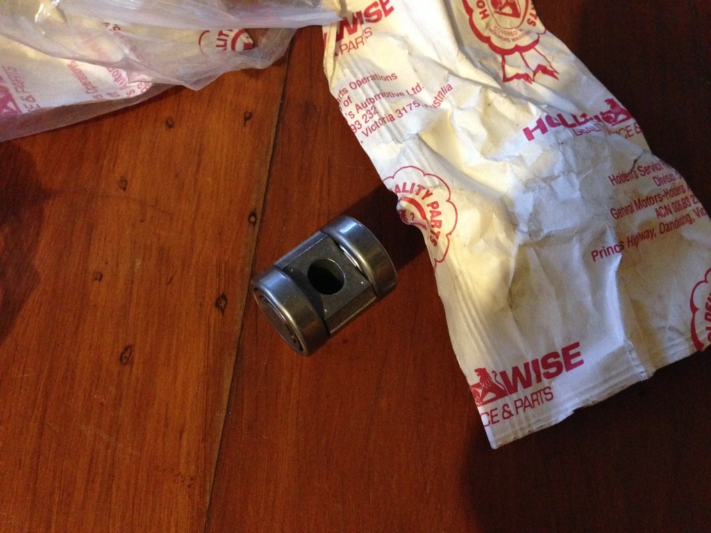

Got my pivots.

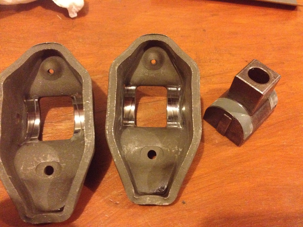

Good thing i decided to buy new ones than buying 2nds and rebuilding them. the bearing are peened on, so it would of been a royal PITA!
They are like the late VP pivots which are much taller than the earlier ones and also use the 5/16" thread not the 3/8" early engines uses.
The rocker arms look virtually identical but last night I found the difference the holden part numbers seem to suggest. The internal cavity of the rocker arm is smaller on the early ones by about 1mm. So the late pivots, non bearing and bearing type do not physically fit into the earlier arms.

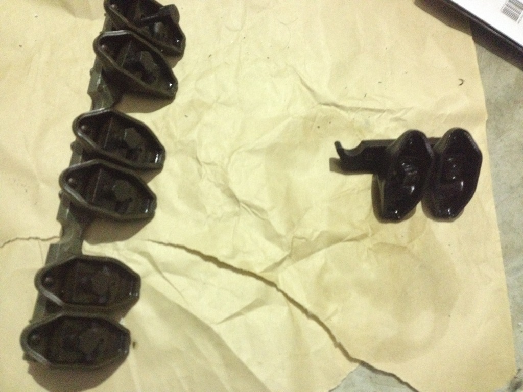

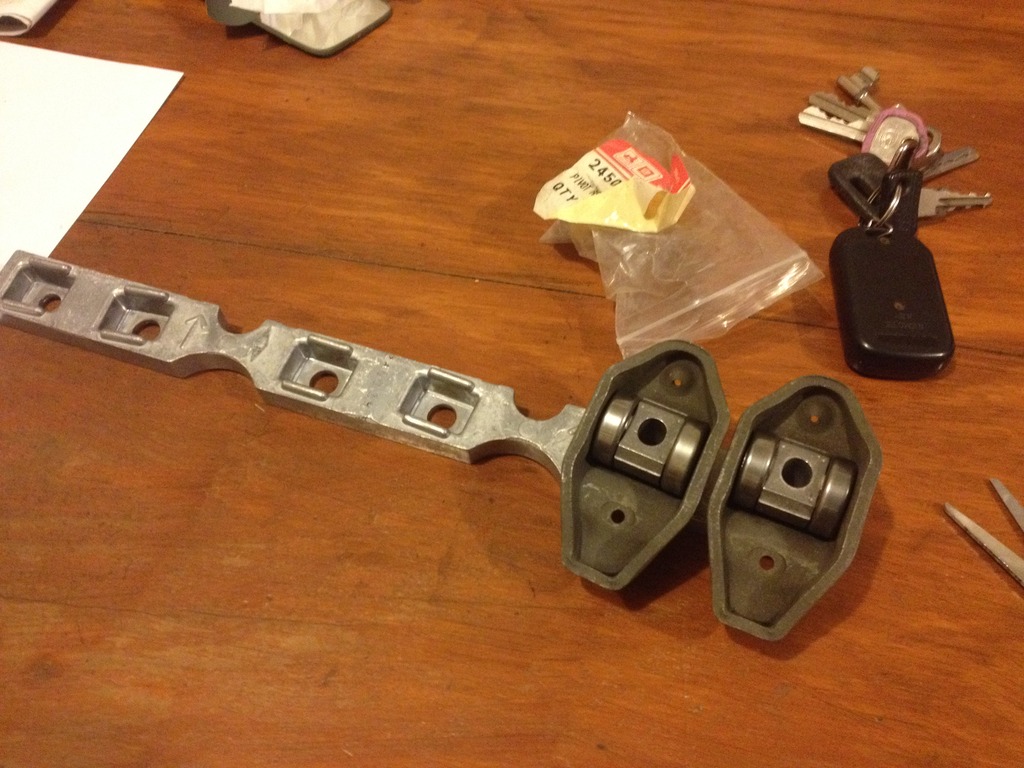

- Posts: 8600
left is late VP/VR style mounting plate vs early VP and VN pair plates.
in this pic.
lower row from left to right 1. VN/VP, 2. Late VP, 3. VR.
Top row of rockers. left VN/VP, right is late VP and VR.
pivot fits the late VP rockers as they are the same part number as VR.

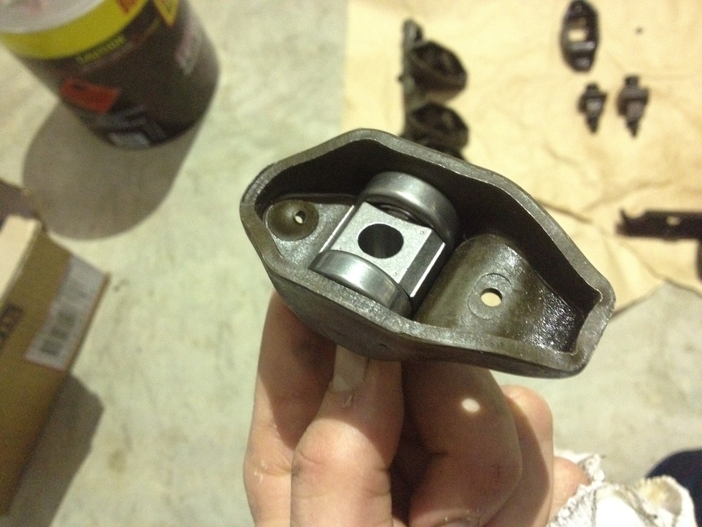

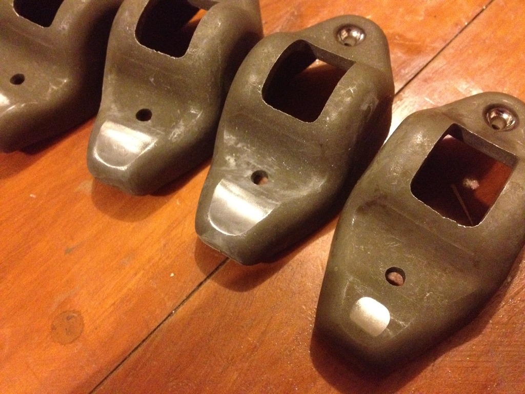

doing a bit of a clean up on the arms. I glued some 2000 grit paper to one of the old pivots to polish down the very small but sharp ridge on the wear face inside the rockers.
Left is unpolished, right one after treatment.
Just lightly faced the stem contact point, more too see how much wear. Bugger all! even after 400k. those that were faced only took a few rubs back and forth with 800 grit paper on a piece of glass. So the wear only went as far as the oxide coating really.

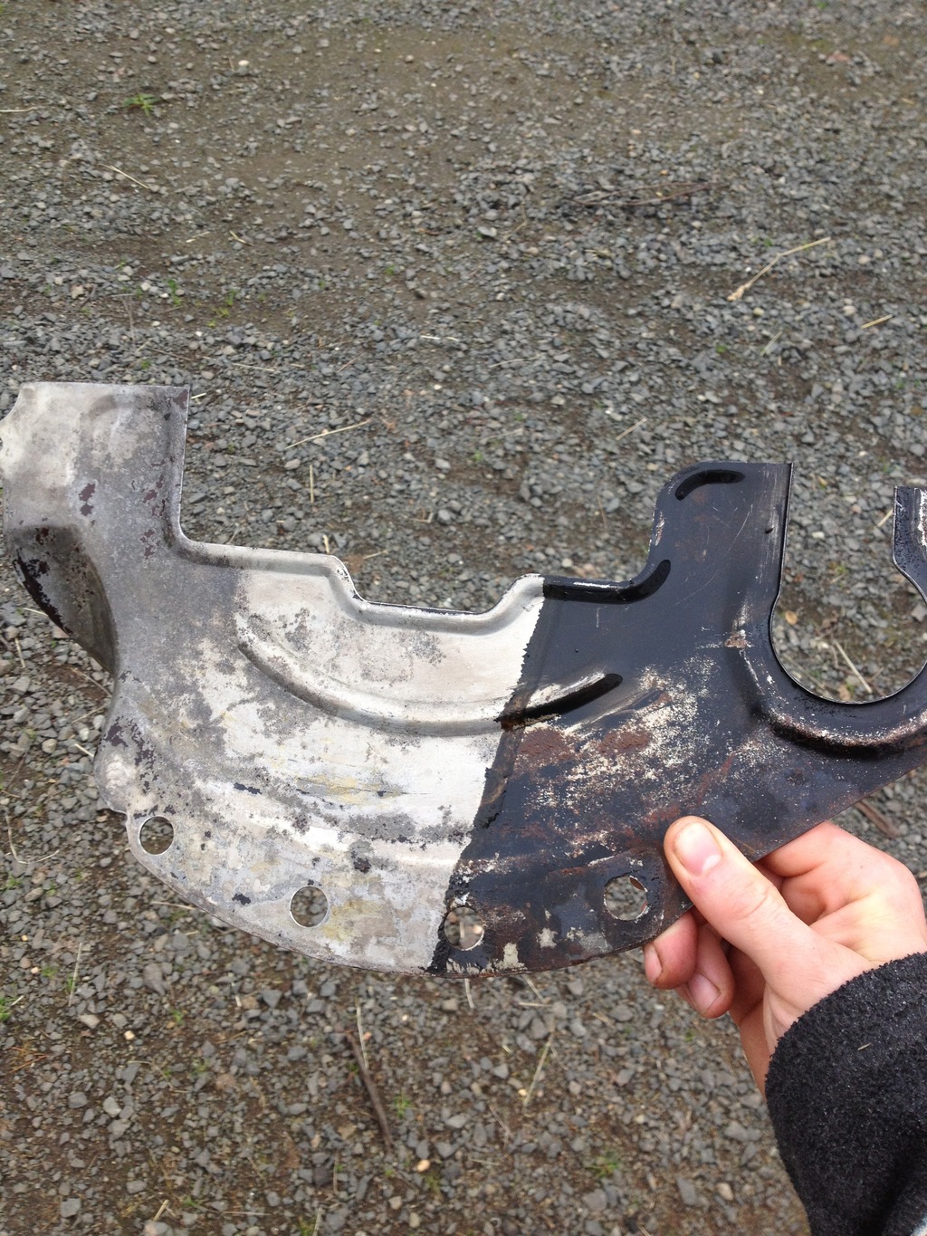

over night in a bucket of 1:10 molasses to water mix. Secret to get that fast action was adding an aquarium heater set at 32 ish C. otherwise at 5C it will take about 2-3 weeks. So I have given it another 4 days to get all the heavy rust patches off and turned it over to the other end last night. Had to add another 2L of water as it evaporated real quick with the air being so cold. It actually steams all the time coz its so cold here.
The beauty was the old paint just lifted off overnight!
