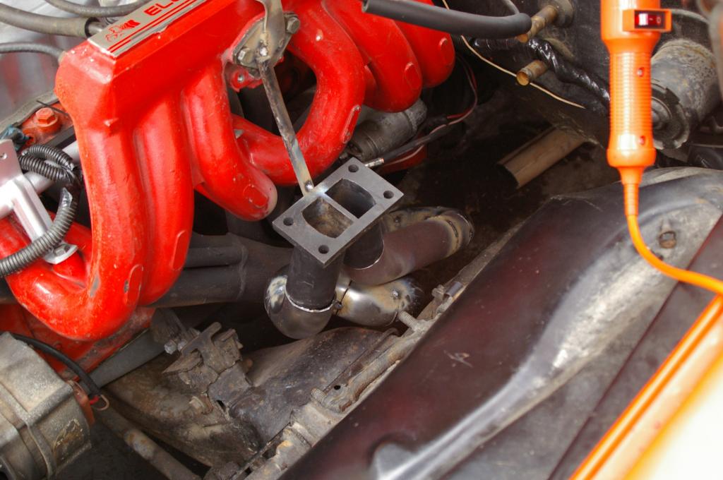

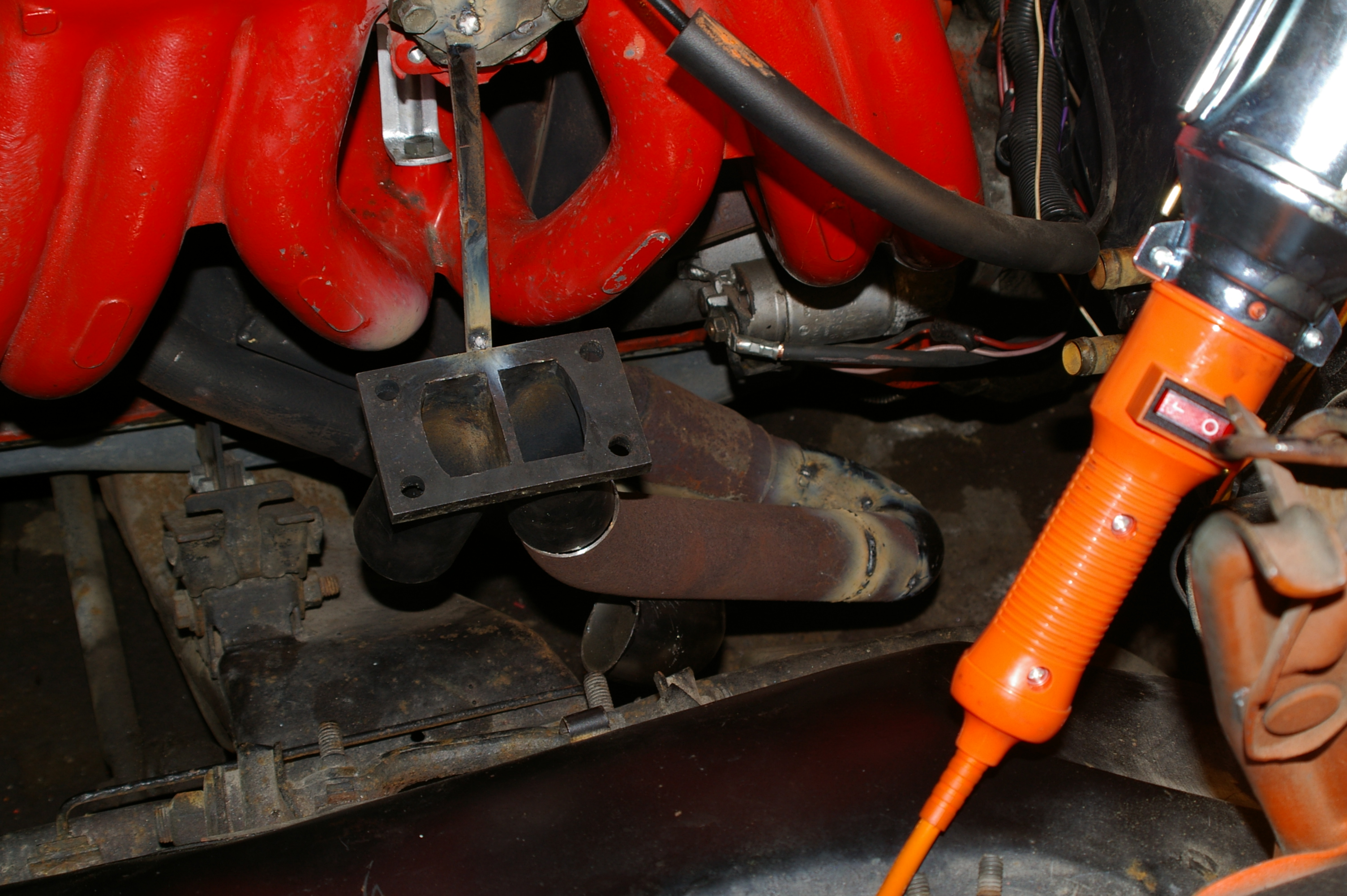

I love the EGR support bracket
looks like it will fit in nicely too with plenty of room for a dump pipe!
whats the plan with the waste gate ... out the side of the collector near the flange ?
- Posts: 5634
Re: DELCOS NEW RIDE
haha i needed all the help i could get holding multiple peices of pipe together with 2 hands meant i needed that dodgy tempory bracket to hold the collector.yeah wastegate is next and will be run off 2 seperate pipes one off each collector entry pipe merged into one but split in half all the way upto the valve face inside the wastegate flange so it keeps both halves fully seperate untill the gate opens
.both secondaries are the same length as the genies were originally so once on song and the gates open it should just flow like headers to open exhaust.if anything the secondaries are even more tuned than before turbo hope it doesnt change the note grrr
Re: DELCOS NEW RIDE
I doubt it will man, my motor didn't really change note, just gets more cranky when on boost and the gate is breathing

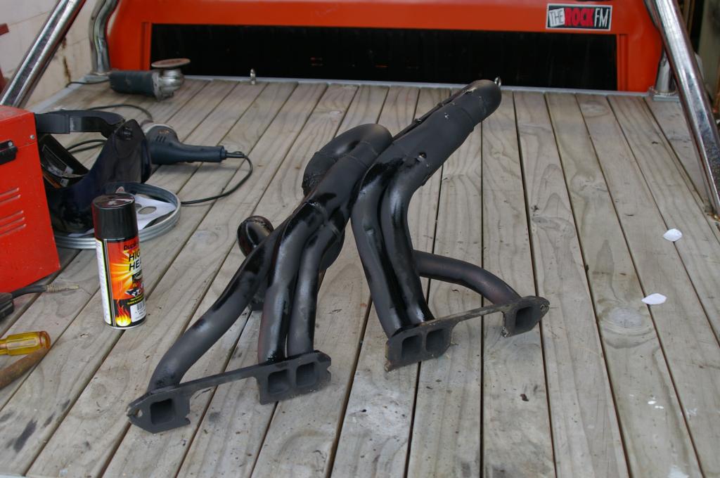

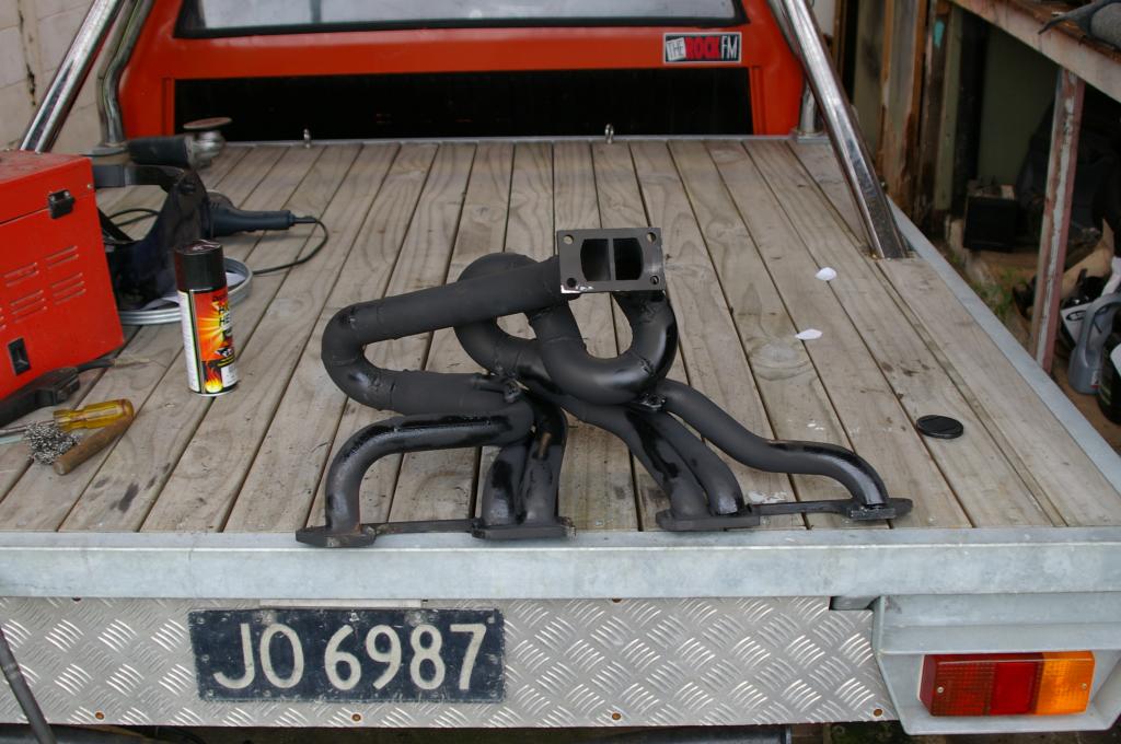

Re: DELCOS NEW RIDE
headers done bar wastegating and a few braces

Re: DELCOS NEW RIDE
cooked the paint and cleared the crap out LOL
