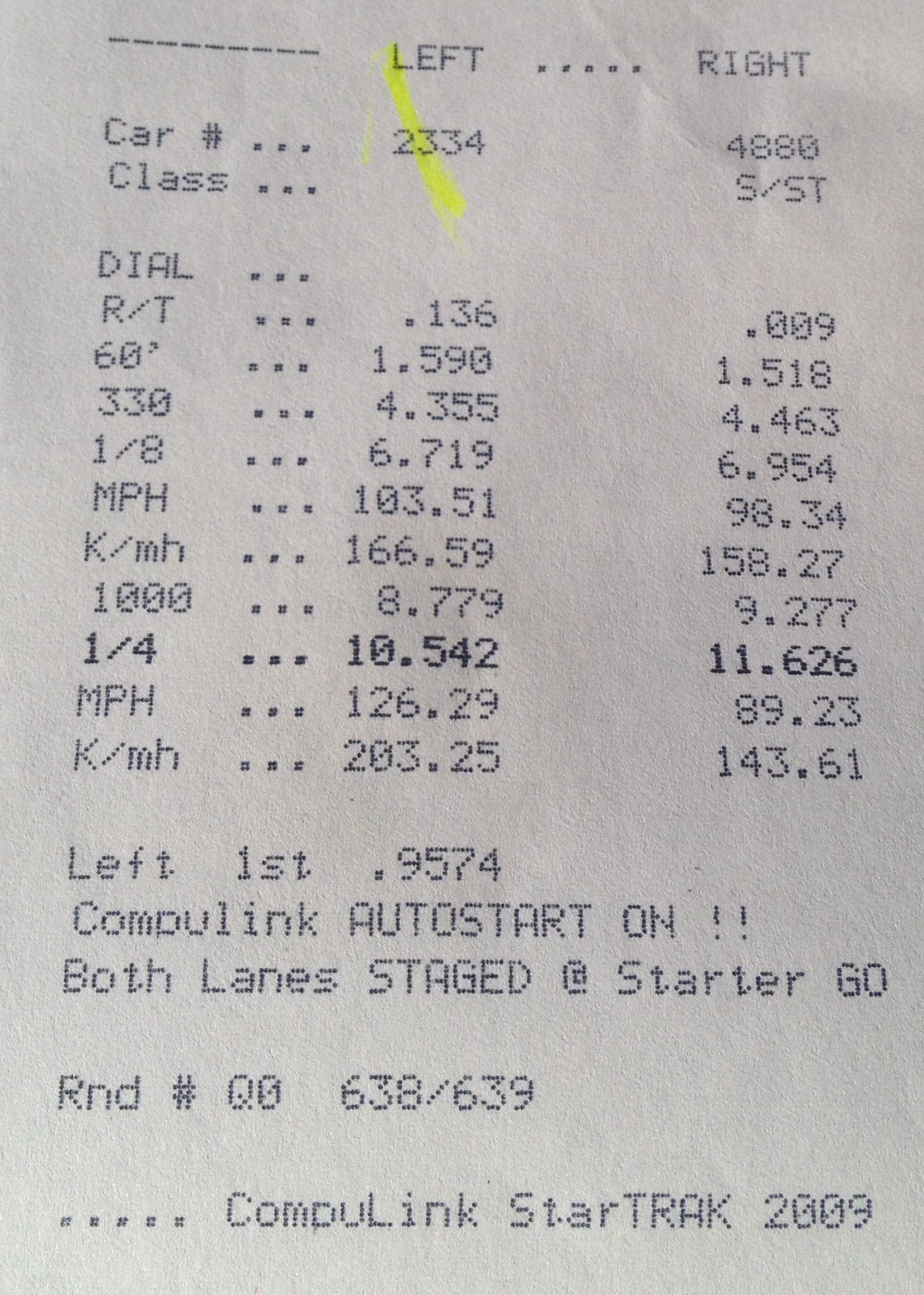

staged early cause old mate was slow getting out of the burnout and to the line etc, had it on the two step rev limiter for like 10 seconds, if thats not max boost off the line nothing is hehehe .... launched nicely, then on comes the boost and we are just g-forcing it up!! felt really good, started to catch back up to old mate, and then second gear just kept going strong, clicked third and ooohhh yeah no missing still pulling hard, and i knew it was going to be in the tens!
driving down the return road pretty happy everything just worked ... get to the tunnel and andra person pulls me up .... is the car teched - yes, do you have a suit - no, well your going to have to pack up mate you just ran a 10 .... hell yeah buddy happy to put it on the trailer :D
i knew it definately had a 10 in it but i was thinking 10.90 or something, when i saw the time slip i couldn't believe it!!

That 60ft! Damn. Mph means there's heaps left in it top track or did you run out of gear? Congrats man, such a great effort! Just rockin out :punk:
Posts: 10436
Re: My Delcoed Rides
yeah its got a 3.08 diff in it, I so wish I had the logger working so I could see exactly what rpm it crossed the line! probably could safely go to 3.45 but not sure if I could go much more than that without seeing numbers but was definitely still pulling hard across the line for once hehehe
the 60ft is heaps better than before, I think it was 1.74 or something so took a lot off it!
