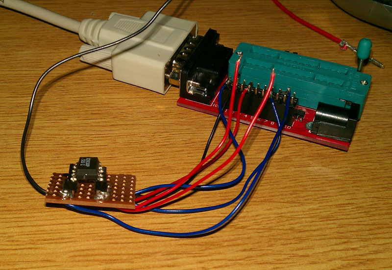

Sorry im new to all this still learning lots, i made up this socket with a header on the other end.
this is the pinouts for icsp?
http://www.batsocks.co.uk/readme/isp_headers.htm
So ive got iscp - chip
pin 1-3 di
pin 2-8 vcc
pin 4-8 gnd
pin 7-2 clk
pin 9-4 do
ce read store pins 1-6-7 need to pulled high, this means 5v to make it active? pull low would then be 0v?
Dr Bob, thanks for posting the pics!!

yes - high = 5v (via 10k resistor if possible) but the CE line can't be tied high - it needs to be pulled low between each instruction.
i.e. to read word 0:
pull CE high
send bits 1000011x so high DI, high clk, low clk, low di, high clk, low clk, high clk, low clk, high clk, low clk, high di, high clk, low clk, high clk, (last bit can be 1 or 0 so di doesn't matter) high clk, low clk
(that's the read instruction sent, now read data one bit at a time) read do, high clk, read do, low clk, high clk, read do, low clk, high clk, read do... until you've read all 16 bits
Then, low CE, and do it all again, to read word 1 is 1000111x... you get the idea ;)
The CAT24C44 datasheet doesn't explicitly say the CE line has to be cycled per instruction, but alludes to it in the timing figures.
The X244C44 datasheet does spell out this requirement though.
I can't see any way to control CE via ICSP (maybe reset pin?) but I can try mine with CE tied high and see if it still works...

I just tried a read with CE tied high, no go.
It will need to be switched per instruction. I checked the schematic for that DOS based programmer I posted a while ago, and it controls CE rather than tieing high too.

According to http://www.nbglin.com/download/eeprom.pdf the CE is pin 3 on the J5 header and active high (if that's the same as your board).
You'll also need to set the 24Cxx jumper to off, and 16bit on the other jumper.

yeh that seems to make more sense as i wasn't even getting 5v where it said on that other one i found, ive resoldered the wires and quick checked some of the circuit again the top left of that sheet and looks more promising, ive done a read now with the recall pin high and now im getting something.
