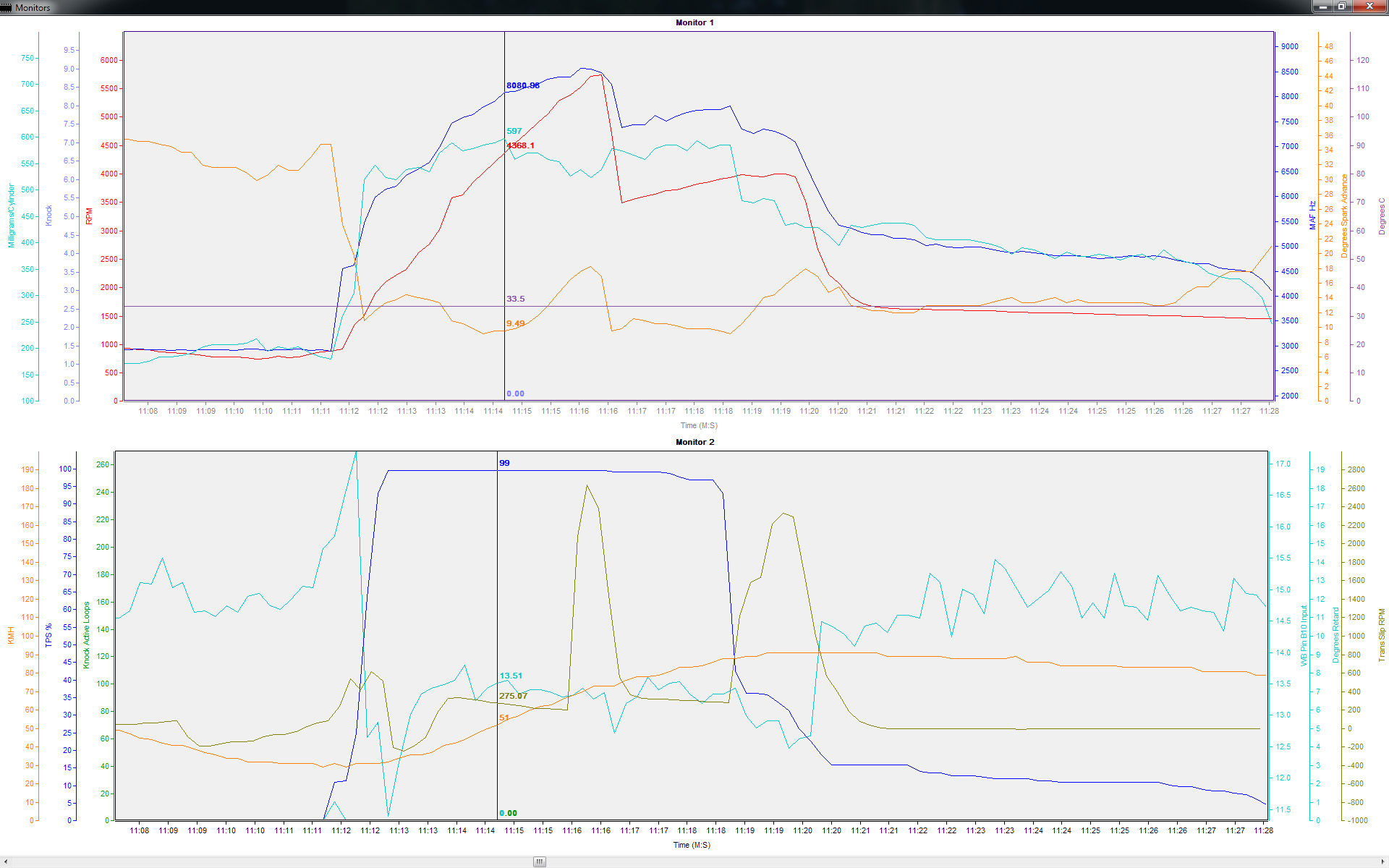

Having a play with knock AD output in the datastream, will be testing again with a few degrees less spark and see how it repsonds and monitor cylair/maf etc, if all goes well should come in handy for spark tuning and tuning the knock system addon times, ignore times, recovery/attack rates. Also should have two spare inputs with full 0-255 range for Wideband or another input. Should be able to do it on all models.
Orange line on WOT is Knock AD

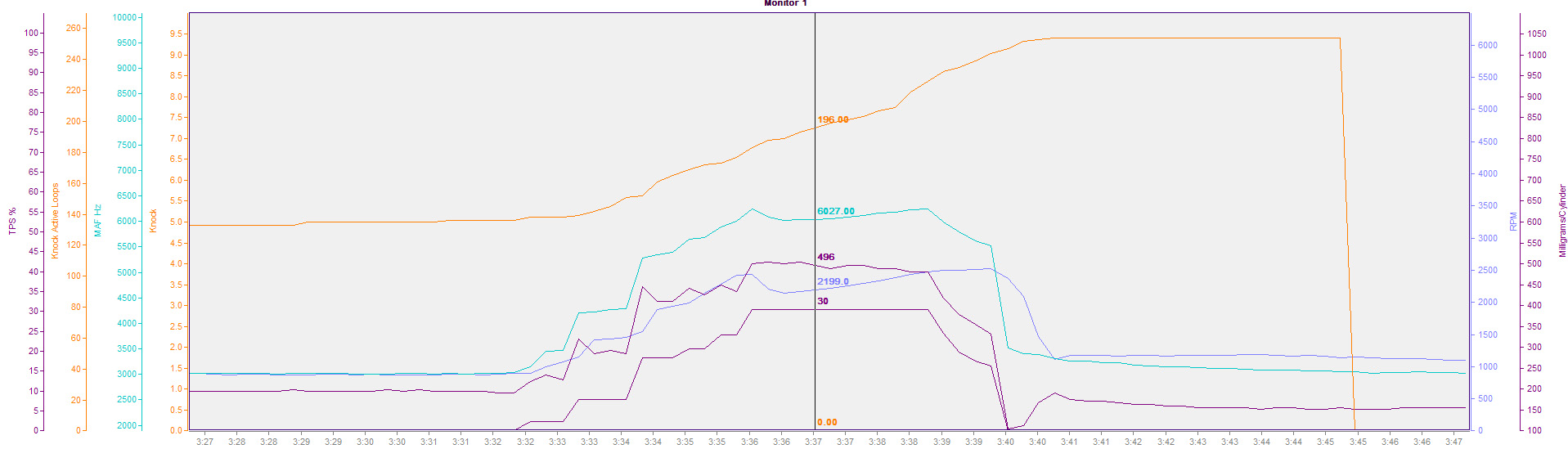

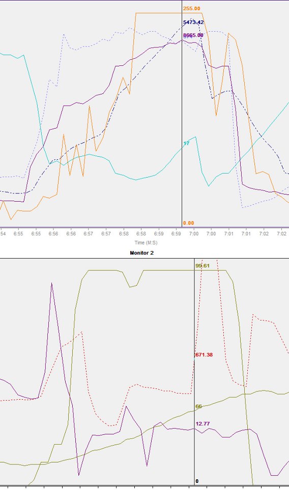

Hi Everyone,
Have another small code update, First release is VS V6 N/A which is available now, as i have been testing it for a good month or more on my own car and a few others, all models will end up with these being added, these are the new features.
B10 & A5 inputs enabled on non Flash PCM's
Knock Active Loop Monitoring
These new inputs can be used for any 0-5volt input, MAP, Wideband, temp sensor etc, the same as we have been using the injector monitor line for, though instead of 0-60 count range these have 0-255. Obviously the injector monitor line can be still used giving 3 available inputs.
Knock Active Loop monitoring is a rolling counter from 0-255, every time the knock code is run the number will increase by 1, by default if the code is run 2 times consecutively and knock is still present or increasing on the 3rd loop timing will start to be taken out, given ignore/addon time has runout.
This is a handy feature for a few reasons, being able to see valvetrain or other vibration noise preventing spark advance increase, seeing knock present but not receiving a knock active bitmask, tuning for Maximum Brake Torque without a dyno.
I have confirmed by testing this on a car tuned on the dyno for MBT, the knock active loops were minimal after doing another dyno run.
Hopefully the below shows what it can be used for.
See below for example of knock noise, always showed up at ~2000rpm, no timing taken out, fitting knock socks alleviated this problem. Following 2 before and after Knock loop tuning on my car, didn't have one that was similar with knock loops for before, even given the change in ambient air temp will give some flow gains but retuning the whole spark curve via knock loop you can see the rolling gains throughout the rev range. Sorry if the images are to big. rather it large for detail.
