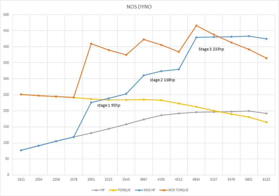

haha jayme still making pretty graphs with excell
- Posts: 2585
- Location: North Coast, NSW
Re: VS Commodore 202 Drag Car :)
yep, here is the one I made to show the torque hit nos gives and how a staged approach keeps you from having a 650nm of torque hit all at once
so for those not familiar with the motor in this car, its my old 202 from the gemini before i went turbo .... and the graph is based off the dyno print out i have of the motor when it was in the gemini, it made 200hp at the wheels naturally aspirated on methanol..... now the VS is heavier but has the same gearbox and diff ratio and up until a few days it had the same converter .... lol! only difference is heavier car and larger height slicks.
so Jayme has graphed that dyno print out into excel (as best as we could from the dyno graph and drag racing logs etc) and then added the nitrous hits to it to show how it changes everything.... obviously the numbers are rough calculations ... weather the actual numbers match or not doesn't really matter, it gives a fairly good idea of where its all heading!

Nice chart Jayme, good way to see what is going on.
The graph makes me ask how viable is it for an 808 to control the giggle gas flow and add the required enrichment so as to have variable horsepower without the steps in torque. Less stress on drivetrain too.
yeah made me think of the ultimate nos system... it would be a separately controlled gas injector injecting nitrous using the same pulse frequency as a normal fuel injector but a separately variable duty cycle to give you a controlled variance in flow over the rev range to produce even horsepower increase.
yeah i have looked at ebay and online options for staging it and while they do allow more control they are alot dearer than two relays
