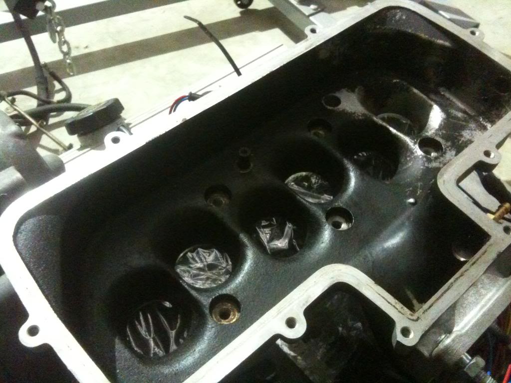

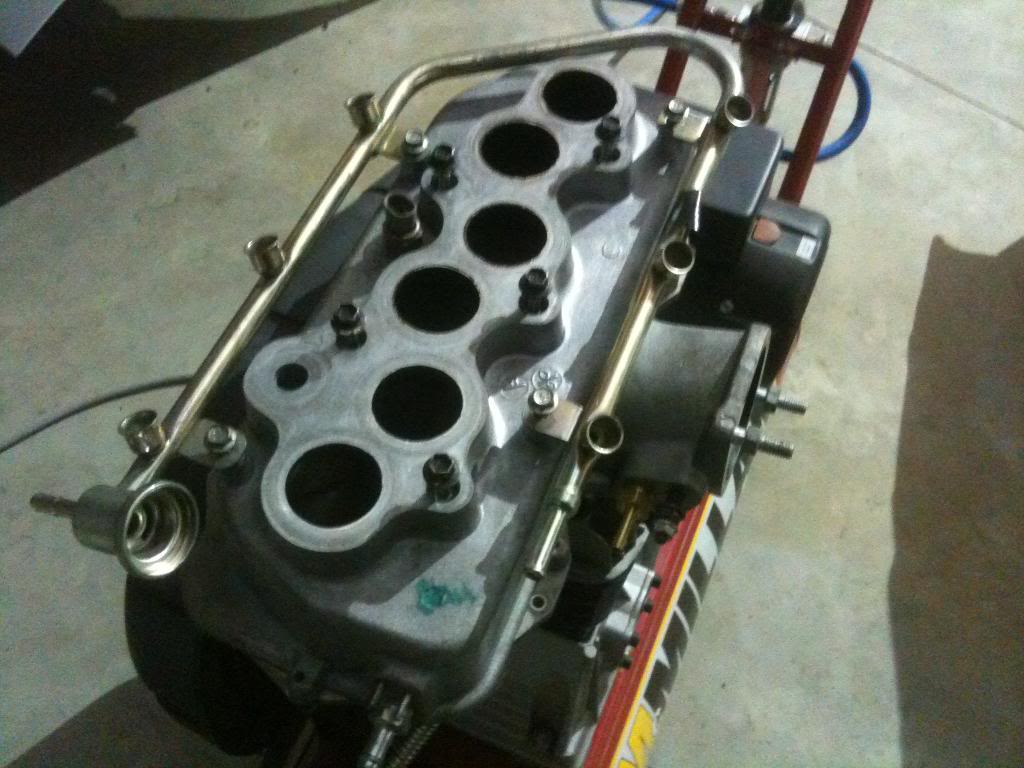

got my manifold from the engineer, been ready for over over 2 months, work got in the way of picking it up. but none the less I got it. Can you see what I got done?

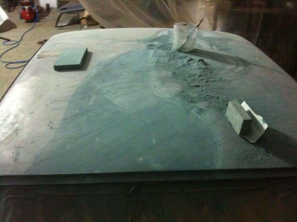

On other news, have got dibbs on a VN with T5 that is in excellent condition, no need for rebuilding. Its going straight in as is.
Another VP body along with the VN as a deal and that will serve as sheet metal as I need it, doors are perfect so I might just use them and wash off the factory paint with acetone instead of dealing with this 2 pak crap I am currently having to hand sand off before washing the factory paint underneath, which is a massive time consuming task.

Re: Vlad's VP executive (full restro)
it looks like theres a MAT sensor in it that normally isn't there!
- Posts: 8124
yeah thats where I finally decided on the location, somewhere out of the way, cabling would seamlessly fit in to the rest of the loom and airflow/turbulence for more faster acclimatisation of the sensor to air temp changes. I didn't want to put in where there was dead air.
with the carbon and oil inside you could see where and how the air flowed inside the plenum so that helped me choose this spot.

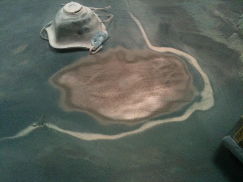

this area was full O' bog and crap and what look like dent the size of a grain of rice lol. filed the surface with a large file and it reviled the dent to be only a 10th of a mm or less deep and few mm in diameter.
???? why the 10 tubs of bog?
The whole roof got washed tonight with acetone and all the paint is gone now, pics will come later when i have a chance.
cause some people have NFI about fixing panels!
hasnt got the usual wave in the bonnet that the vn and vp get they might have tried to fill the sink in the panel
- Posts: 8124
no this is the roof, the bonnet had 5mm bog over the whole lot, that got scrapped anyway.
