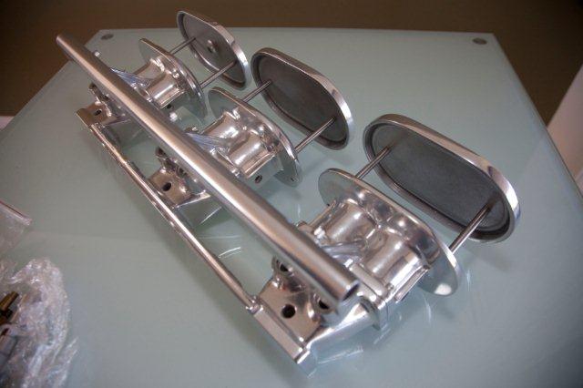

This is the manifold in question.
The holes for vac can be seen, so if i do this 1/2 inch tube idea and until shows on map, that is right length for use to map or then the tank is fitted to the vac tube then the map?

Re: How to convert a 202 to Delco
looking at that i would go out the first hole with 1/2 inch or maybe 10mm into a 90* bend straight to the next location in same size fit a tee then to next another tee and off to map sensor
