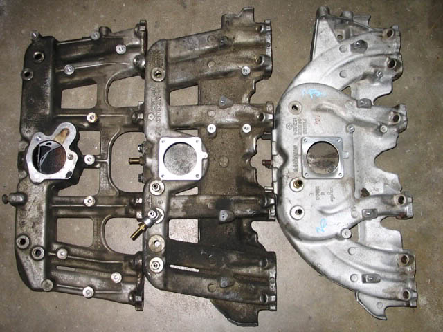

The manifold in the middle is what is fitted to the Jeep, it's a horrible design, the one on the right is a better unit from the 1999 & later.

Re: Delco Jeep
Wow! such a design :wtf:
I think that would be why its behaving the way it is. Looking at that , it would only work well at very low rpm and nowhere else.
the plenum is virtually non existent, and those turns! holy crap!
can you use the one on the right? that would work semi alright.

They do fit & supposedly have better low end torque, just got to find one at the right price.
