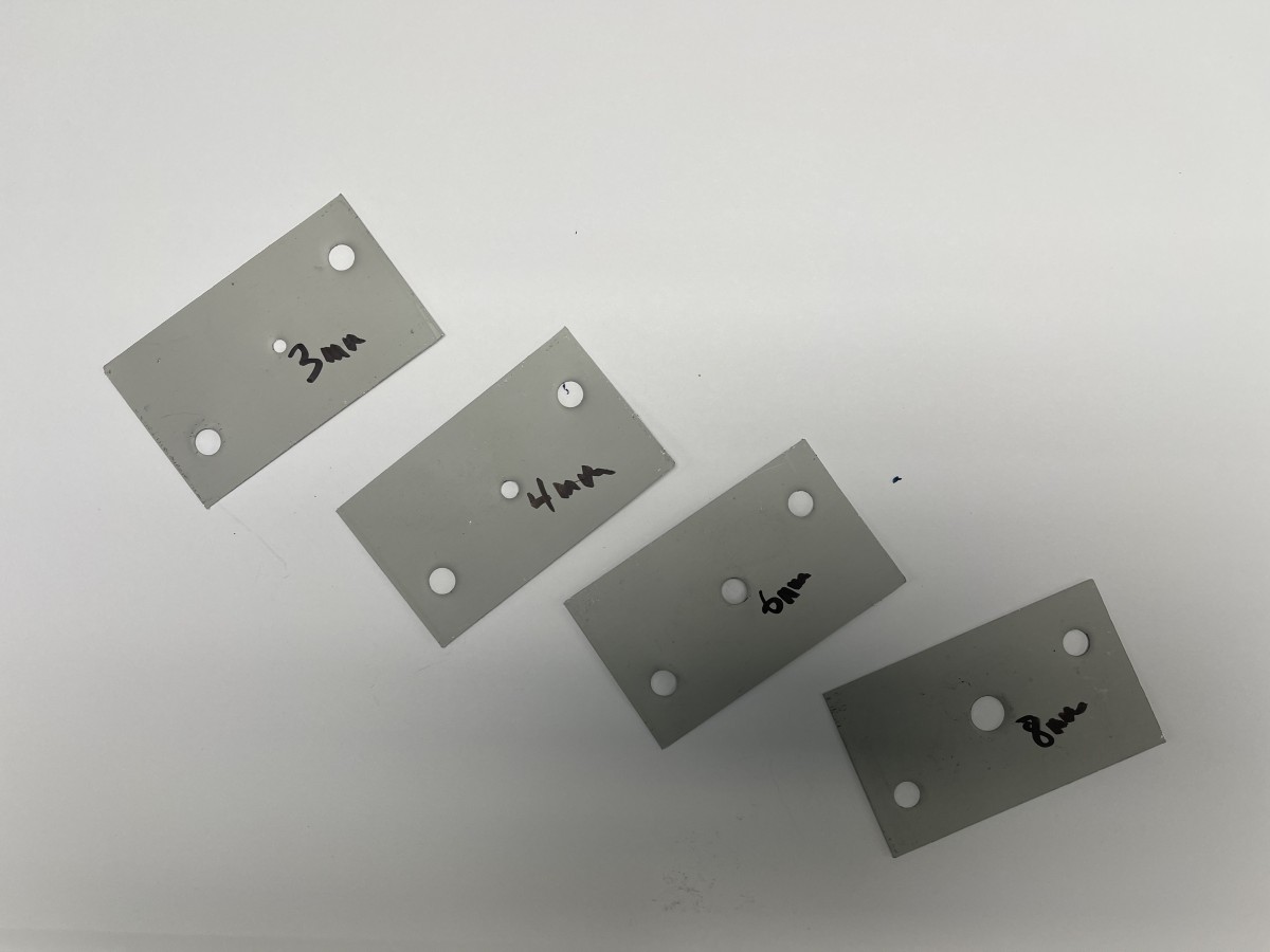

I’m starting to understand. What I’m trying to do is make the IAC air movements less aggressive and minimal while allowing the TB to hold majority of the idle. I don’t actually know if my throttle stop was actually set correct to start with as it’s a XF Ford one that was missing the butterfly.'quipt4it wrote:One reason is that this mode fixes the timing at 10 degrees (or whatever the distributor is set to).Nzer wrote:Why does it idle well in Diagnostic mode?

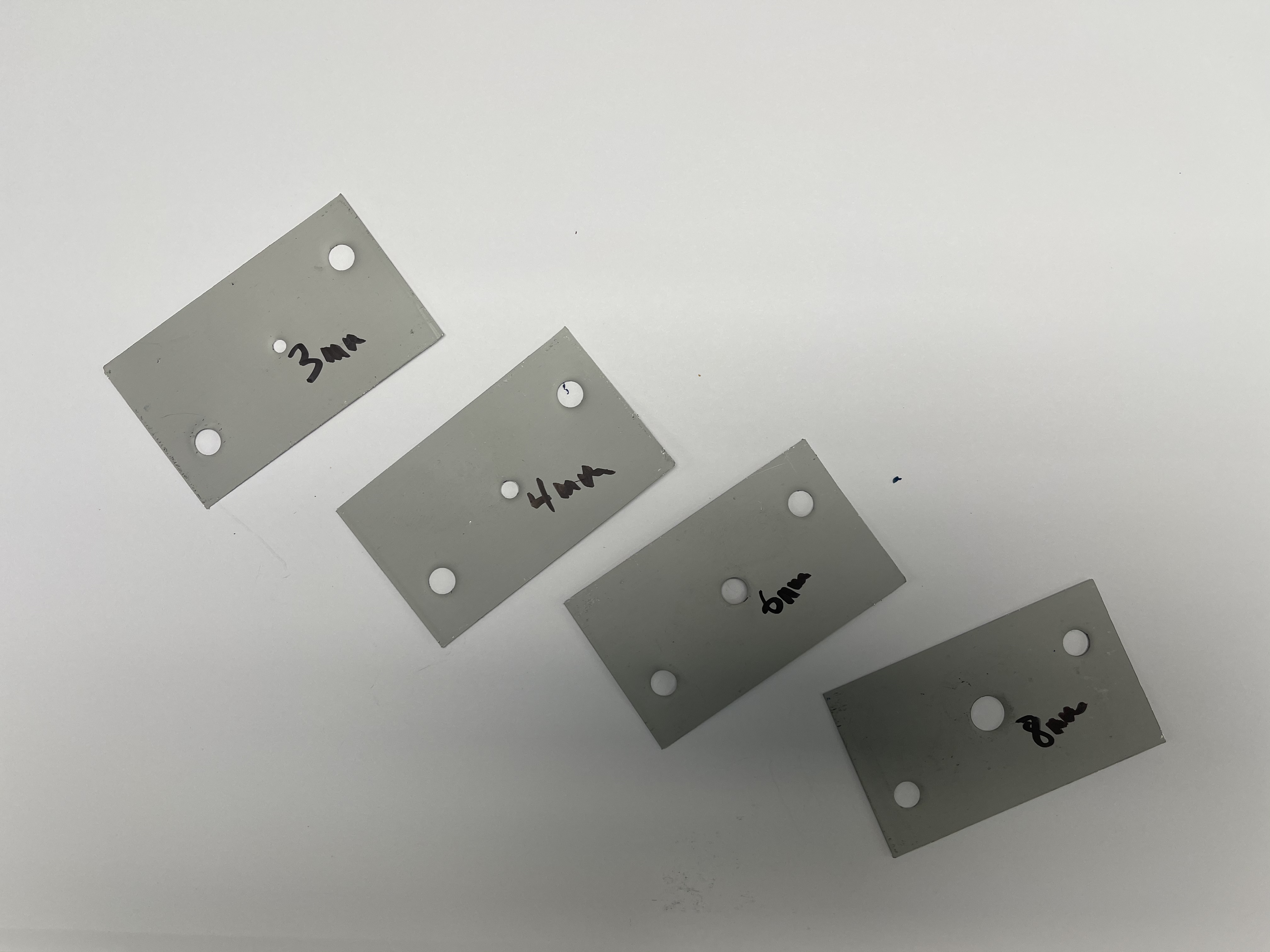

What I’ve made this morning. Unfortunately I don’t have a 5mm hole punch. Hope one will work.

What you are trying to achieve is just the right amount of input from the IAC. Since you have several plates, I would start with the 3mm.

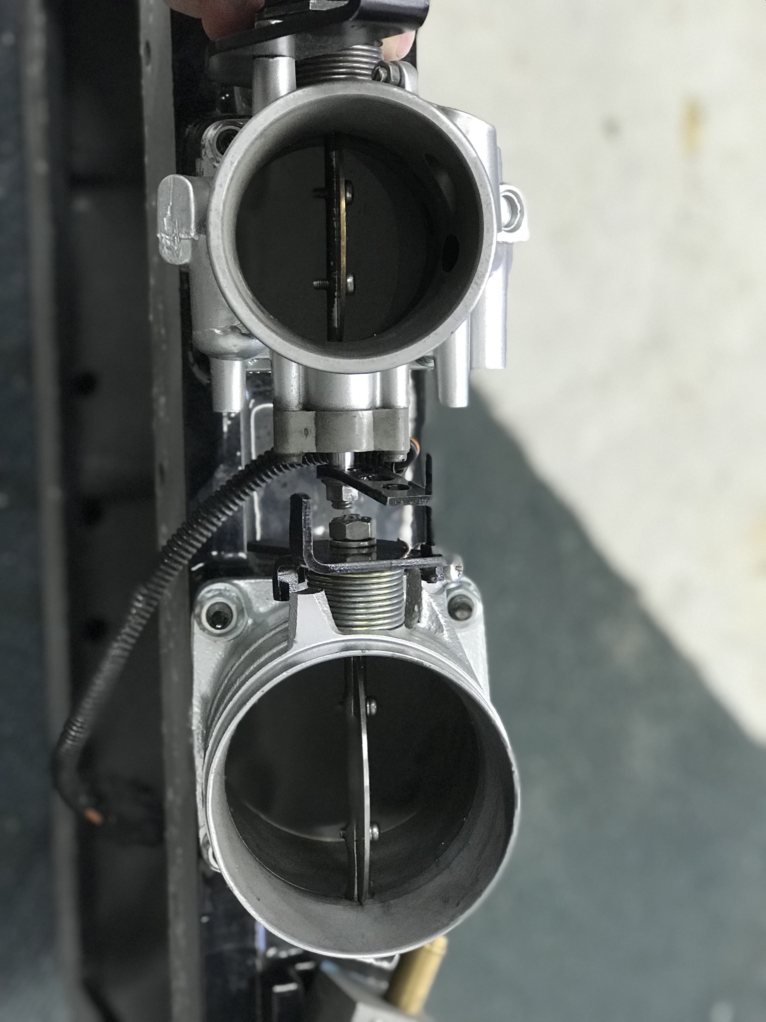

If it's not too much trouble, take a pic of the T/body plate and bore, and maybe one of the IAC

Primary throttle? By plate do you mean the mounting face or the butterfly?'quipt4it wrote:Exactly
Minimise the input from the IAC, which looks too much anyways, and get the balance from the T/body.
'quipt4it
- Posts: 675
Re: VL Walkinshaw High Idle Issue
Primary, yes. Try and get one peering into the T/body from both ends.

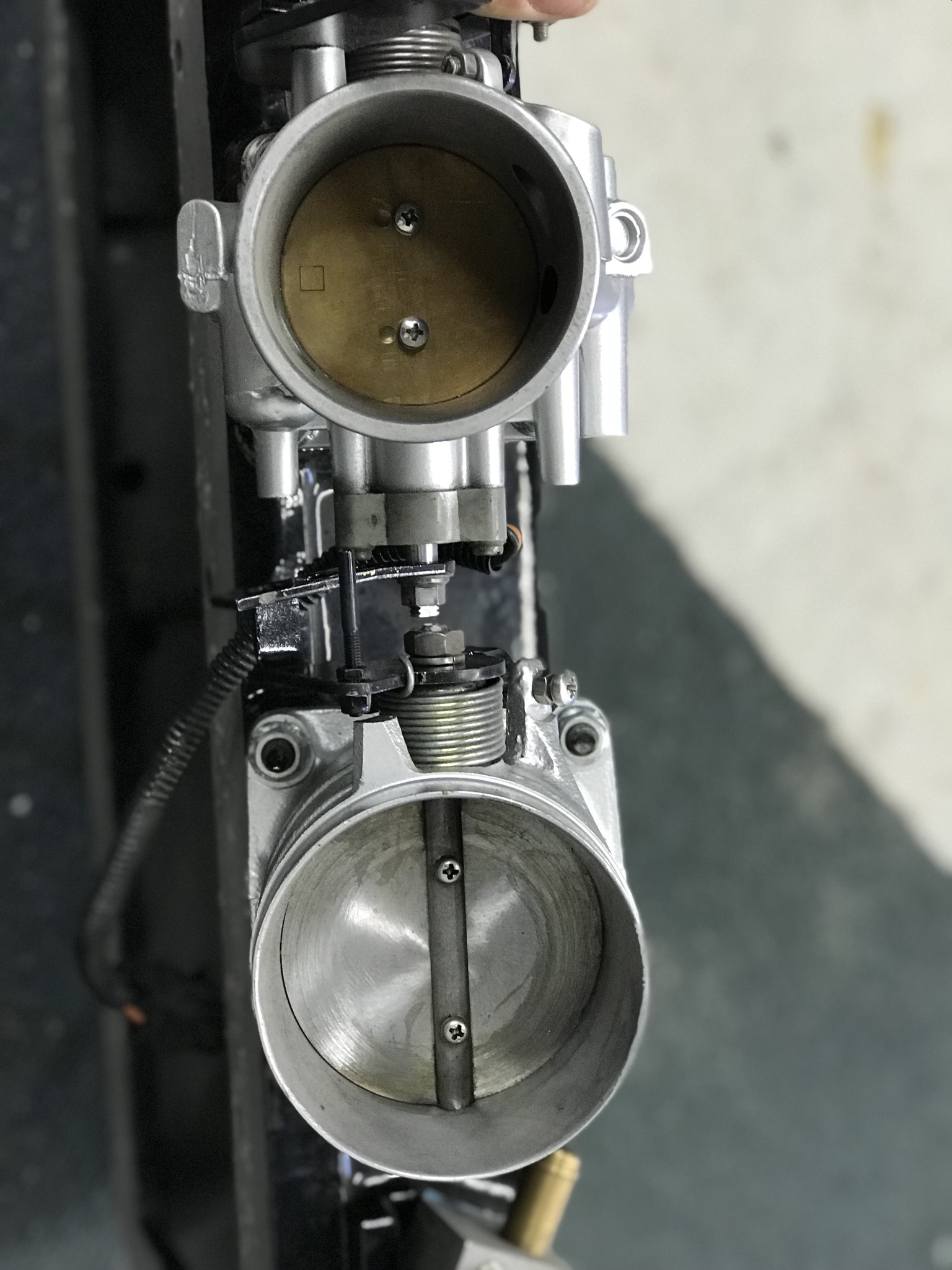

I haven’t got a photo from the backside. Didn’t reeeeealy want to pull it off again.'quipt4it wrote:Primary, yes. Try and get one peering into the T/body from both ends.

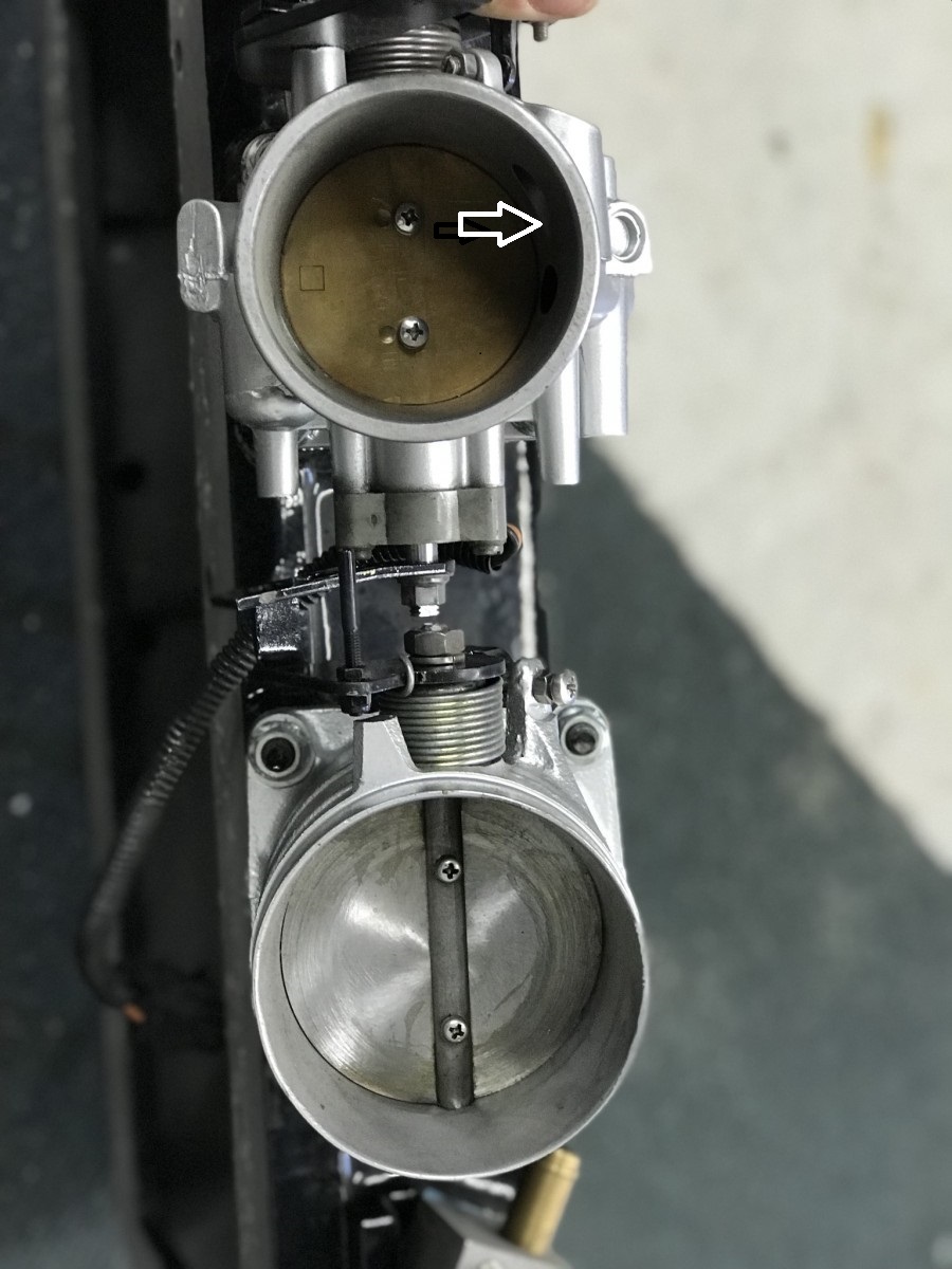

If you look at the attached photo with the arrow, there is a port.
It starts on the atmospheric side of the blade, does it connect to the underside (vacuum side) of the blade?

It’s blocked off for the walkinshaw but for the XF it’s a bleed screw.'quipt4it wrote:If you look at the attached photo with the arrow, there is a port.
