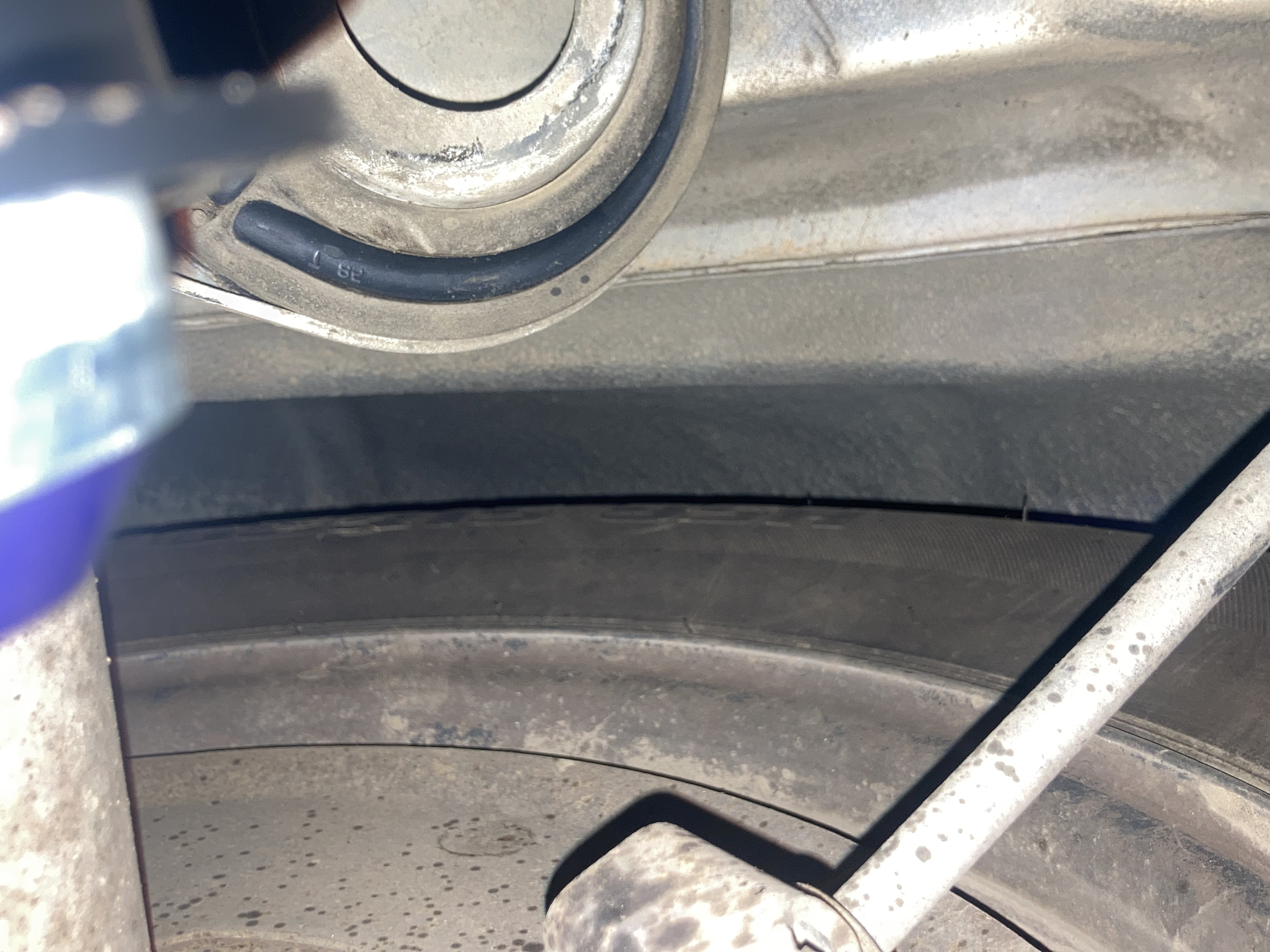

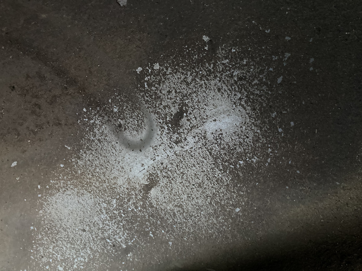

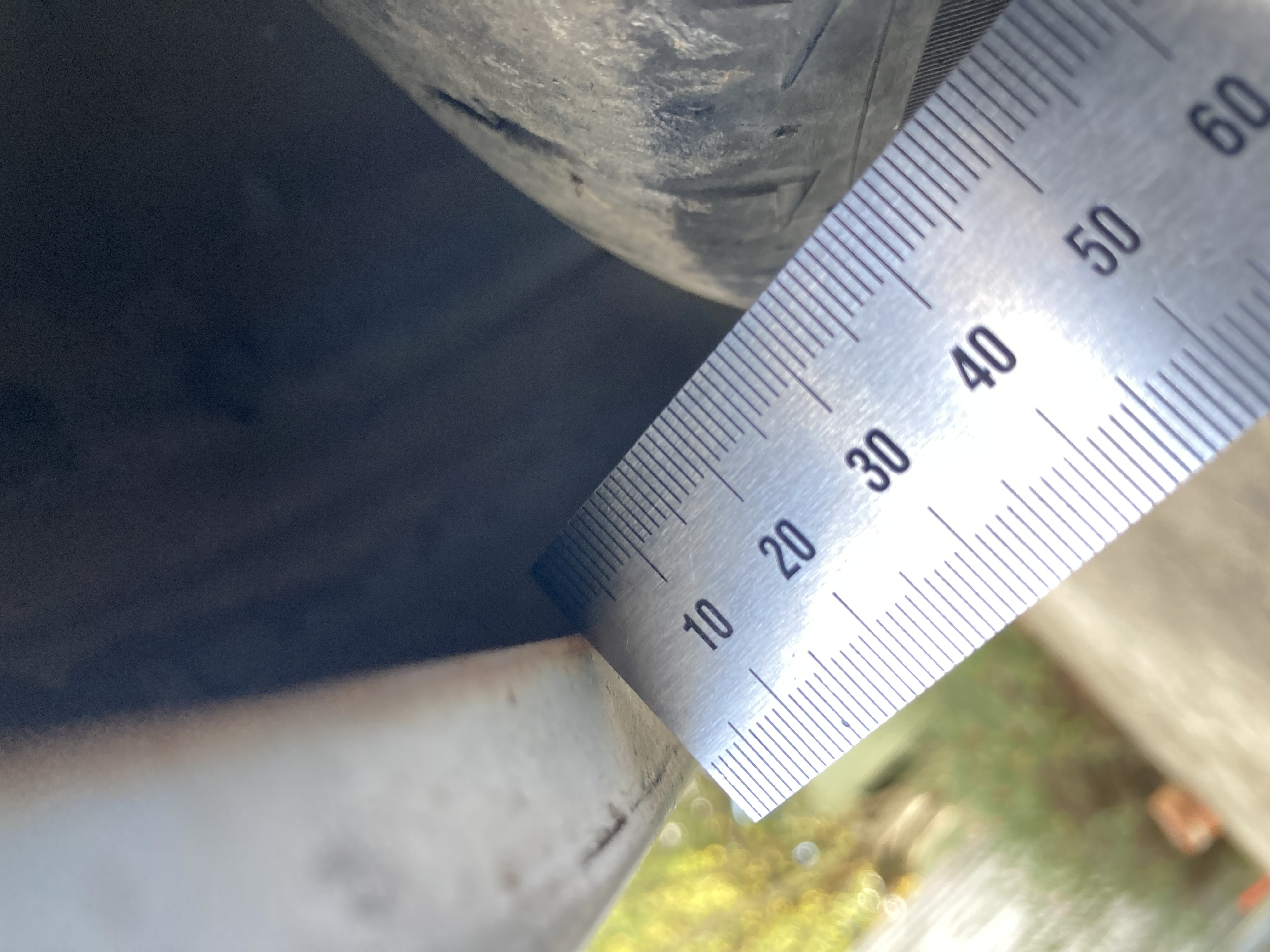

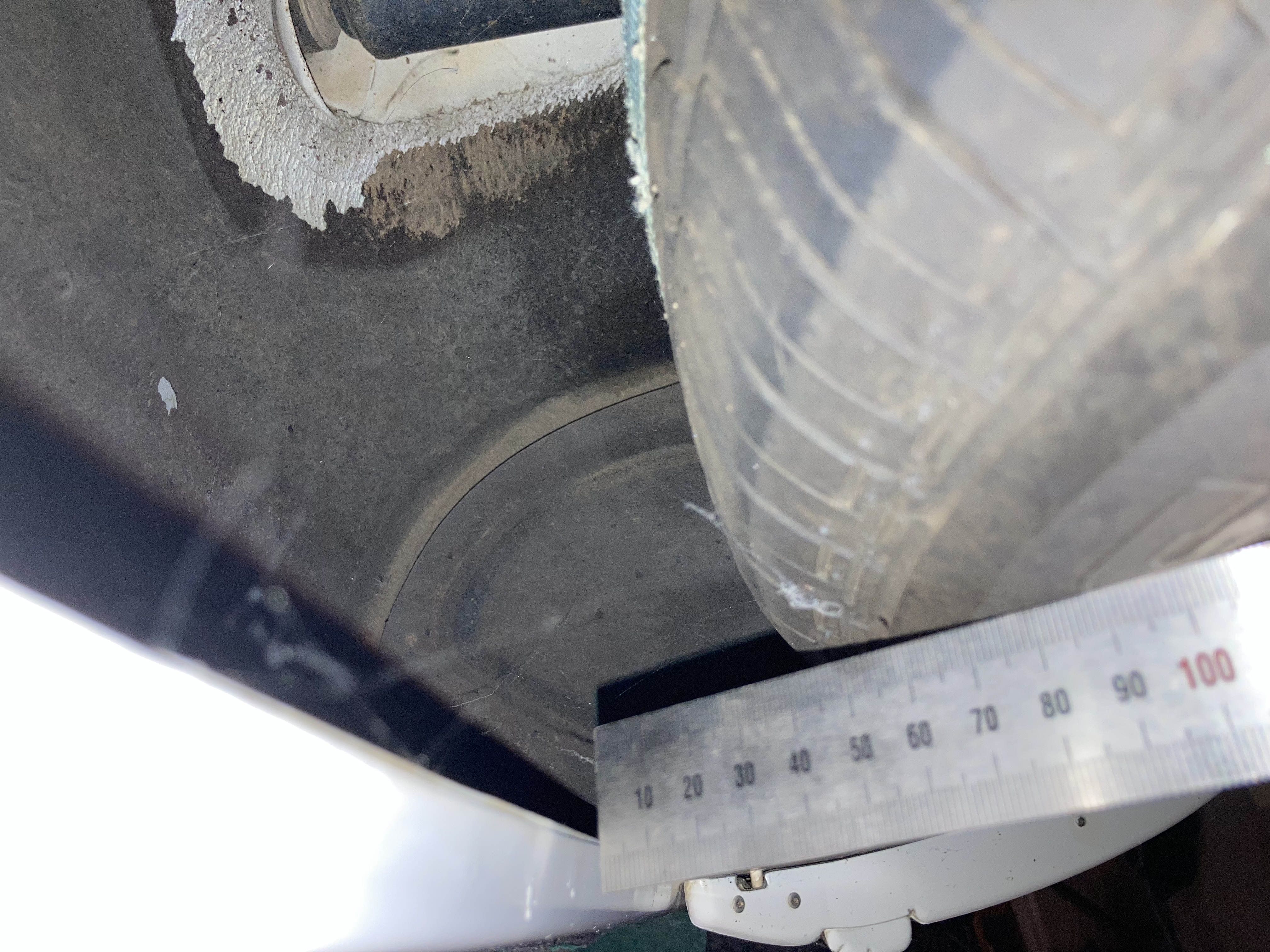

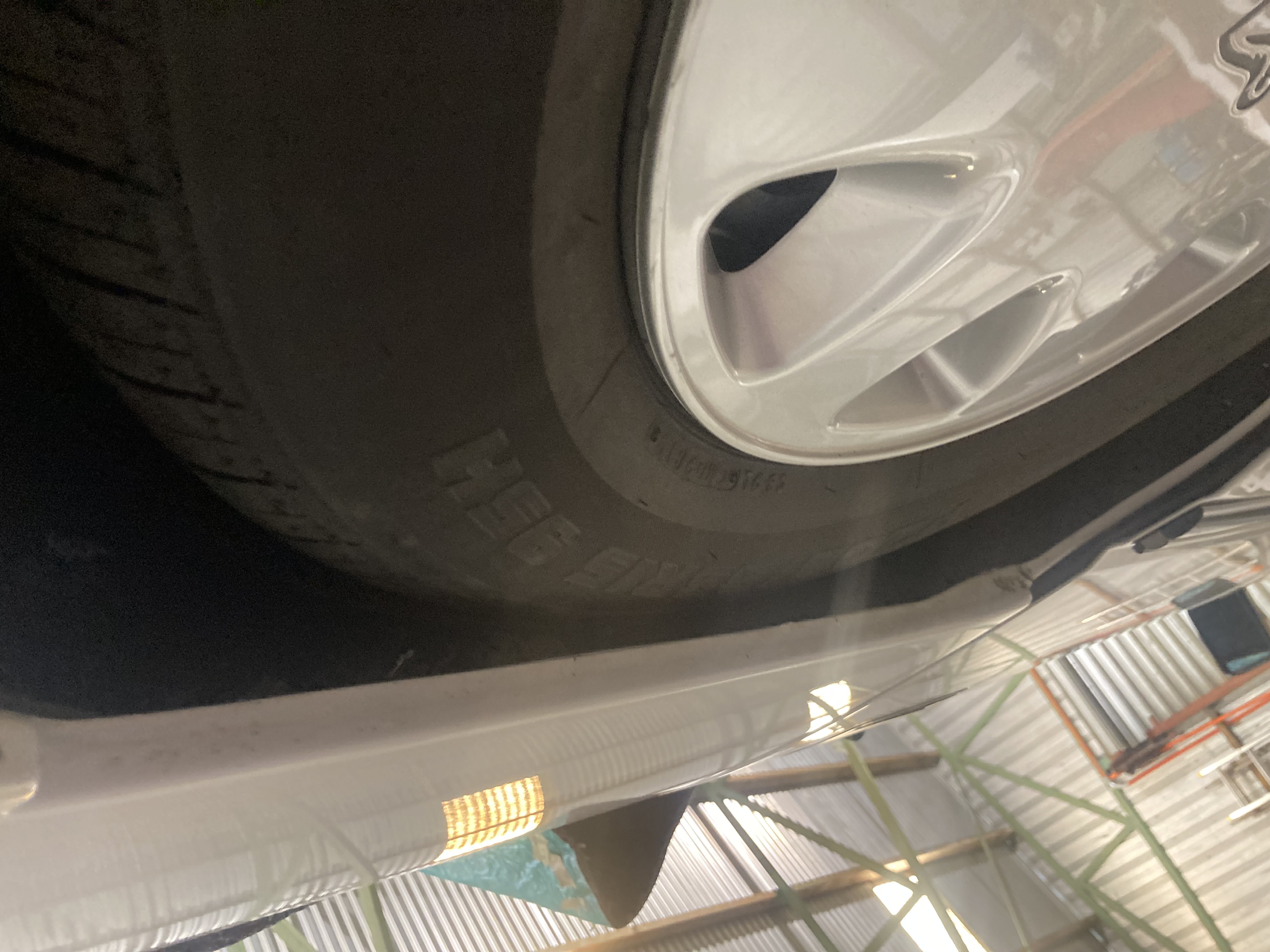

Posts: 8600
Re: VR Ute

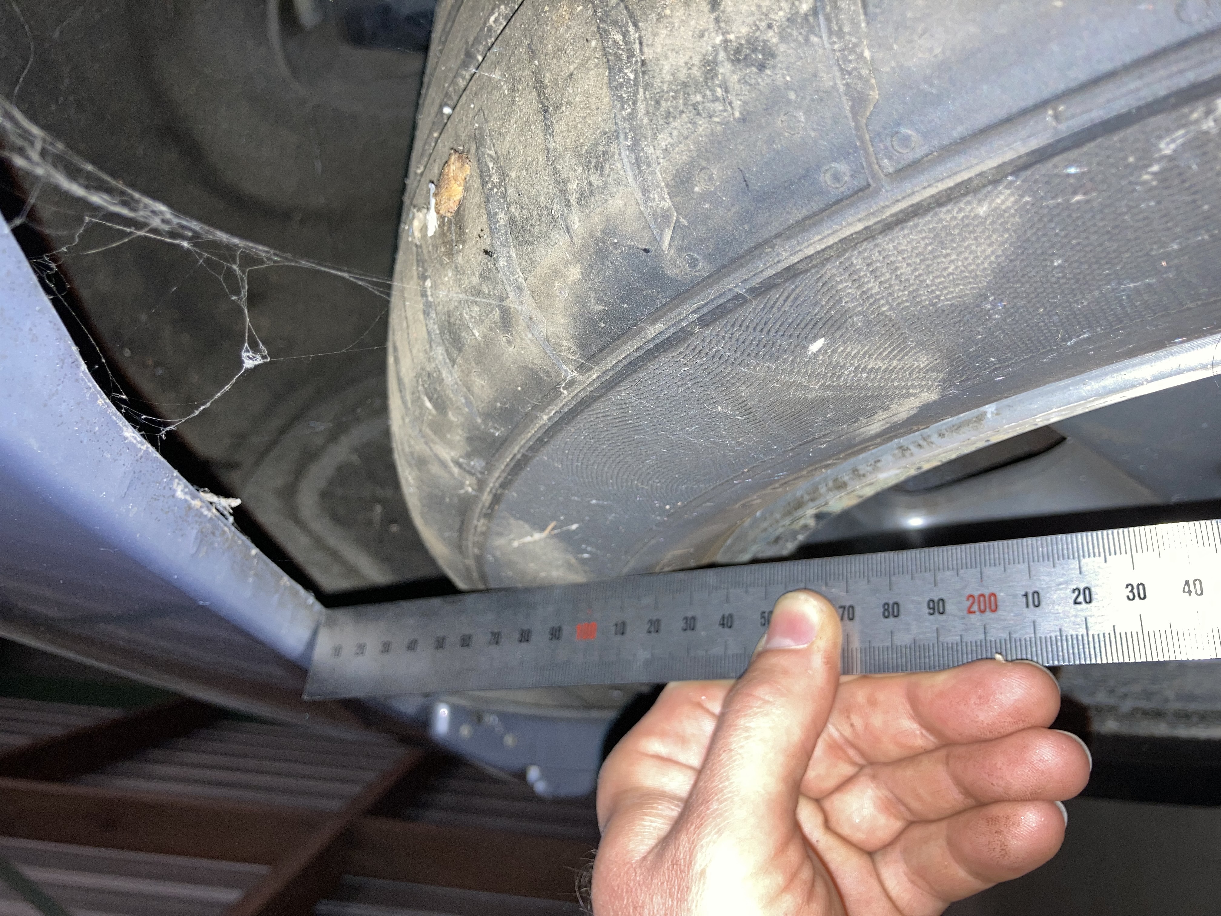

This one is factory stock and the stock 205.
Normal height.
Fully travel, pretty close to the inner arch, but the outer is ample.
The current shitbox with 215s with the same offset as the HSV wheels common at the time, +37
about 7mm outer and can rub on the inner on hard corners when the axle angles get steep.
225 rubbed both inside and out.
The VP S with walkies. 215 and the same +37 offset.
But this tyre was half down so the axle was on a slight angle, that was enough to have an apparent zero clearance, but in reality, it would possibly rub when this angle is maintained under compression. ie.. cornering into a dip or cornering under a heavy rear load. Since the shitbox rarely does it now with 215 but has occasional evidence of tiny amounts of rub (silent), 205 should make it impossible, but it still looks tight either way.
