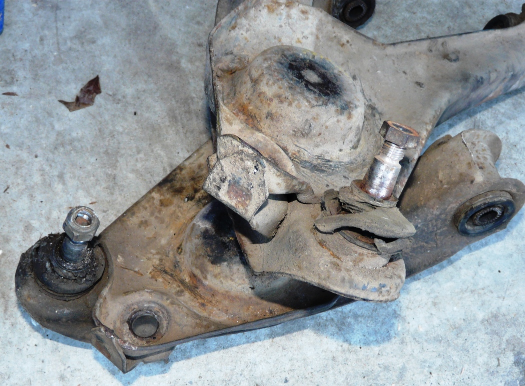

so before the last outing in this thing I found out I have some not so health ball joints and tie rod ends, so I decided to remedy these issues!
also found some cracks around where the lower ball joint goes in so gave that a weld up while it was out!
its slowly coming back together, I got sent the wrong rack boots so holding off on that till they arrive... but the ball joints are all done and its going back together.....
I also want to get some longer front studs while the hubs are off

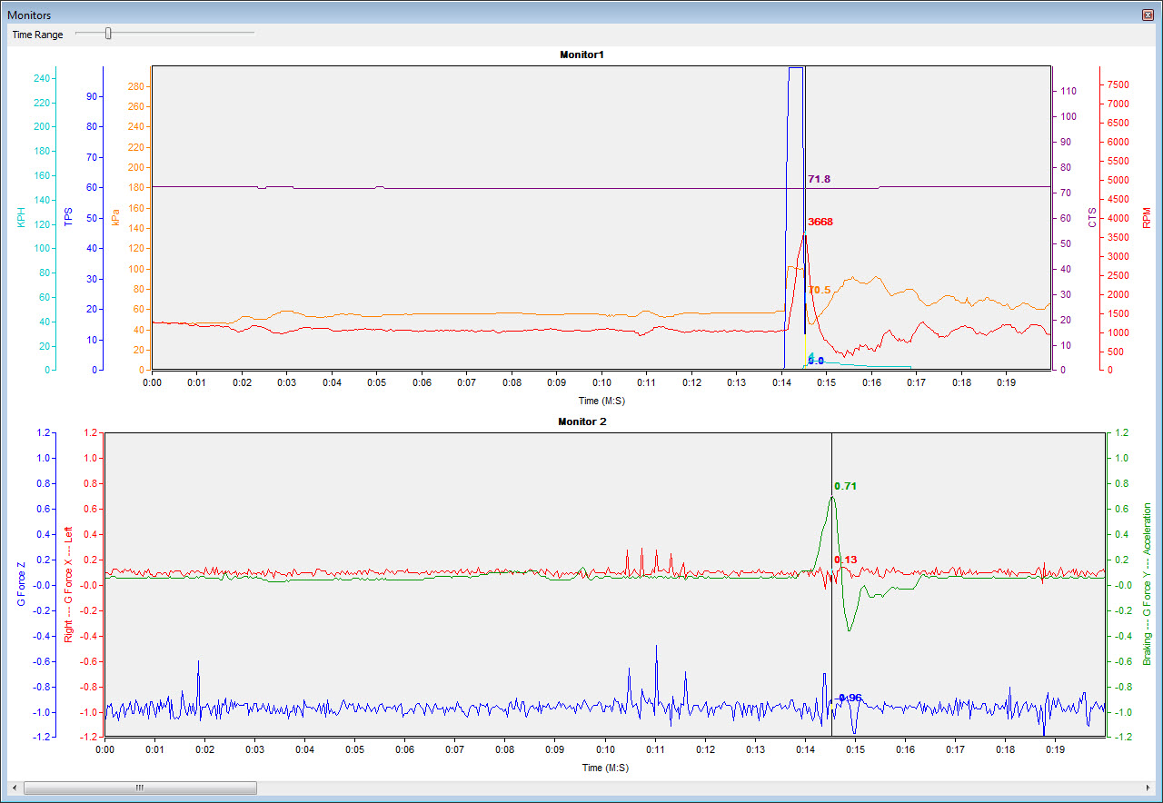

so I've added an accelerometer to my data logger, and got the logger all flat and solid mounted to the floor of the car, and hoping to get some good data from it leaving the line
below is a test I did in the shed stabbing the throttle to see that the g force axis were reading.....
not sure why my readings are so jumpy compared to VL400's, can only assume its the solid mounted engine with lumpy cam compared to his smooth as silk Lexus V8
I've also added in the Z axis which VL400 didn't connect in his, not sure how much use it will be and im not sure the axis is reading correctly at the moment, but time will tell! I guess it should tell if the car is lifting or dropping in the front end ?

Re: My Delcoed Rides
Jack up each end and side of the car and see what happens with the accelerometer. Should give you a clue.
Simon
Simon
