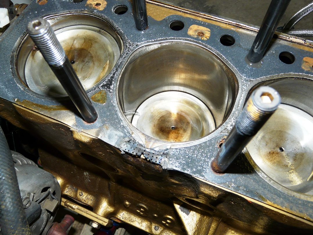

Commiserations. Did the valve touch the top of the block or down the bore?
Re: My Delcoed Rides
well technically both hehe ?!?!?!
this is an old pic, but shows the chamfers i put in the bore to clear the valves, it hit in the middle of that area...... the question is, did it hit because the lifter failed and pushed the valve open more than normal or did it fail from the valve hitting in the first place!
i also noticed a very small mark on the top of the piston where the edge of the dish starts, which makes me think the valve has opened more than normal when it failed.

If it only kissed with one valve, I'd have to agree, unless it has a soft spring. What lift does the cam have?
