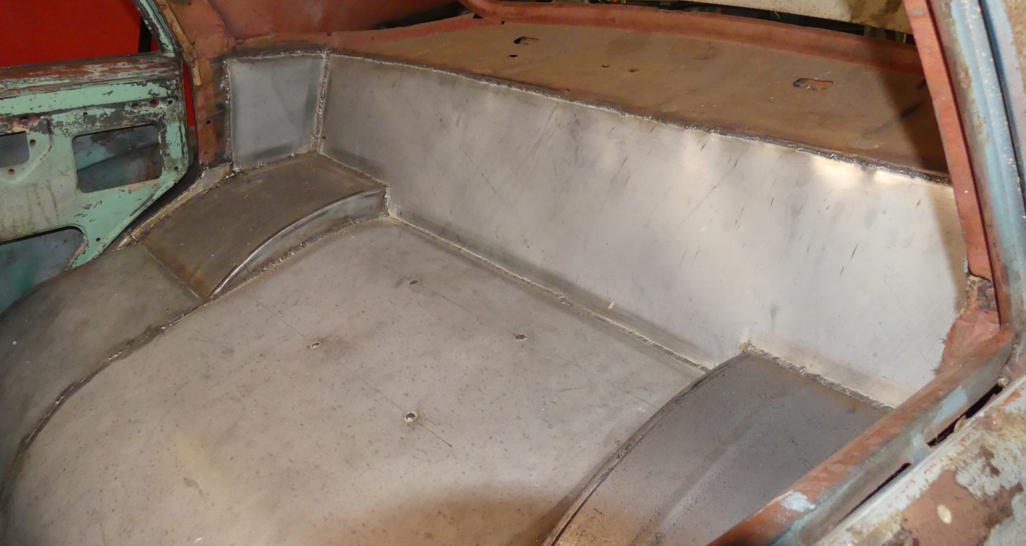

finished off the back seat welding in.

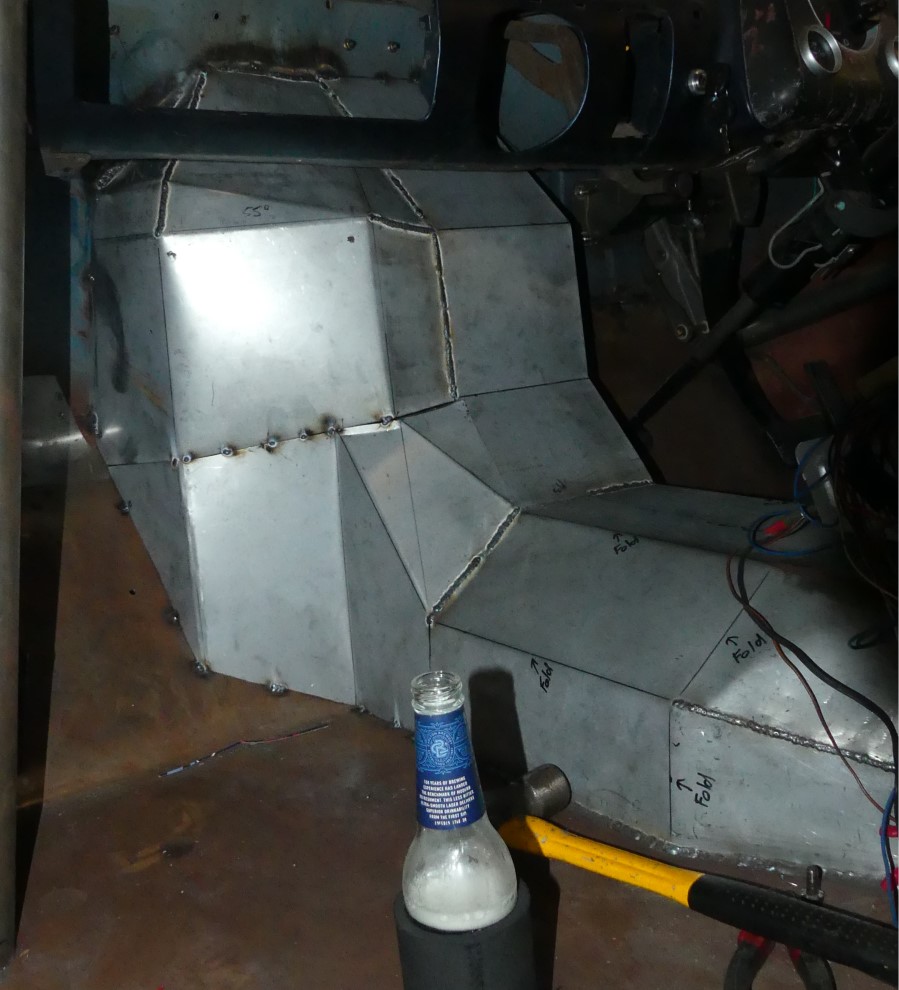

and made a CAD template into a metal one and got it partially welded in, feels like a massive step forward getting that bit done!
it reminds me of that project binky lastest ep where he spend 15hrs or something on the wiper brackets, with making the template and getting to this point above there is probably 8-10 hrs in that section alone!

Your new back seat looks uncomfortable! :lol:
There definitely looks like there is 8-10hrs in that firewall. Nice work mate!

Your firewall and trans tunnel look very well designed. I remember doing this type of cad work when designing ducting etc at uni (wow that was a long time ago) Looks like a piece of origami and is beautiful well done Holden202T :thumbup:

i cant take all the credit, dad and 2 brothers were over on sunday, i was definitely supervising more than working i reckon lol!

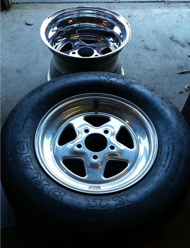

oh how could i forget to mention what finally arrived the other day just in time for the weekend!

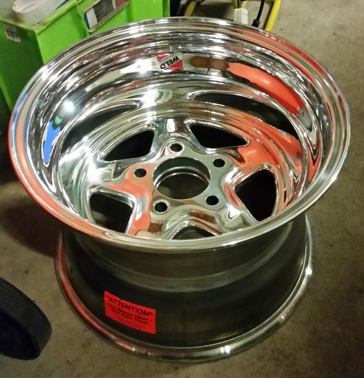

So the new ones are 15 x 10 and the old one is 15 x 7 with a 10 inch slick on it, its also got the same back space, so means 3 inch more dish (as you can see)
The slick sits pretty much the same height as the rim so will just mean it will belly out less which should be good as the contact patch was slightly rounded.
This was the last bit i need other than axles, so once i get the money i will cut down another diff for these rims and fill it with all the goodies i have waiting :)
this will have a massive positive effect on traction, :thumbup:
